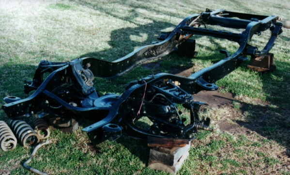

LOTS K5 wheelbase is 106.5" a C/K10 wheelbase is 117.5"
This is a SWB C10:
http://www.captkaoscustoms.com/images/b4blasting2.jpg
This is a '82 K5 2WD: 4x4 will have taller spring perches in back and there will be some in front. The frame rails will be the same though.
http://www.captkaoscustoms.com/image...er2wdframe.jpg

A pickup frame and a Blazer frame are completely different. Pickup frame is longer and in the rear narraower. The only thing that is the "same" is from the front cab mount forward.
