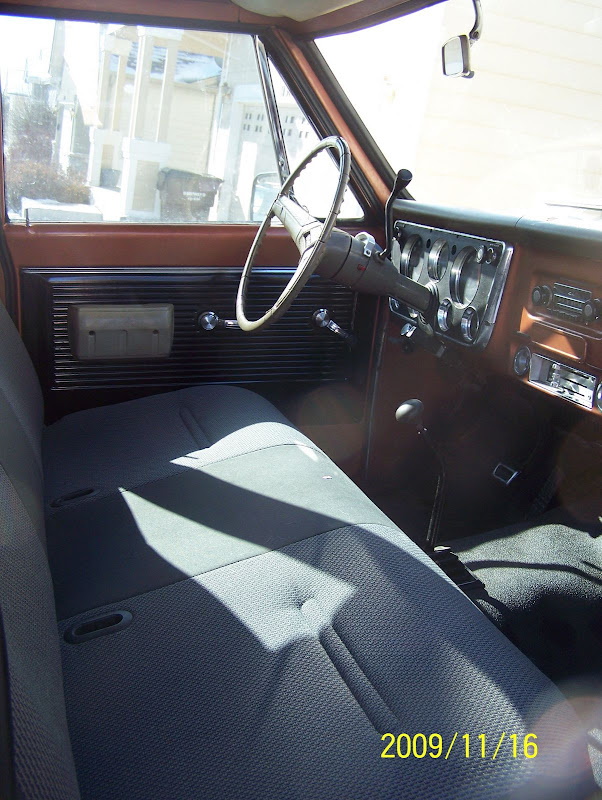

http://lh3.ggpht.com/_Fx4nqL8K_5o/Sw...ont%20seat.JPG
