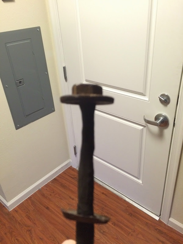

This is an old thread, but I'm having a similar problem.
I went to take out the cab mount bolts, and snapped one. How have people fixed this? Try to drill it out from the bottom?
I've never seen bolts this bad before - this is the one I took out from the front location (where I was able to turn the nut from the bottom, rather than having to turn the bolt):
https://lh3.googleusercontent.com/-l...0/IMG_1786.JPG
NO wonder the next one broke...
