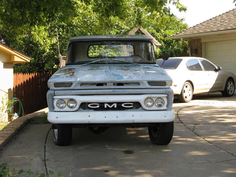

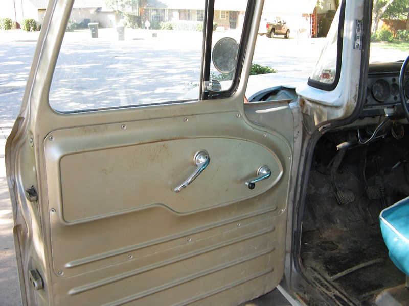

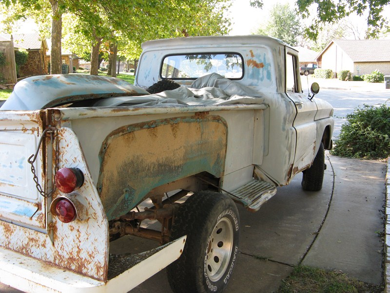

Previous owner said everything was original except for a little mud in the corners and the turn signal, which broke on him and he couldn't find a replacement. It has an alternator too, but I didn't have the heart to tell the old timer that they came with generators. And I don't mind, thought I'd kinda like to have a generator some day.

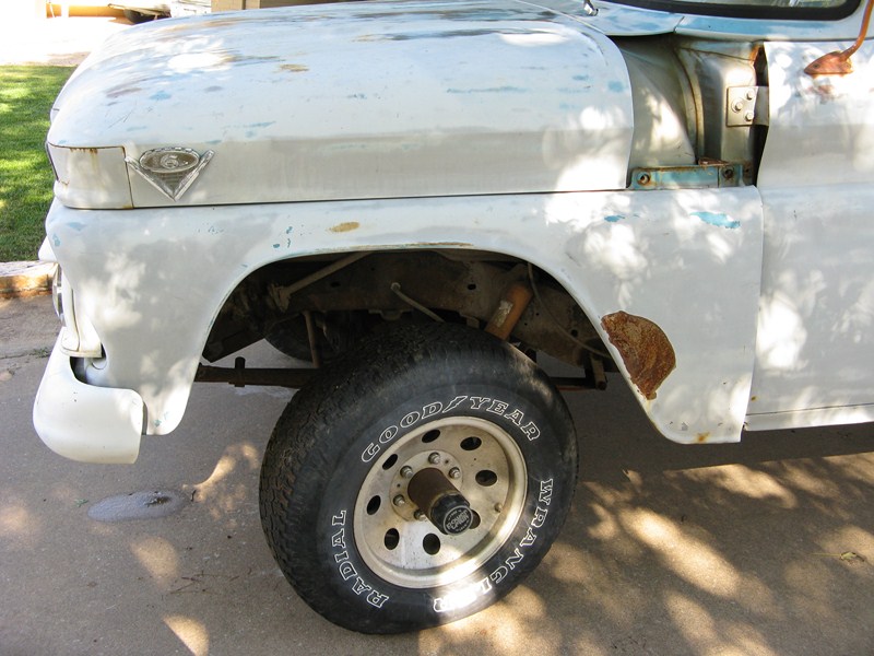

These pix are a bit newer because she has her fenders off. They were removed prior to transport.
I'll have pix of that soon. I like to do "step by step" documentation so it'll kinda be like that i guess.

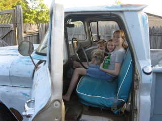

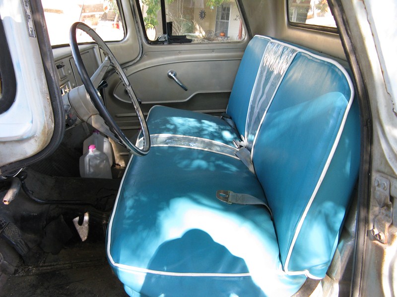

The seat is a style I haven't seen before, though it looks like it has been clipped to the springs since heck was a pup
http://windypix.com/?di=J4NR.jpg
Kids making memories and butt-prints

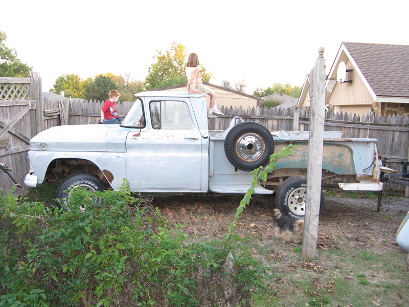

My plan right now is just to get her up and running well. Today was bolting the cowling corner back on, airing the tires and moving her to the backyard so I can work in private. I'd like to paint her back to the original color too but any talk of paint and the kids get all weepy eyed. They're patina fans and I haven't even talked to them about "patinas". They just like the look. We'll see how that goes. I also want to add PS because she's a longstepper and she turns on a half dollar. Whew!
This might end up going anywhere by the time it's over. Flames and a flux capaciter anyone?
http://www.roligaprylar.se/blogg/wp-...-capacitor.jpg
With my hip being what it is my oldest helper volunteered to air all four tires for me so i don't have to get up and down. And she hates getting dirty. She's a peach.
http://windypix.com/?di=BEBF.jpg

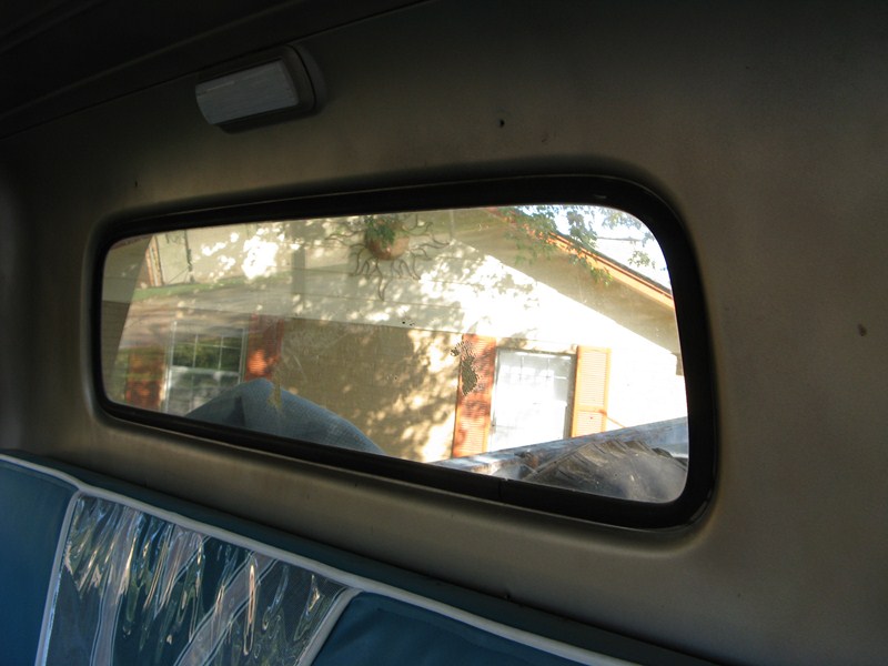

Next weekend I'll replace that passenger window and work on getting the original AM radio with the letters GMC on it running. If you're working on these old trucks and haven't sampled the same music the guys that built it were listening to...well, you're missing out! :metal:

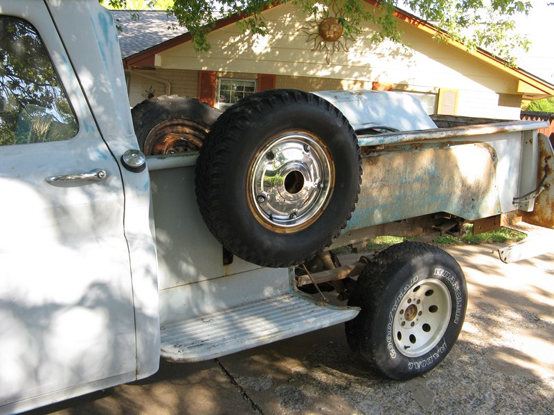

Now if that doesn't make you scratch your head and slap the closest person to you I don't know what will.
We did finally get her running enough to move to the back (shown above) but I ran outta gas midway through the gate. :lol: It's a good thing these great old trucks can bump forward with the starter if necessary. The gas tank was covered by the fence.
5 gallons of pure gas (no ethanol) later and she was running-ish again. At least enough to backed her into her new home.

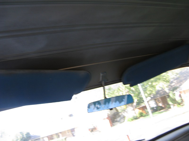

Dual original visors :)

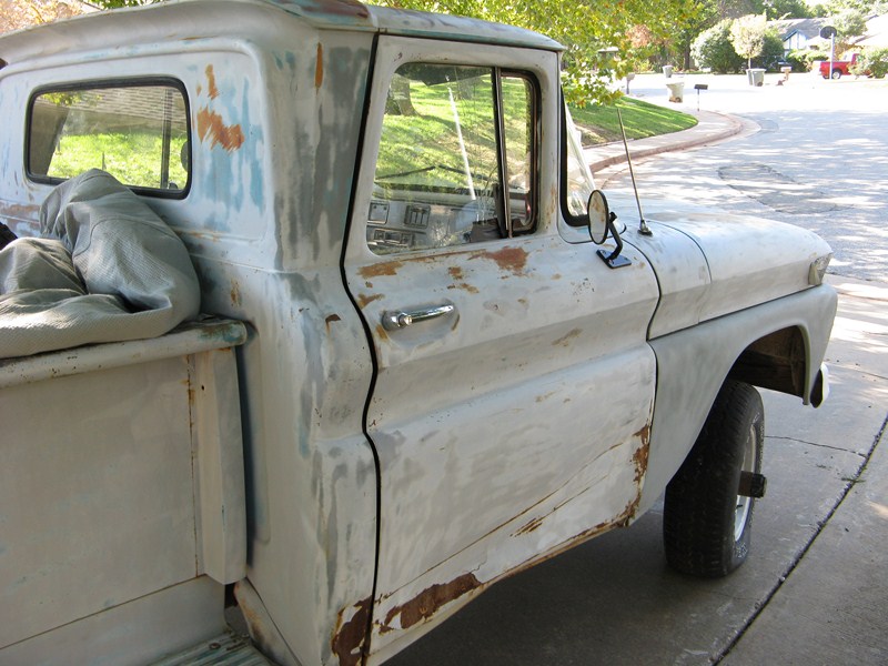

And the damaged pass side. I'm going to bang around on it some, but am not entirely against buying a replacement.
http://windypix.com/?di=VVVW.jpg

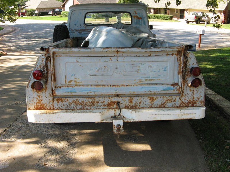

My powder puff mechanic posing with my busted up old tailgate.
http://windypix.com/?dm=LOJG.jpg

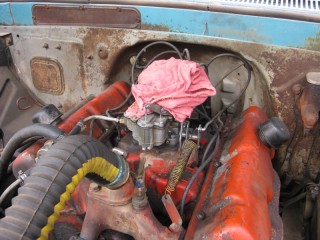

Cecilia's going to be a daily driver one day so the first job on the table is making her more reliable. Right now she runs like a one legged duck on a whack-a-mole table. I started with a carb (carburetor) rebuild. I'm sure it's the wrong thing to do. Most of the things I choose to do are probably wrong. I've learned to live with it :D
My carb is still the original Stromberg WW model. I plan to upgrade to a Holley 4410c 500 CFM eventually, but I want to have everything else running smoothly before that happens. So I bought a GP Sorenson Carb Kit from Autozone for $37.99. The part number is 96-574.
The carb kit does NOT come with a float, in fact the computer told the little guy at Autozone that this carb doesn't need a float. He was like, "Ok, now this computer is just flat out lying to me." Points for the parts guy having a sense of humor :)
I got my kit home and waited until the weekend when I'd have someone watching my youngest and I could draft my main helper for photography duty.
Saturday it was bacon, eggs, biscuits and gravy, pain killers for the hip, and then off to Cecilia with my child number 2 in tow.
For this project I needed:
(sorry for the metric, someone stole my standard wrenches just a week ago. A pox on their house!)
  • 12 MM wrench
  • 13 MM wrench
  • 15 MM wrench
  • Flathead screwdriver
  • Carburetor cleaner or dip (dip preferred! 27.90 @ Autozone)
  • 2 or 3 old towels
  • About 4-6 hours. I did mine over two days and 8 hours to allow the JB Weld to cure.

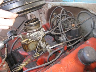

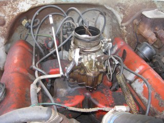

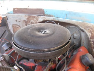

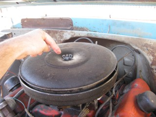

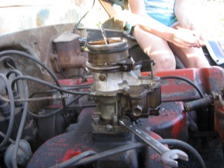

As you can see I have the old style oil bath air cleaner. It'll be cleaned too by the time this is over. Start by removing the wing nut on the top of it.
Click any of these images to see a larger version.
http://windypix.com/?dm=9KIG.jpg

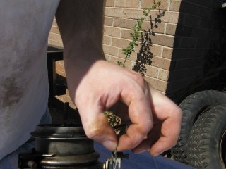

I always just set the nut on top of the air cleaner so I don't lose it. This won't work if you don't put the air cleaner in a safe place though. Watch for gremlins stealing those wingnuts. They're like candy to them.
http://windypix.com/?dm=VPQR.jpg
Then just lift the entire air cleaner away. OOOh, Ahhhh!
http://windypix.com/?dm=IM3Z.jpg

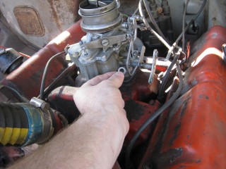

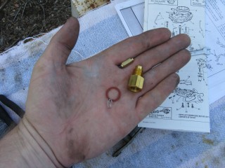

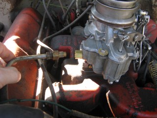

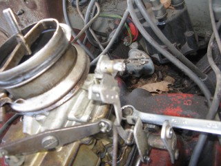

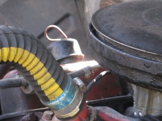

Next we remove the gas line. If your large brass connection isn't very tight then you'll need to use two wrenches to remove the smaller brass fitting, with one holding the large fitting stationary while the small one turns. I'm using a 15mm and a 13mm shown here.
There *could* be a screen in here so be careful. Mind did not have one. Gremlins, I tell you.
http://windypix.com/?dm=5J4F.jpg

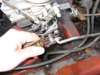

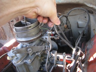

Now unhook the large spring. I don't know all of the official terms for everything so we'll call this the Large Throttle Spring Of Doom. Be careful because it is under tension. Tension is what gives it a hunger for blood.
http://windypix.com/?dm=LCFU.jpg

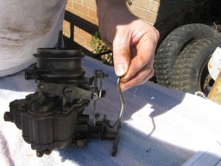

Then pull free the linkage (metal bar) that the Large Throttle Spring Of Doom was hooked into.
http://windypix.com/?dm=C63R.jpg

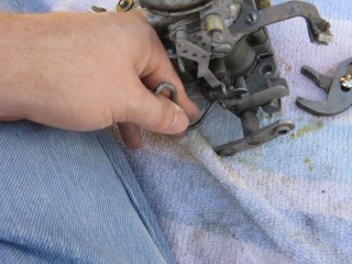

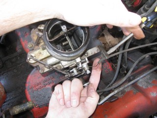

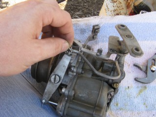

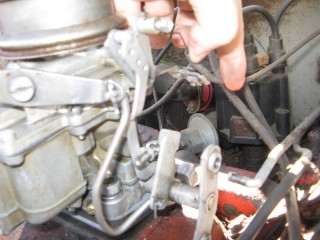

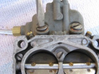

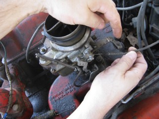

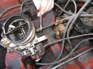

At this point I reached around the back of the carb to remove the brass fitting that runs to the vacuum advance. Here I'm using a 12 open ended wrench.
http://windypix.com/?dm=A1BV.jpg

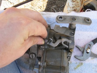

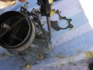

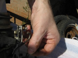

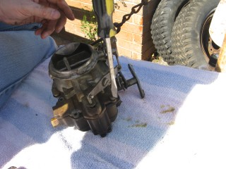

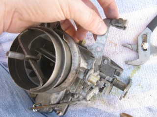

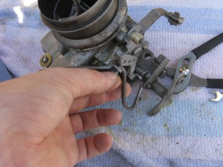

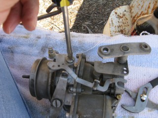

Now come back to the throttle linkage. Unscrew the top screw just a couple of turns. This screw holds the wire that's poked through underneath it. We're just wanting it to let go of the wire, we're not trying to remove the screw.
http://windypix.com/?dm=7D8M.jpg
There's another screw that we need to loosen directly behind the one we just did. There's a nut on the back end of it (indicated by my ugly finger) so don't unscrew it too much or you'll be chasing it down a spark plug hole.
Just unscrew it a couple of turns and disconnect the cable by pulling it out to the side.
http://windypix.com/?dm=VL4U.jpg
Here's me pulling it to the side. I bet you're glad you saw this. You're so well informed.
http://windypix.com/?dm=VIY6.jpg

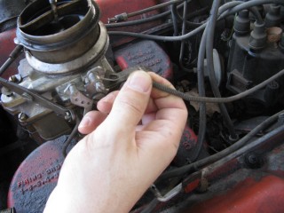

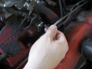

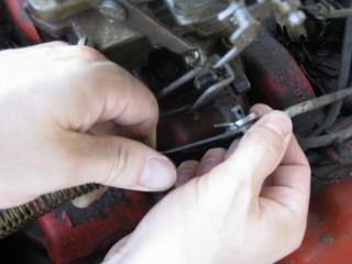

Now pull the little wire free from the top. It MAY be bent around to help hold it in place. If so just unbend it. It doesn't need to be bent if your screw is tightened properly anyway. Leave it straight. Straight is how God intended.
http://windypix.com/?dm=IES9.jpg
Congrats! At this point we've removed all of the "stuff" hooked to the carburetor! Pat yourself on the back - well, no. Your hand is filthy. What's wrong with you? Born in a barn? Ask someone else to pat you on the back. That will also give you the opportunity to tell them how manly and tough you are for making it this far.
Ohhh Yeahhh!!
http://windypix.com/?di=7IYO.jpg

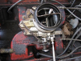

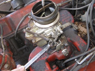

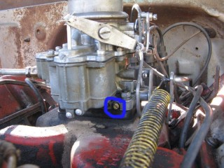

Ok, back to work, Superman. You've only got four nuts left and you're in the clear!

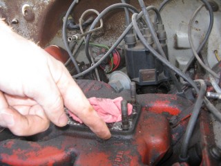

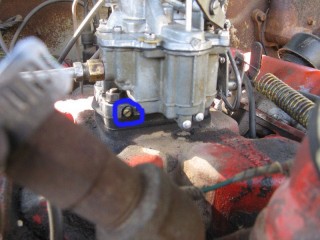

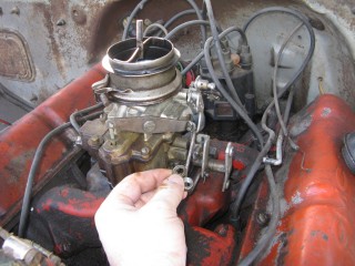

I'm using a 15mm wrench to remove these. DO NOT DROP THE NUTS. They're very difficult to fish out of the spark plug holes. Where Gremlins live. And they bite.
Remove the nut located here:
http://windypix.com/?dm=S95W.jpg
And here (don't mind my Photographer in the background):
http://windypix.com/?dm=4L7Q.jpg
Then here:
http://windypix.com/?dm=75DT.jpg
And finally here, under all that spaghetti we just took loose.
http://windypix.com/?dm=N5VN.jpg

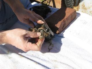

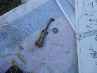

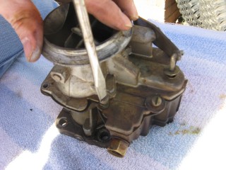

My carb had lock washers, but only on the front two bolts. Again, do NOT DROP THESE or you'll have a heck of a time fishing for them in spark plug holes. Don't believe me? Go ahead Mr. Know it all. Drop one. I double DOG dare ya!
http://windypix.com/?dm=4ON5.jpg

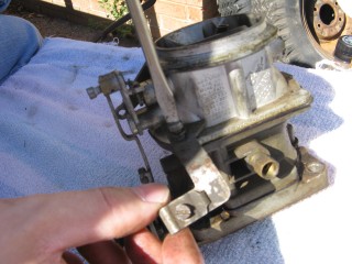

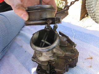

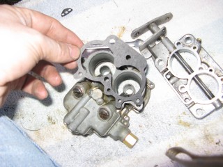

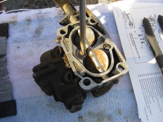

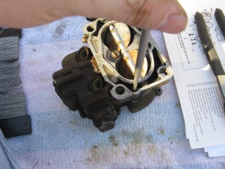

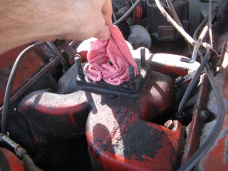

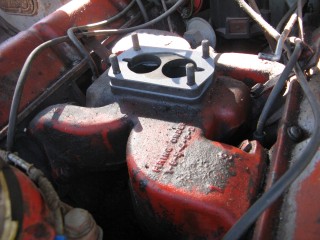

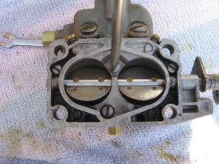

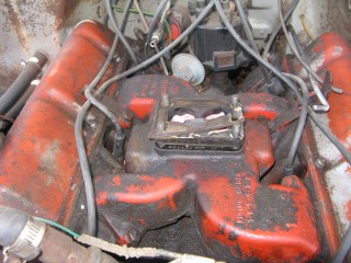

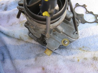

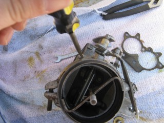

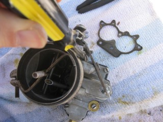

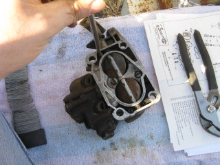

Now just lift the entire carb up and off!
You'll be left with this.
http://windypix.com/?dm=FLUR.jpg
Eww. That's anticlimactic.

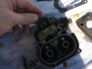

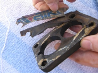

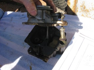

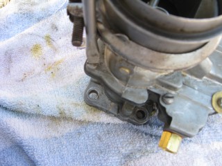

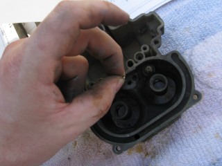

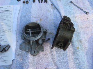

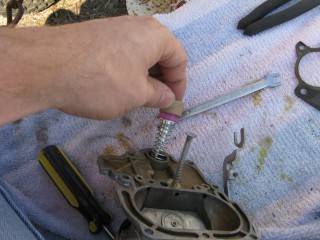

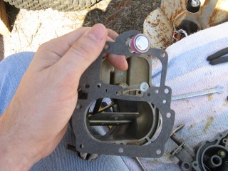

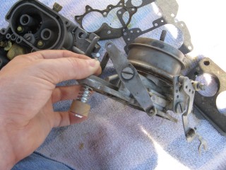

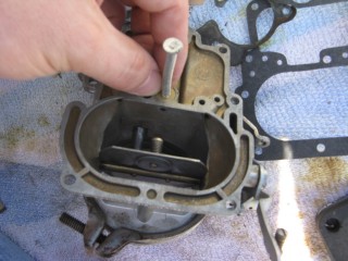

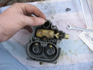

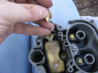

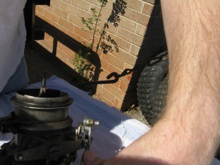

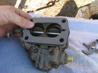

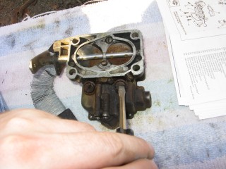

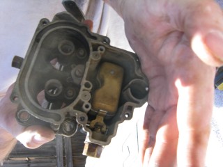

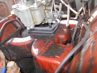

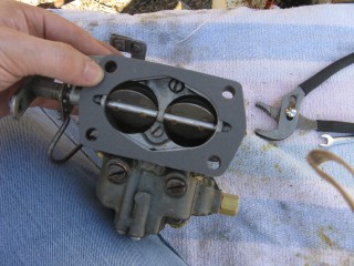

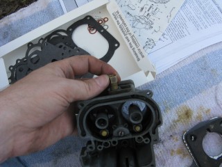

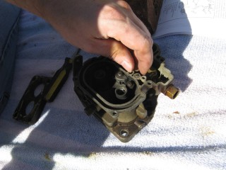

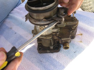

Here's what it looks like with the bottom plate removed. You can see how tall the lip is without the plate. Now is a good time to poke a clean(ish) rag in the intake hole so you don't drop crud down there and ruin your engine.
http://windypix.com/?dm=FW3M.jpg
My bottom plate had this really cool homemade gasket on it. It was made from what I assume was the box that the previous carb repair kit came in. It looked about like a cereal box only much thinner. They just tore off a piece and mashed it on the bolts. There were little bits of superthin cardboard everywhere.
http://windypix.com/?dm=S8NU.jpg
I pulled off most of the cardboard but several pieces were pretty stuck. They'll come off in the dip though.
With the carb removed and placed on these very manly pink and turquoise towels that my wife donated to my project, we'll get back to the dissassembly by straightening and removing the cotter pin shown at the top of the remaining linkage.
Sort of...My photographer had a hard time fixing the shot in the bright sunlight. :)
http://windypix.com/?dm=FWQ4.jpg
http://windypix.com/?dm=4AWP.jpg

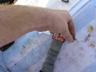

These cotter pins were very thin so bending them with a thumbnail was no trouble. Now we remove the lower cotter pin.
http://windypix.com/?dm=GN56.jpg
Remove the final bit of linkage.
http://windypix.com/?dm=N2WR.jpg

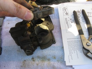

Now we remove the riser off of the "air horn", which is a fancy way of saying the top tube off of the carb. This screw has a nut on the other end, but it's clamped in there. You shouldn't be able to lose it, but don't try really hard just in case.
http://windypix.com/?dm=D8H5.jpg
Now just remove the riser by pulling it straight up.
http://windypix.com/?dm=JD59.jpg

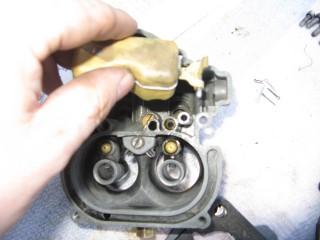

Then look at what's left. You have three main parts of the carb standing in front of you. The air horn on top, then the main body and finally the bottom part, which I forget the name of right now. We'll call it "the bottom plate" for now. My helper said we should just call it "Bob".

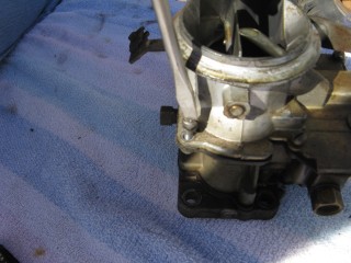

Remove the screws connecting the air horn to the main body. They're located here:
http://windypix.com/?dm=10R0.jpg
and here. This one also releases the brace that the throttle cable connected to. Don't lose them, store them together.
http://windypix.com/?dm=XD2L.jpg
Then here...
http://windypix.com/?dm=0U6B.jpg
And here...
http://windypix.com/?dm=BOKL.jpg
on to here...
http://windypix.com/?dm=PVQR.jpg
Then here, and this one's kinda hidden so pay attention :)
http://windypix.com/?dm=E1QG.jpg
There are two long springy plungers under the main body so as you pick it up be careful to come out pretty straight and hold it over something like my awesomely manly pink and turquoise towel (mentioned earlier). You never know when stuff will fall out. If it does, don't sweat. We'll show you where it goes later.
Lift the air horn off of the main body.
http://windypix.com/?dm=UAOX.jpg

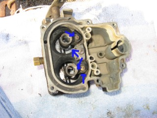

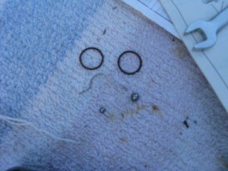

Be careful with the next portion. There's a little BB (yes, like you'd shoot in a BB gun) rolling around in two parts of the carb. The first part is right under this spring, which you might need to fish out with a screwdriver.
http://windypix.com/?dm=PD56.jpg
Now pour out the BB into your hand slowly so it doesn't jump out and run off.
http://windypix.com/?dm=CNA2.jpg

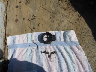

Here's a pic of everything we have done so far, with screws in the order they were removed, left to right...
http://windypix.com/?dm=OKL6.jpg
Here it started getting HOT under that boiling sun. We had to set up a little tent shade from Cecilia's cover. It worked OK for the time being.
http://windypix.com/?dm=D5FS.jpg
Our shelter set up, we continued by removing these little needles. There are two of them.

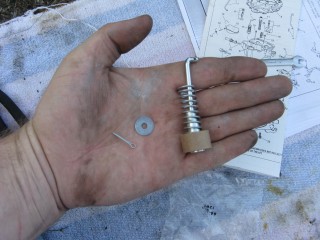

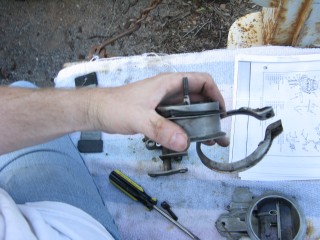

Now remove the cotter pin from the pump piston if you have one on it. Mine didn't. Say it with me now....Gremlins!
http://windypix.com/?dm=K90N.jpg
Mine also had a washer on the top of it with a spring poking through the hole. I'm 99% sure that was NOT factory rigging. When we rebuild we'll leave both the spring and the extra washer off. It's not pictured in my manual at all.
Unless that breaks something. Then we'll just make it ugly again.
http://windypix.com/?dm=DIXV.jpg

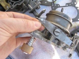

Here my expensive internet downloaded carb manual said to - and I kid you not - take a block of wood and a small wrench to pry out the vacuum piston pump (the second springy thing, located in the center of the carb). I thought, well that's weird. But if you say so...
My vacuum piston was stamped in and no amount of gently tugging would pull it loose. So I obliged it as directed and sent the top flying off into the sunset. DO NOT DO THIS, though it made a beautiful SPROING noise.
I found out later you don't even need to remove the vacuum piston as there isn't anything you need to replace in there. UGH.
http://windypix.com/?dm=1ZAS.jpg
Oh, and of course you can't buy this part for anything. Instead I had to get a magnet and fish the yard for the cap then I JB Welded it back together. It'll disintegrate over time in the gas but I plan to replace it anyway so no sweat there. It just has to work for a few weeks.
Anyway, lesson learned. Fun stuff keeps the boredom away, right? :D

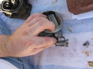

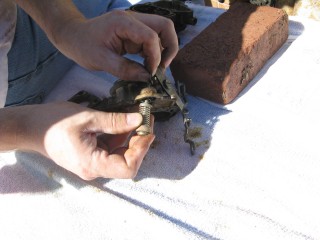

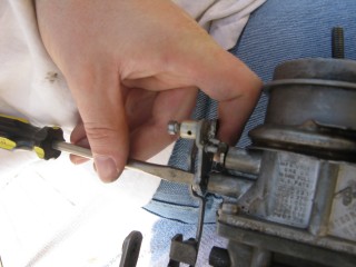

So moving on, we remove this big screw holding the throttle cable connections. Be careful though, there's a tiny spring on the back of the connections (shown below)
http://windypix.com/?dm=PTY9.jpg
http://windypix.com/?dm=N07E.jpg
You only need to unhook one side of the spring, the side that hooks to the carb. The other side should be stuck on due to a pinch in the linkage. Just gently remove the whole thing and set it aside. We'll dip the entire thing as a family project.

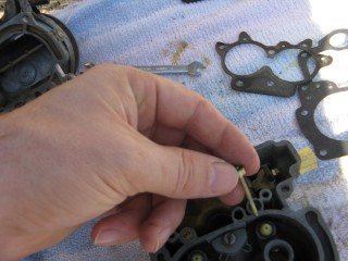

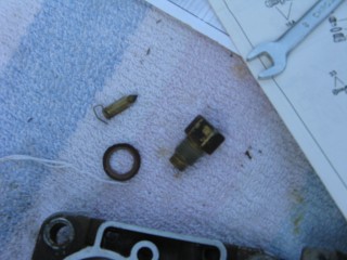

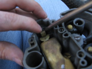

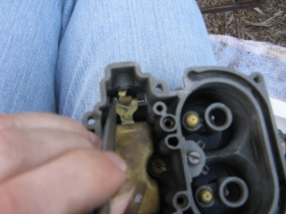

Next remove the brass fitting on the outside of the carb where the gas went in. My photographer had a potty/lunch break and took my camera so no pix. It's pretty easy though. Just unscrew it with a wrench and pull out the little rocketship looking pin inside by unhooking it from the float with a screwdriver.
Then use the same screwdriver to unhitch the metal pin on the float side of the carb holding the back of the float in. It'll spring off by itself if you're not careful so put a hand over it as you pop it loose.
Then remove the float and it's little pin that holds it in place.

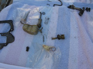

Here's a pic of the stuff we've removed so far, in order from left to right, in rows top to bottom.
http://windypix.com/?dm=50KC.jpg

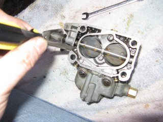

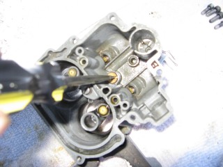

Now find some small wire to clean out the pins. Don't laugh, I have some of the wife's flower arrangement wire here. It works. Shut up. :P
http://windypix.com/?dm=ARAR.jpg

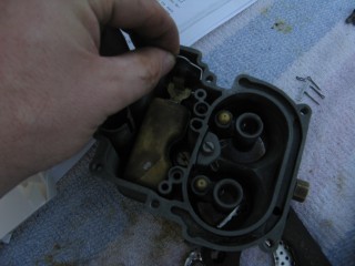

There are four more holes to clear while you're at it. The two inner ones are inside the smooth walls. You might have to hunt around for them. The outer ones are the big boobie looking nubs sticking up.
http://windypix.com/?dm=LJJI.jpg

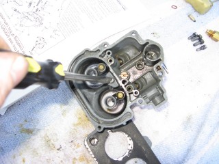

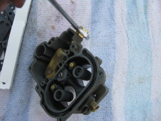

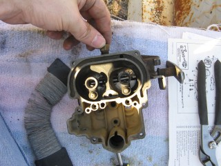

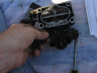

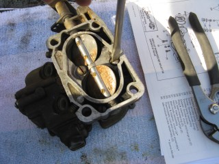

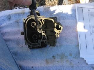

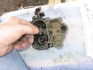

Now grab the trusty screwdriver again and remove this center piece. There is another even smaller BB under this so be careful.
http://windypix.com/?dm=JZ6T.jpg
Again, be careful when you remove it...There's another BB under it.
http://windypix.com/?dm=0X13.jpg
Then pour out the little BB inside.
http://windypix.com/?dm=3P7U.jpg

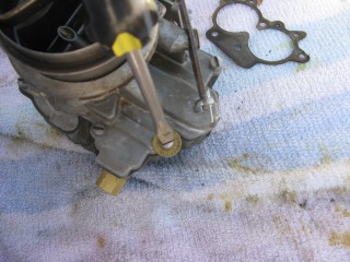

Now flip the whole thing over and take off the bottom big screws. These cover your jets. We won't be removing the jets this time but we will clean them out with the wire. Removal is unnecessary.
http://windypix.com/?dm=4PFM.jpg
Under those big screws is two very dirty, probably invisible copper washers. Remove them and set them aside in case your new ones break when installing. Then clean the jets inside with the wire.
http://windypix.com/?dm=MHXZ.jpg

Now we begin removing the four little screws on the very bottom. These hold on "the bottom plate", or Bob if you prefer.
They're located here...
http://windypix.com/?dm=2XYI.jpg
And here
http://windypix.com/?dm=8FLN.jpg
And here...
http://windypix.com/?dm=7AN0.jpg
And finally here.
http://windypix.com/?dm=E7FR.jpg
FetchMeAPepsi 10-27-2012 06:00 PM
Re: 1962 GMC 305V6 4WD Slow DD Build - Cecilia (Pic Heavy)

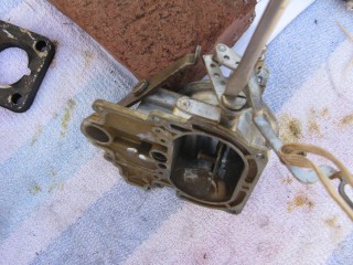

After that just lift off "the bottom plate" and set it aside. This completes the disassembly portion of our show!
http://windypix.com/?dm=4I00.jpg

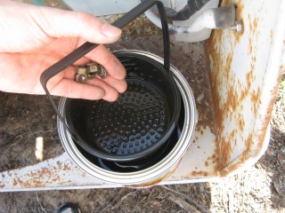

You can now start cleaning your parts! Grab a wipe-off towel and it better be a big one because you'll have almost a full towel of funk.
I took the air horn and dipped in the dip for 20 mins. The instructions say 15-30 mins. 20 mins seemed ok. Here's a before and after. I did have to dip the main body for two 30 min rounds though (not shown).
http://windypix.com/?dm=NSW5.jpg
Now it's safe to reattach the top back on the air horn. There is no replacement gasket in your bundle so treat it carefully.
http://windypix.com/?dm=EC59.jpg
Continue dipping parts, wiping them, and putting them back in their order. Set a timer so you get a reminder and keep parts moving through the dip. A simple egg timer that you steal from the kitchen is perfect. Buy her another one though because it's going to get nasty.
While that's happening we can open some plastic. Yummy fresh parts.
http://windypix.com/?dm=KB7D.jpg
This is part of what all you'll replace from the first package.
http://windypix.com/?dm=DR0J.jpg

Then put your little rocket ship piece (I think it's called a needle valve) back in and use the included keeper wire to hold it to the float again.
http://windypix.com/?dm=3RJX.jpg
Bend the end of it around with the screwdriver to make sure it stays put.
http://windypix.com/?dm=KBZJ.jpg
Now you can install the fancy new fuel fitting. I later found out this fitting didn't fit my gas line and had to revert to the old fitting. Never throw anything away until you finish!
http://windypix.com/?dm=93HV.jpg

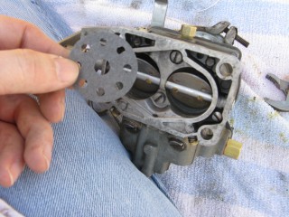

Flip the main body over now and find a gasket that looks like it fits.
http://windypix.com/?dm=VZ2K.jpg

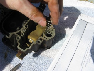

Grab the "air horn" (top of the carb) and your fuel piston pump. Poke one through the other.
http://windypix.com/?dm=0117.jpg
Pop a cotter pin through it.
http://windypix.com/?dm=48OR.jpg
Put the stupid vacuum pump piston that I broke and JB Welded in. That I hate. Stupid part. Grr.
http://windypix.com/?dm=1B47.jpg
Put these pins back in. Remember that there are two.
http://windypix.com/?dm=2M9P.jpg
Fnd our larger BB and drop it in the fuel pump piston hole.
http://windypix.com/?dm=IFBM.jpg
Drop the spring back in. Boioioingggg!
http://windypix.com/?dm=2JMD.jpg

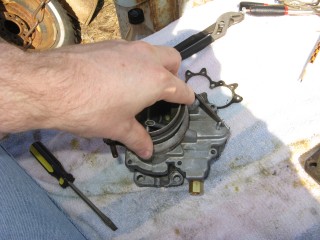

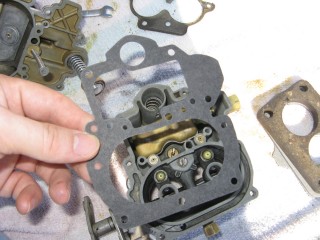

Go through your gaskets and find one that fits.
http://windypix.com/?dm=QHWH.jpg
Get your air horn again and pull the cardboard piece off of the fuel piston.
http://windypix.com/?dm=HC5P.jpg
Fit the gasket over the pistons.
http://windypix.com/?dm=MFNF.jpg

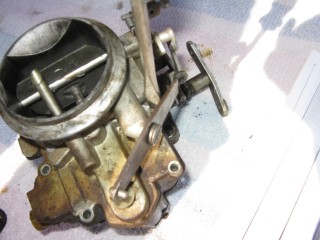

Grab your wrench looking piece of linkage and hook the wrench portion on the bottom of the carb.
http://windypix.com/?dm=8R70.jpg
Then hook the little spring on the back up and run the screw through it. Don't tighten it.
http://windypix.com/?dm=E3XK.jpg
Here's a side view so you can see. You need to make sure the wrench shaped linkage is hanging on the screw you just ran in, not butted up to the carb. THEN start screwing it down. It should move freely once you get it screwed down.
http://windypix.com/?dm=JTLZ.jpg
Put the link that looks like an "S" through the bottom part
http://windypix.com/?dm=E84T.jpg
Then the top.
http://windypix.com/?dm=TTL6.jpg
And cotter key them both.
http://windypix.com/?dm=HZM8.jpg

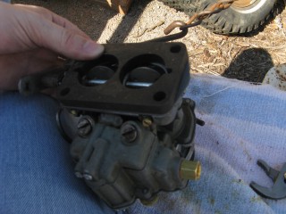

Now find a gasket to fit the bottom of "the bottom plate". This one obviously belongs in an art bucket at a pre-school. It doesn't fit. I have to say that for legal reasons so you don't try to use it and cause a thermo-nuclear reaction in your intake manifold.
http://windypix.com/?dm=NB3B.jpg
FetchMeAPepsi 10-28-2012 08:26 PM
This one looks better.
http://windypix.com/?dm=FL9I.jpg
The block goes on top of that gasket.
http://windypix.com/?dm=0VJN.jpg
Then another gasket to seal it to the intake manifold.
http://windypix.com/?dm=SOJ8.jpg

At this point we can move back to the engine bay. The end is in sight!
Remove the rag you put in the intake now. Be sure to jerk it straight up so as not to knock something off of your dirty engine into the intake.
http://windypix.com/?dm=Q69G.jpg
Then place your first gasket, your block (if you have one), and your second gasket (again, if you had a block) on the bolts and line them up.
http://windypix.com/?dm=Z2CD.jpg
Set the carb down on it's new perch.
http://windypix.com/?dm=52XC.jpg

Then it's on the carb mounts. Again I like to tighten them opposite, like a wheel. I tighten them good and snug again. Not tight, just snug enough to pinch the gasket.
http://windypix.com/?dm=N8LM.jpg
Then attach the throttle cable to the top and tighten the screw.
http://windypix.com/?dm=MNYI.jpg
Attach the rear clamp and tighten. Remember it has that little nut on the underside so don't unscrew it much.
http://windypix.com/?dm=F7CZ.jpg
Connect the large spring to the linkage shown.
http://windypix.com/?dm=WR83.jpg
Hook up the fuel line.
http://windypix.com/?dm=67KV.jpg
And finally fire it up and see if it runs. It has zero gas in the float bowl so remember that it might not start quickly the first time.
After you get it to fire up it should start easily after that.
If it runs put the air cleaner back on it. My photographer had a problem with the loud motor running so it's a little off center lol.
http://windypix.com/?dm=GQQY.jpg
A little note about the air cleaner. I had intended to clean it as well but I ran out of weekend and painkillers so it got pushed back to next weekend. Sorry about that :(
If all went well the last step is to take the kiddos and the ugly mutt for a spin around the block!
http://windypix.com/?dm=XZVI.jpg
Congrats, you just rebuilt a carburetor!
If you noticed something I did and shouldn't have done, or missed doing entirely, speak up! This was my first carb rebuild. I enjoyed it quite a bit.
My only issues after mounting were gas coming out of the carb piston hole and a rough idle, both of which were fixed by adjusting the float then adjusting fuel mixture screws as described earlier. My mixture screws were an entire revolution off.

A little update on the carb rebuild here. I adjusted the idle mixture screws and the idle setting screw according to what I found on the internet. It tends to surge at startup and act kinda wonky after it's warm.
I was talking to an old timer about it and he said this:
Gently seat the Idle Mixture Screws again like you did before (tighten them till they're just barely seated). Now unscrew them two full turns. Start the engine and make sure the choke is wide open. Turn each screw in 1/2 turn at a time until the engine rpm starts to drop. Then back them both out equally until you reach the highest rpms possible. LEAVE THEM THERE.
Idle Screw: Now just adjust the idle screw (by the spaghetti) till it's where you want the RPMs to be. That's it. Purrs like a kitten.
I'd trade the entire internet for a handful of old timers with great stories.
http://images.sodahead.com/blogs/000...ng_xlarge.jpeg
awbrown 11-03-2012 06:45 PM
I used to rebuid carbs in my dorm room when I was in tech school .. one day I did my buddys and set the mixture screws by ear ... My buddy not thinking I had it right put it on the machine in his class to see how far off I was .. He was surprised to find it spot on the number ... best done with a vacuum gauge ...
FetchMeAPepsi 11-03-2012 08:51 PM
Now that's a neat trick! I wish you were closer. I've got her running nicely now but there was a lot of trial and error. She still bogs a second when I nail it, but I think the timing might be off a hair.
What's the procedure for doing it with a vacuum gauge (if you have the time to explain it)
-FMP
awbrown 11-03-2012 09:29 PM
simply hook the gauge to manifold vacuum and adjust the screws til you obtain the highest reading ,make sure the engine is fully warmed up and that the timing is correct.. also verify that the vacuum advance (if it has it ) and the centrifical advance is working .. as far as the hesitaion , make sure the accelerator pump starts spraying the instant the throttle is opened..any slack or slop in the linkage may cause it to hesitate...you can bend the linkage to remove slack..
FetchMeAPepsi 11-04-2012 05:05 AM
I may dig up a gauge and give that a shot. I'm only getting fuel out of one barrel ATM so I'm chasing that issue down now. The injector port on these old Strombergs is center filled then ported out of the two holes into both barrels so IDK how it can even be possible to shoot from only one port :uhmk:
