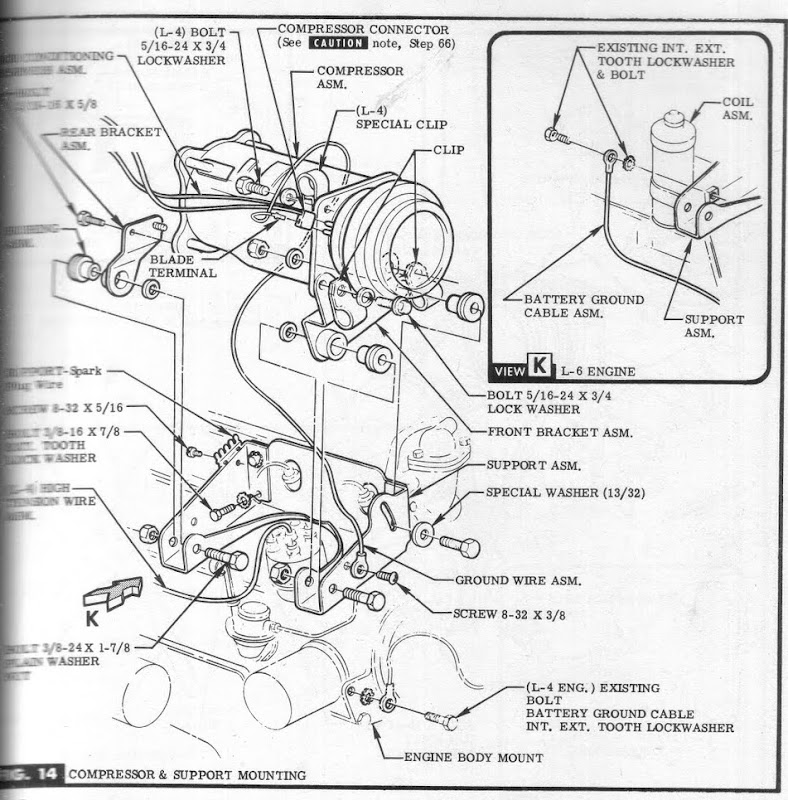

The knobs on your A/C unit are from the passenger car line like the Impala's. The one's that came on my unit, are the Corvair style like in the picture below.
Were the units not different pre 62? I'm not sure, but did they not have a black housing compared to the beige and white housing from 63?
The V8 compressor mounting brackets were bent steel plate not cast.
The X brace at the front of the rad support gets bolted in after the installation. The rivets removed.
When I get the chance I'll scan the complete installation instructions.
