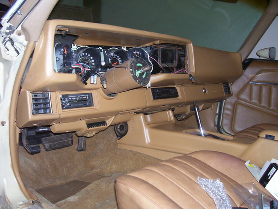

Prep clean. And when you think you've cleaned it enough, clean it again. Use a adhesion promotor before you spray the color and follow the color with the low luster clear. Here is my Camaro's interior when I got it.
http://www.supermotors.net/getfile/5...e/100_3200.jpg
http://www.supermotors.net/getfile/5...e/100_3204.jpg
Here it is after. Now I replaced the door panels and installed a dash cap but I had to paint the cap, arm rests, console, sterring wheel and lower dash. All SEM products cleaning, adhesion promotor and low luster clear.
http://www.supermotors.net/getfile/6...e/100_3590.jpg
http://www.supermotors.net/getfile/6...e/100_3587.jpg
http://www.supermotors.net/getfile/6...e/100_4623.jpg
http://www.supermotors.net/getfile/6...e/100_4622.jpg
http://www.supermotors.net/getfile/6...e/100_4624.jpg
