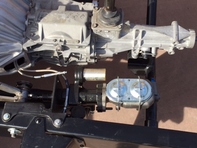

e015475 07-16-2018 11:55 AM
Re: T5 transmission crossmember ideas??
Here's the new shifter location in case you're curious
https://talk.classicparts.com/media/...nnel.6667/full
