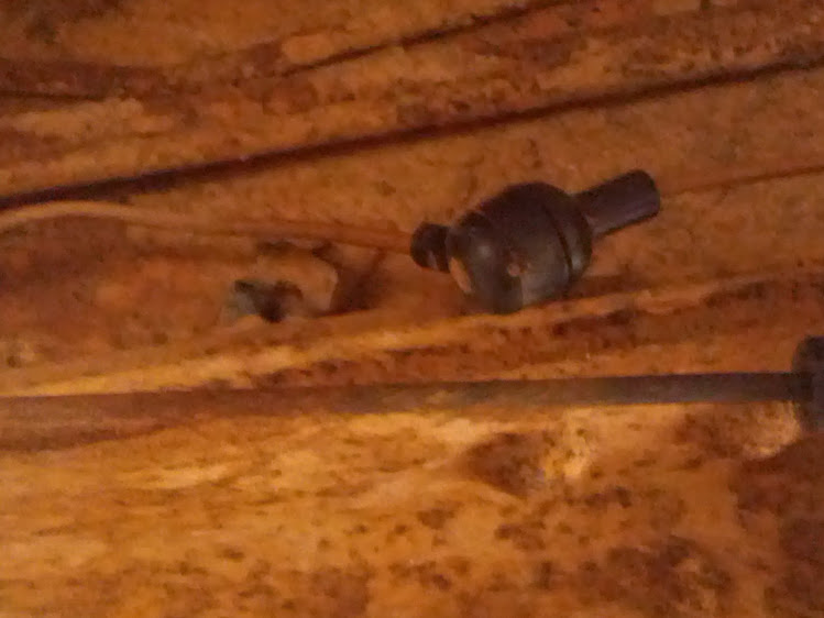

Hello, i am trying to test my fuel sender before I do anything drastic. If the sender is working as expected and there is just a wiring issue I should be able to (using a ohm meter) attach a lead to the sending wire (tan wire), and one to a ground and read the resistance to get an idea of the fuel level correct (Based on this thread)?
Here's what I have done so far. First thing was to read several threads on here. I'm following their advice and would like confirmation of my next steps.
  • Originally the fuel gauge read at 3:00 position. (Indicating an open circuit?)
  • I grounded the sender wire from the gauge and got an Empty reading (as expected)
  • This removed my focus from the gauge
  • Identified the fuel tank sending unit ground wire and made sure it was attached to a clean verified ground (observed continuity between the black side of the battery to the ground wire for the fuel tank)
  • Identified and test that the tan sending unit wire coming out of the fuel tank was not (contacting) grounding to the fuel tank (was unable to observe continuity between the fuel tank and the tan sending unit wire)
Here's where things fall apart.
After cleaning up the ground and re-verifying it to the black side of the battery.
I checked the resistance to ground of the tan wire near the fuel take it read around 200. I had my wife bounce the rear end of the truck and the reading went haywire and settled back around 200.
I then checked the tan wire inside the engine compartment, and it read 56. I still haven't read it once inside the cab or at the gauge. I dread taking the cluster out again.
The gauge went from the 3:00 position to about the 2:30 position and is currently holding steady there. . . . here is an image:
https://lh3.googleusercontent.com/-u...229_104234.jpg
Any direction here would be great.

So phase two of investigation. . . I was able to reach my hand in and disconnect the fuel sending wire from the main fuel tank sending unit. (I'm writing this as i go). I ran a ground wire directly from the battery and checked the resistance between that and the nipple where the sending wire connects and got a solid reading of 108. I know we have nearly a full tank.
Picture of the nipple the tan wire attaches to on the fuel tank sending unit. It's the much more shiny pin standing straight up in the center of the image.
https://lh6.googleusercontent.com/-y...231_131710.jpg
I believe the sending unit is not of the same OHM range as the gauge. . .

You hooked up the resistors correctly, your test setup looks good, as do your results. Your gauge looks to be reading all the resistances correctly. This tells me that your gauge is working, and the wiring up to that point is also in good working order.
Your reading of 108 at the sending unit is troublesome. If you read a open circuit, that would be easy to diagnose as a bad sending unit. The problem is, 108 isn't so far from the expected 90 ohm to call it a "bad" sending unit. It's kind of a gray area, in the realm of "weird" or "odd", but not in the realm "bad".
The sending unit itself can be tricky. It's just a wiper that runs along a coil of thin wire, and it's entirely possible that thin wire is broken in a funny spot. It might be broken between full and 3/4 tank. It would be very difficult to spot.
And sending units vary significantly, there is no way you could have a mis-match and get "kinda close". Older GM stuff is 0-30 ohm, you obviously don't have one of those. Older Ford stuff goes the other way, (higher at empty) 75-10. The closest thing that would match your readings would be newer Ford units, at 16-158, but there's no way it would FIT, so you can't possibly have the "wrong" sending unit in there. That can't be the problem.
The resistor test verified that your gauge is working correctly. I would do several more tests on the sending unit at various fuel levels.
