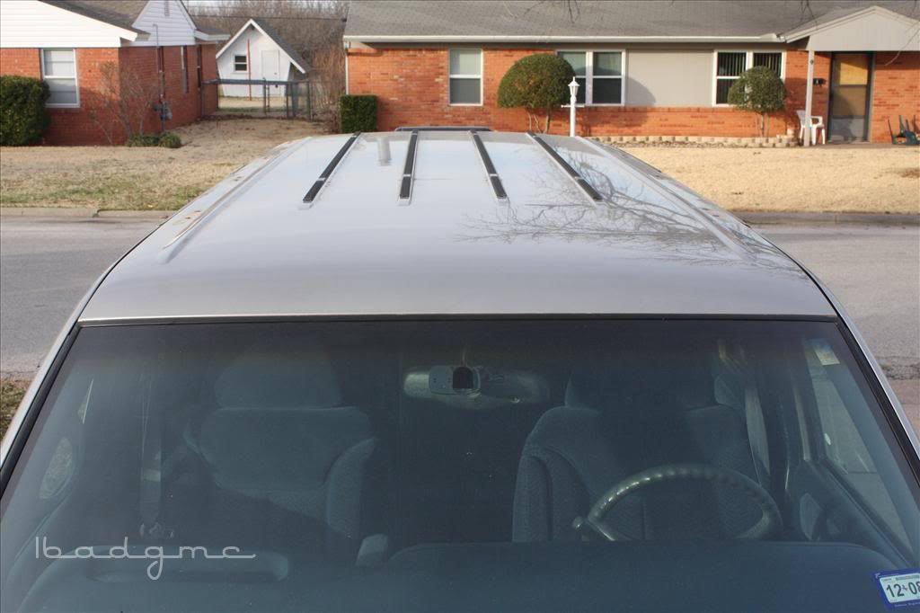

I had a '99 Yukon that I had the billet plates to cover the holes with. Just a small amount of clear silicone to attach them and I never had any issues.
http://i53.photobucket.com/albums/g5...DCP_1588-b.jpg
I currently have a '98 Suburban. I don't have the billet plates this time, so I just filled the threaded holes with silicone. It's been that way for over 4 years now without any issues.
http://i53.photobucket.com/albums/g5...n/IMG_1216.jpg
