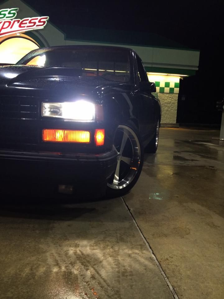

ss454lemy 07-29-2014 03:00 PM
Re: 90 ss prostreet
this is what im working with

thanks for your help ! im stuck to the original plan 20x8.5 and 22x11
ss454lemy 08-01-2014 06:03 AM
Re: 90 ss prostreet
http://i365.photobucket.com/albums/o...ps7d27a91a.jpg
http://i365.photobucket.com/albums/o...ps55580239.jpg
http://i365.photobucket.com/albums/o...ps79f12d5b.jpg
ss454lemy 08-01-2014 06:06 AM
Re: 90 ss prostreet
