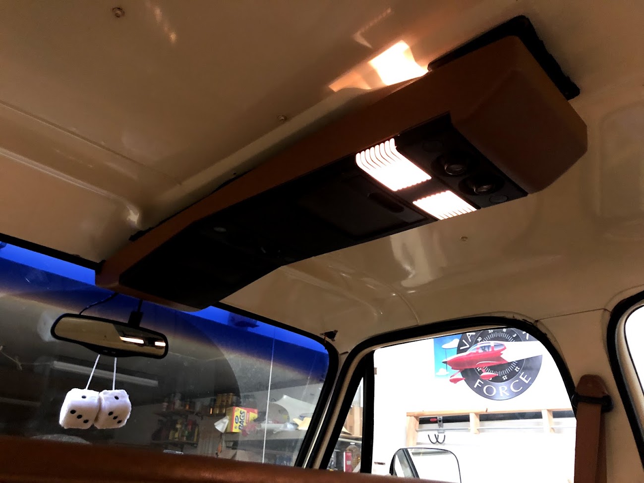

For the interior, I installed a new carpet, overhead console, gentex mirror, sound system, inverter, trailer brake controller, and a custom gauge/switch pod that mounts under the dash in front of the 4wd shifter. A couple pics here:
https://goo.gl/p7Tdmg
Overhead console out of a 91 Suburban, and Gentex mirror from a 99 Silverado

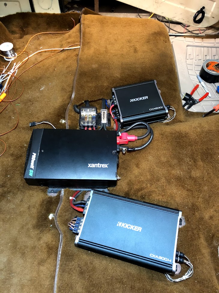

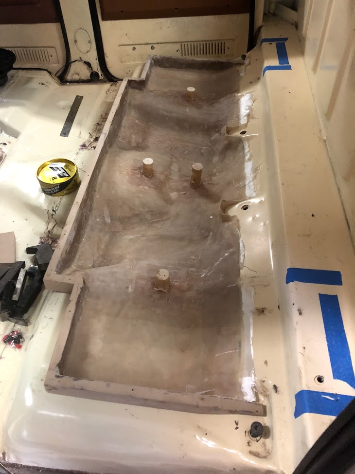

Fiberglassed an amp/inverter rack to go under the carpet below the front seat. Wooden dowels serve as mounting pads for the components.
https://goo.gl/anNSNo
Amp rack with components installed
https://goo.gl/xzCMRj
With the front seat installed, all you can see is the face of the inverter sticking out towards the rear. Also note the LED lighting for the backseat, tied into the courtesy circuit.

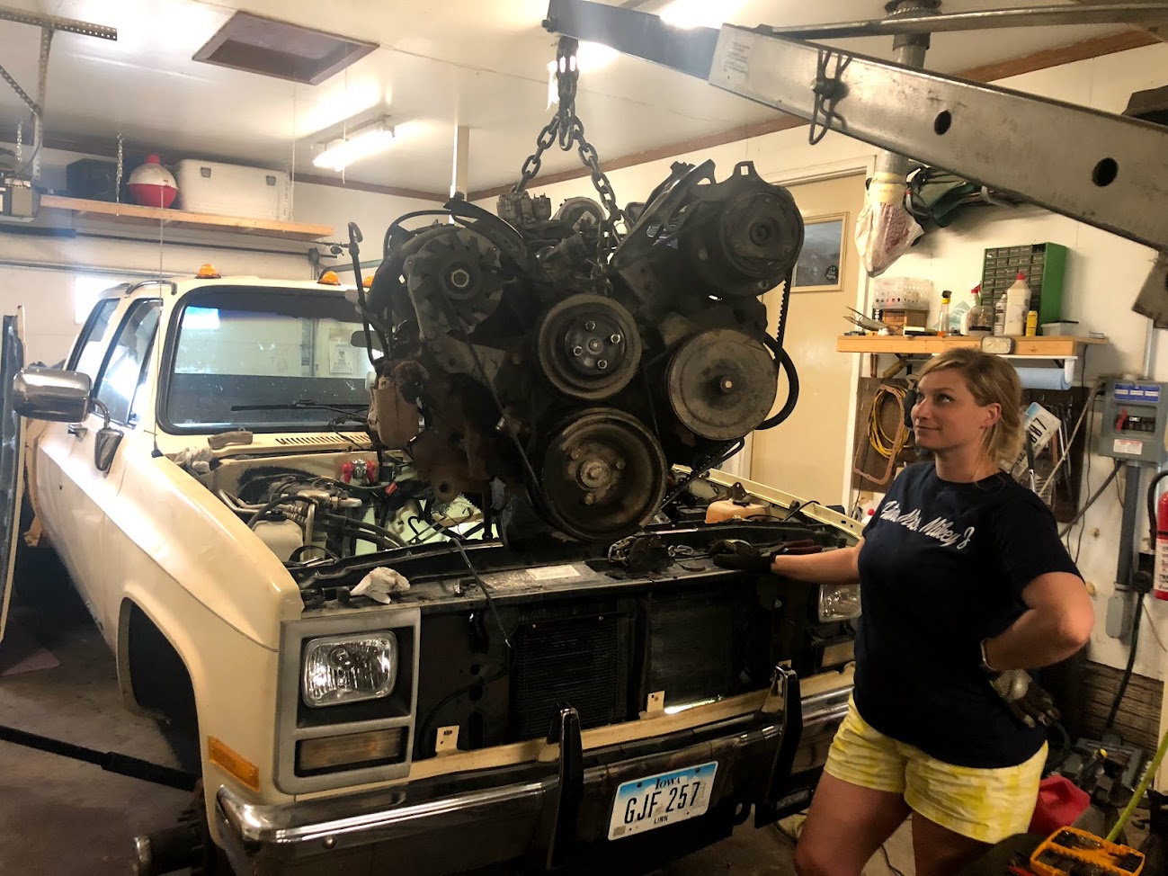

Old 350 coming out with my fiancee/helper Sarah striking a pose for the camera
Video of the first start here (sorry it's sideways)
This may have been the first time I had a first start where the engine fired up right away on the first try!!:two: A couple minor snags, one was I forgot to hook the tach wire up so Sarah couldn't target the 1500-2000rpm we were going for to break in the cam, and the AC compressor clutch started dragging and began to smoke. Minor stuff, and we got it all resolved quickly.

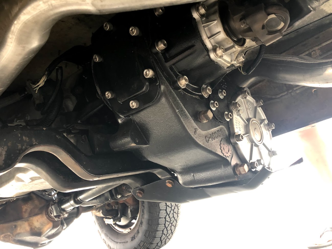

Somehow I never took a pic of the transfer case until the overhaul was finished, so here it is already installed back in the truck
Once all was back together, I was SUPER nervous that something hadn't been done right. Fired her up on jack stands, topped off the tranny fluid, and put her in gear. What do you know, the wheels started spinning.... even in the right direction!!!!
