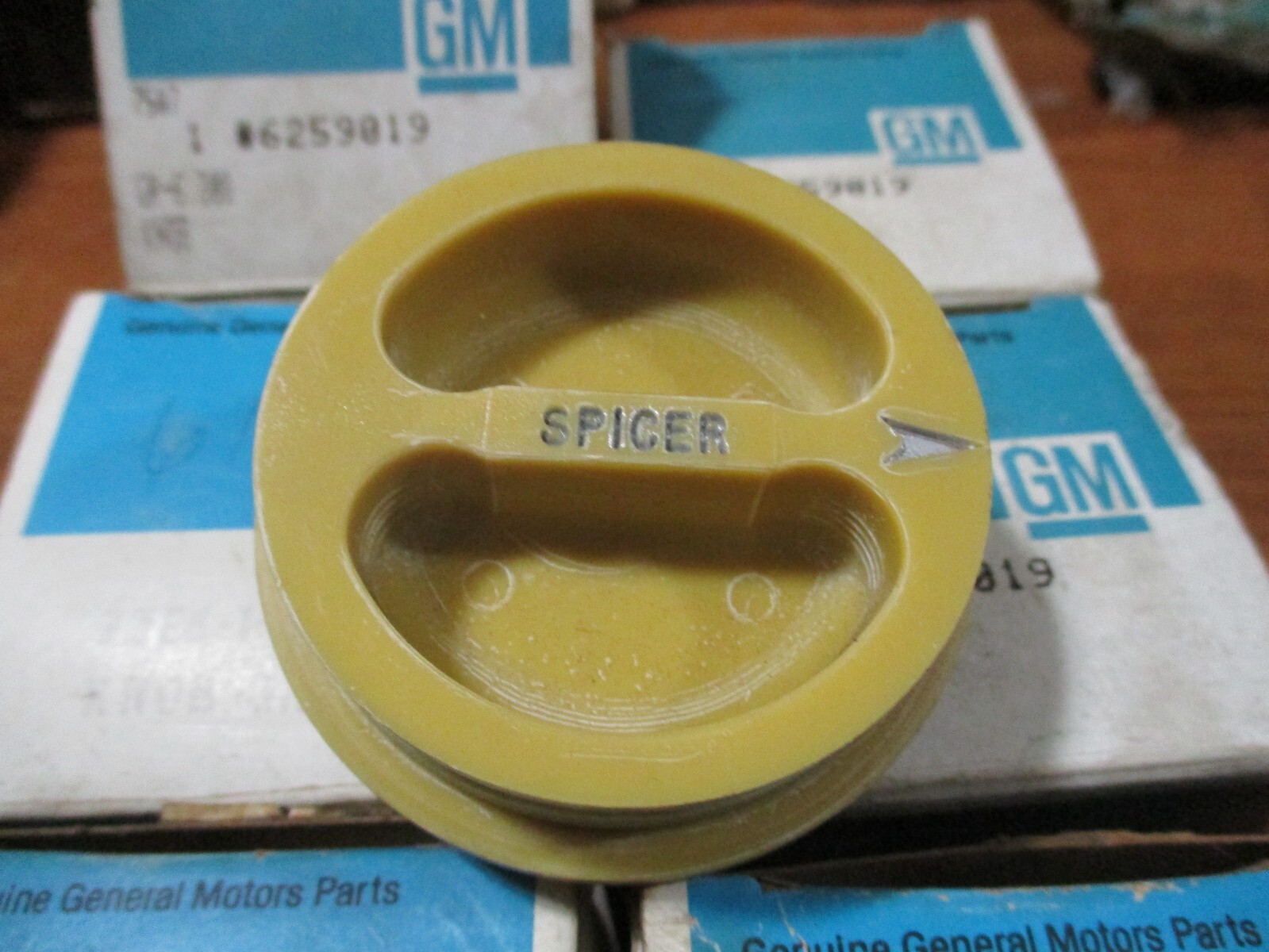

1968-1969 K10's/ 1969 K/5's used the red dials GM 3937068
https://67-72chevytrucks.com/vboard/...1&d=1557142220
1970-1972 K/5 / K10's used the blue dials GM 3979551
https://67-72chevytrucks.com/vboard/...1&d=1510112393
1973-1980 K/5 /K10's used mustard dials GM 6259019
https://i.ebayimg.com/images/g/K9EAA...6U/s-l1600.jpg
1970- early 1971 K/20 used red dials
https://www.67-72chevytrucks.com/vbo...1&d=1595875886
1971-1972 K/20 used blue dials 3995867
https://www.67-72chevytrucks.com/vbo...1&d=1705849600
1973-early 1977 K20 used mustard dials 6259022
https://i.ebayimg.com/images/g/YHwAA...Gj/s-l1600.jpg
https://www.67-72chevytrucks.com/vbo...1&d=1603214590

I don’t think that is correct, the closed knuckle axles (‘69 and before) used the hub lock aluminum dials as far as I’ve ever seen. Taking it a step further ford did use the red dials as well in the late 60’s-early 70’s.
1970cstblazer 03-19-2024 01:05 PM
Re: 4wd spicer hub color
Parts book lists 1968 and 1969 with the Spicer lockout hubs..

1970cstblazer 03-19-2024 02:35 PM
1969 Blazers used the open knuckle drum brake Dana 44 from what I have run across.

jerry moss 03-19-2024 10:46 PM
in my experience 70 K series was the only year for open knuckle drum brakes, 69 and older was closed knuckle drum brakes. so were blazers different in 69 and got the open knuckle front before the K series trucks ? i've never owned a 69 blazer, only 71 and 72s but i've owned several 70 K series trucks with open knuckle /drum fronts and a few 69 K series trucks with closed knuckle/drum fronts.

1970cstblazer 03-20-2024 07:31 AM
Not to say the GM partsbooks are gospel, but they are compelling...
1969 Blazers with the open knuckle front Dana and red hub dial:

1968 half ton was red. Don't know the exact cutoff of the red half ton dials, but my March 1970 St. Louis Blazer always had the blue dials as verified by my father who put the first miles on it. I have personally owned it since 1987 when it had 50k miles on it and had bald original tires on it.

Seems at least according to torque king the open knuckle 69 blazer is quite possibly a reality, which I’m not totally surprised about as I said before. I’m still not sold on the dials on non K/5’s pre ‘70. It’s been a while since I’ve played with the aluminum dials but I seem to remember that they don’t directly interchange with the plastic dial hubs. someone correct me if I’m wrong. It’s been a decade or more since I’ve messed with the spicer hub loks.
I’m not surprised on your blazer having blue dials from the factory either. I’ve seen other original later model year 70’s that had blue dials in the past.

GM info has been posted. Pretty compelling info that the 10/68 parts book contradicts your statement.
