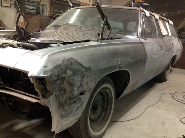

So, the wagon's in the garage, and the grinder is out for some old repair hunting.
When I noticed the badly done repairs on the various body panels, I knew I had more work ahead than nagotiated.
Sure enough, this is what the repairs look like:
http://waasadata.com/belair/img/belair005.jpg
Yup. A big enough piece of Sheet metal, in this case also just bent under the
front fender, the result being that no panels seem to align whatsoever.
All these repairs are being cut off, new patch panels made, and those, in turn,
are welded in flush.
As you might be able to see in this pic, the bottom of the fender is now in line
with the rocker panel, and all of the patch sitting flush, it will need much less
filler to look that much better. At least in theory :)
http://waasadata.com/belair/img/belair006.jpg
Behind the rear wheel, at the bottom of the rear fender, a long piece was done in the same manner.
There also was a dent right above the exhaust pipe, so that got tidied up smartly.
http://waasadata.com/belair/img/belair007.jpg
After taking care of a few more old repairs, all welds ground, the car was
turned around, and work can comence on the right hand side of the vehicle.
http://waasadata.com/belair/img/belair008.jpg

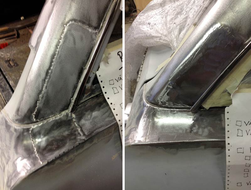

On the right hand side of the car the problems were a bit worse than expected.
I had noticed something about the shape of the rear pillar, and these patches
were a bit worse to get out than the previous ones. The new patches were
made a bit smaller than the old ones, and cutting those off left some score
marks in the sheetmetal. Some filler will remedy that. Someday I might try
lead...
http://www.waasadata.com/belair/img/belair008b.jpg

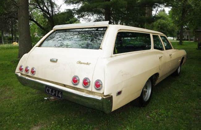

I always liked the way the tail light are close to eachother to Chevrolets from
1965 and older. When Chevrolet came back to separate lights in 1968, they put
them farther away from eachother. On the Kingswood this was further
exaggerated. This is illustrated in this pic:
http://www.waasadata.com/belair/img/belair016.jpg
My wagon has been hit in the rear left corner, and the tail light lenses are all
in dire need of getting changed for new ones. It's not really easy to find
tail light lenses for the 1968 wagon, so I came up with the idea of costomizing
my ride by mounting three pairs of 1950 Pontiac tail lights with sequential turn
signals. Ever since I was a kid, I have dreamed of having that kind of turn
signals on my car.
This would also let me tuck the tail lights a little bit closer to eachother, than
they're originally on an impala or caprice wagon.
I tried to photoshop Pontiac lights onto the tail of a '68 wagon, and I think
this would look so okay, that people who don't know classic cars probably
wouldn't notice that it's not an original look.
http://www.waasadata.com/belair/img/belair014.jpg
Yup, I pasted in my own register plate too .
