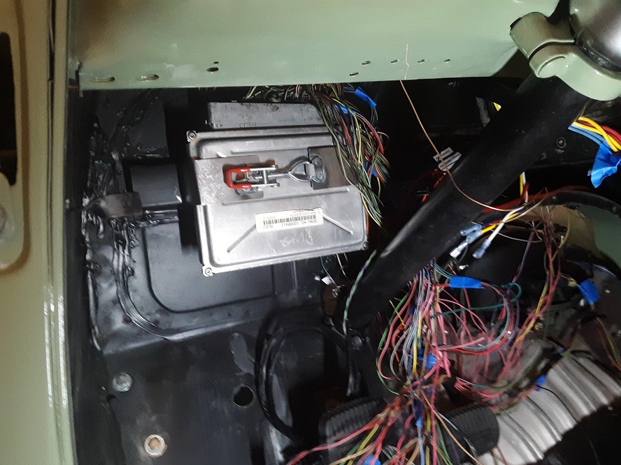

e015475 02-06-2019 11:39 PM
Re: Convenient EFI computer location in 52AD?
https://talk.classicparts.com/media/...nted.7028/full
Mine is under the dash.
Northern 52 02-07-2019 05:59 PM
Thanks for the ideas for possible locations. I was initially trying for under the drivers seat but my harness is from a truck where the computer was behind the left headlight. When I tried to re-assemble it in this location, it got very tight for wire length. I have since been working on a bracket that will go behind the glovebox (a couple of rails from the bottom of the glovebox opening up to the firewall, and up as high as possible). That should leave enough room for a future heater below it along with room for a stereo head and even a pair of gloves in the glove box. The harness should reach everything it needs to from that location. It's moving slowly but I am really enjoying the build ("one piece, and one step at a time").
By the way, I like that clamping mechanism on the image above. Where did you get it from?
