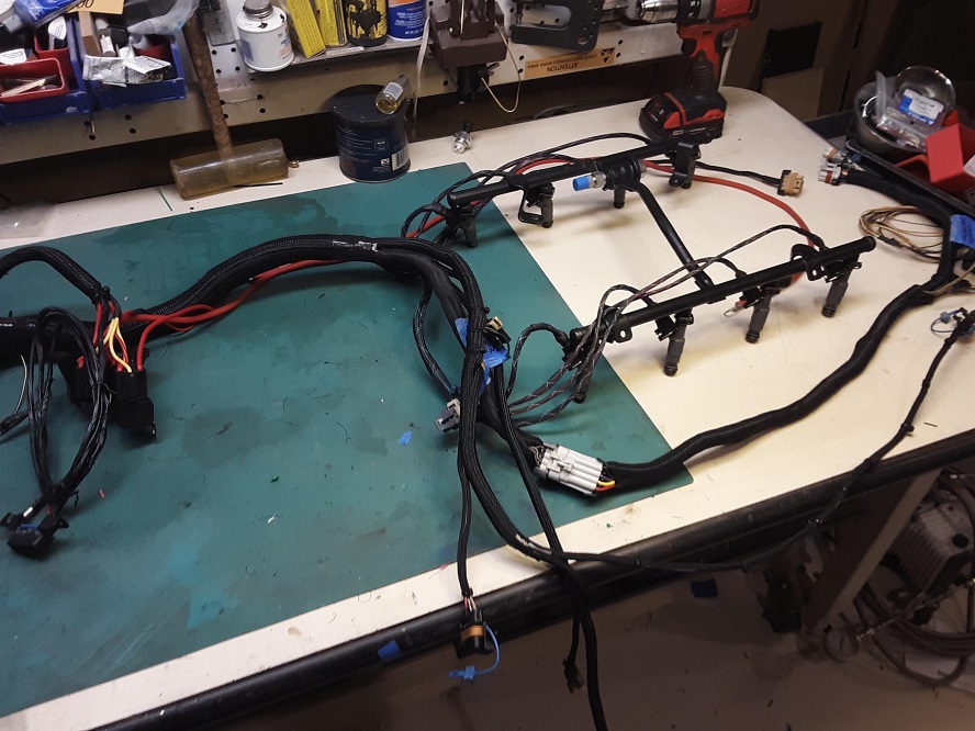

Depinned engine harness --- now ... ??
So unloomed and depinned this bad boy about 6+ months back.
Now looking to finish it off and get it into they truck.
Whats the best approach here ? Stuff like ....
Routing and lengthening/shortening wires ..... which ones typically ..... injectors seem to be a standout as they are in completely different positions. eg first part of harness from the PCM .... .annd then about smack bang in middle of the middle run.
Grounds - how many should there be ? Where do they connect (Harness was removed by a friend whilst I was dissaembling the trans).
Other suggestions ?
This a 2007 lq4 6.0.
https://i.imgur.com/LLCL5aul.jpg

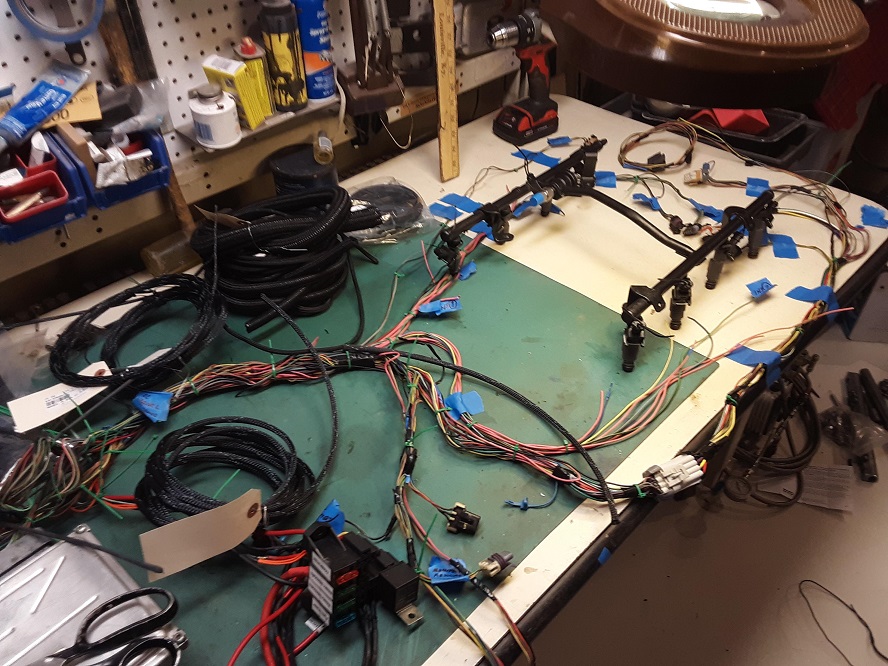

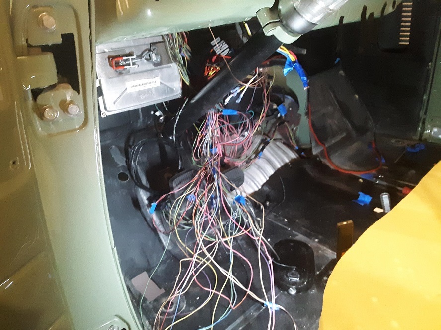

A few photos-
Here's the harness draped onto the motor. Some of the discrete legs had mis-matched wire lengths that I pulled into the cab to tape in coils and shorten on the bench.
https://talk.classicparts.com/media/rats-nest.7027/full
Here's the firewall side with the injector leads on the top of the engine . To shorten these wires, I just cut them to length since I was replacing the connectors anyway.
https://talk.classicparts.com/media/...ring.7026/full
Here's the taped up harness on the bench ready to loom. I found it easier to get the wire lengths correct if I used the fuel rail as a guide.
https://talk.classicparts.com/media/...1917.7033/full

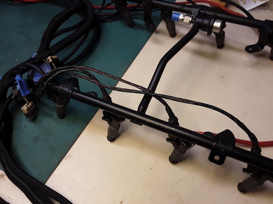

Here it is loomed up. That big connector in the leg that goes to the coils is the extender harness (hidden down in frame rail)
https://talk.classicparts.com/media/...17-1.7031/full
Here's a detail of the injector leads with the 'chinese finger' loom. There's several layers of shrink tube at the injector connector to provide strain relief. If I can figure out a nice cover for these, I should be able to pretty much hide all the wiring in my engine bay, but that's a future project.
https://talk.classicparts.com/media/...35-1.7032/full
