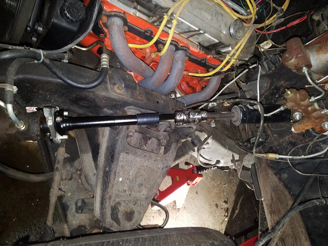

New steering linkage
https://i.postimg.cc/XJzDYXc4/steering.jpg

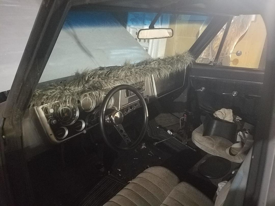

New steering wheel with tilt
https://i.postimg.cc/HxFDP6Nw/steering2.jpg

I figured I should mention I added power steering to the truck so the small diameter steering wheel is no problem. No power steering in 67'. The motor in the truck is a used 350 crate engine I found on craigslist that came with a power steering pump. All of the engine accessories are on one giant bracket. I found it easier and less expensive to add a power steering gear than to subtract the the pump from the engine. I picked one up for $60 at the local junkyard. It didn't just drop in but I figured it out with a cutting torch.
