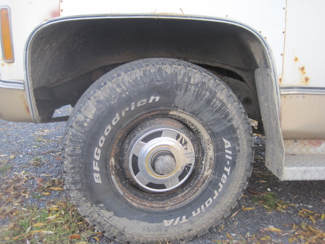

I run 30x9.50 BFG's on my stock wheels on my K10. I have to keep those beautiful hub caps.

30x9.50s are a thought. I’d love to keep the caps. Any issues on a 6” rim? Got a pic handy?

I didn't get a chance to get a close up of my tires. I'll get one tomorrow. I would buy another set of BFG 30x9.50's when these wear out. I roll down the interstate from time to time at 70-80 mph. These tires are so smooth on the highway I don't even dare to rotate them

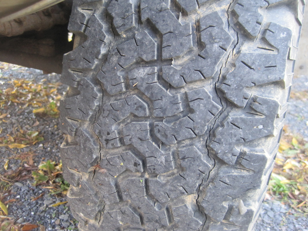

Here's a close up of the 30x9.50's. They don't look overly huge for the stock wheels. The middle of the tread isn't wearing out like a tire that's too wide for the rim. Ya gotts love how solid axle trucks wear tires so evenly. Those independent front ends chew up the insides treads of tires.

Cadillac Al, dang, that is some impressive cracking in the tread. Any idea how old those tires are? My friend has a similar set of bfg's. About 15 years old, lots of tread, but lots of those cracks in between the tread too.

I would guess at least 20 years old, before they started putting DOT date codes on them. That's the way they looked when I got the truck 8 years ago. I put about 20k miles on them and the tread and cracks haven't changed. The previous owner and I definitely got out money's worth out of them. I have another set of BFG's in storage that I bought in 1998 that don't have a date code on them. If there is a DOT date code it is well hidden on BFG's.

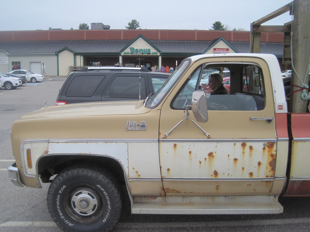

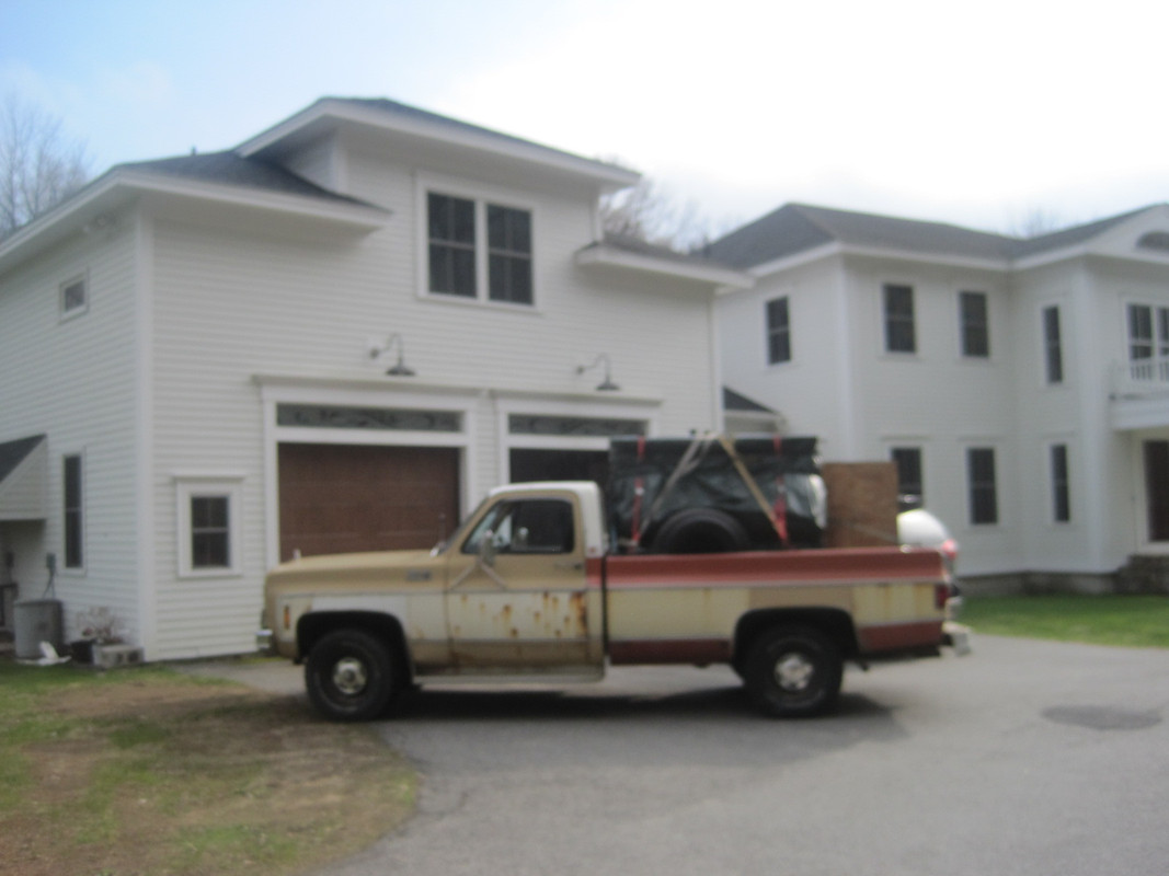

I’m on the road for work this week and decided to roll the dice on bringing the 41 year old rig 150 miles from home. Working through some vibrations at 45-55mph and 65-70mph, but other than that, it did well. Definitely need to get tires sorted out.
Here’s a couple photos.
