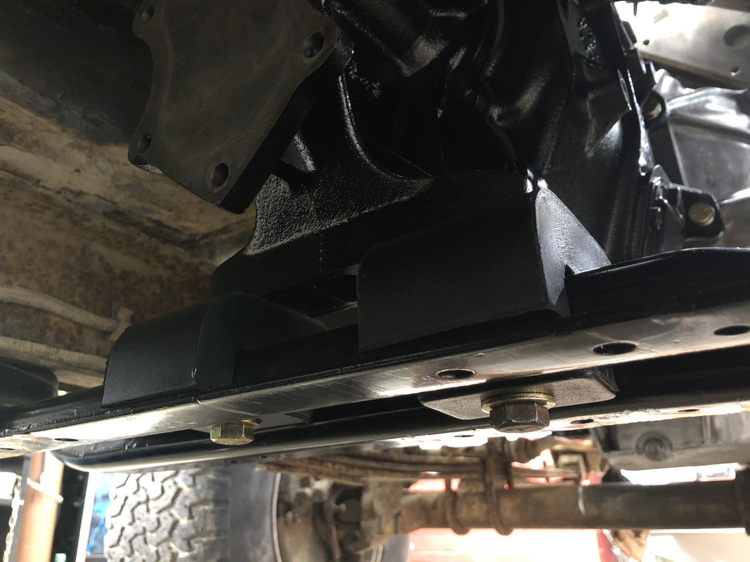

Transmission/T-case adapter mount bolt torque
So I have three service manuals in front of me and all of them are very vague on this bolt torque, or which bolt is even being referred to. I’m coming up with specs from 40ft-lb all the way up to 130ft-lb! Does anyone have a factory GM service manual they can pull this from? I don’t want to guess. 1978 Chevy K20 with SM465 and NP205.
https://i.postimg.cc/yddJGp8J/B27400...036-DD0084.jpg
MJN 06-29-2020 08:40 AM
Re: Transmission/T-case adapter mount bolt torque
Pulled this from the '74 service manual. You've got a nice setup but I'd recommend putting the locks on the transmission cross member bolts.
Nick_R_23 06-29-2020 10:41 AM
Awesome, thank you! And I’ll throw a set on, everything is still loose waiting on the specs.
