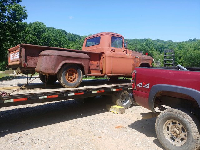

It all started when I dragged this little heap home. She has been [strike] rotting [/strike] sitting patiently in the yard waiting for things to fall into place. Three years later, her time has come.
https://i.postimg.cc/nzvR4jWP/1-B1-A...AF54466-E9.jpg
The Truck

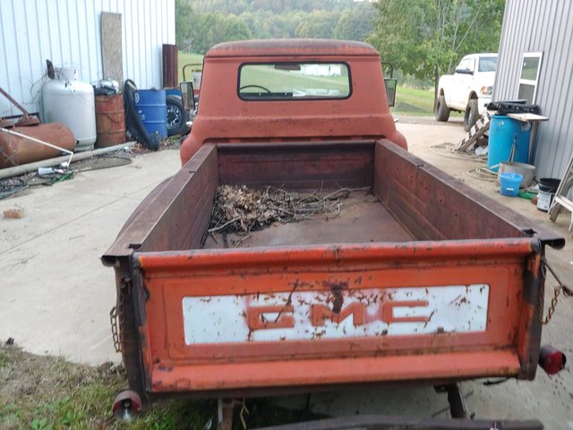

The title says it is a 1955 long bed GMC 100. From the looks of it she got a '57 nose job somewhere along the way. It's not in the best of shape by any means, but it is mostly complete and should suit my needs pretty well.
https://i.postimg.cc/L8XbcsqJ/049-DA...46-BD64-C2.jpg
https://i.postimg.cc/WbsK78T6/4-A792...-BFC8-E060.jpg
https://i.postimg.cc/J0LFvcJ8/2-B9-E...-F40-F05-A.jpg
https://i.postimg.cc/wBnZcdj7/30153-...1-EA0-DF23.jpg
https://i.postimg.cc/8CfnCnmD/A9-F94...551-C861-E.jpg

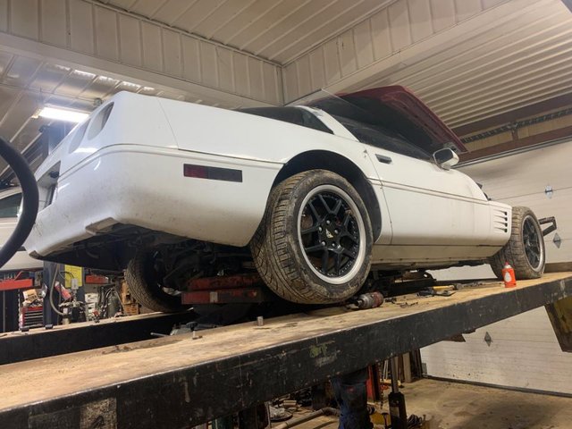

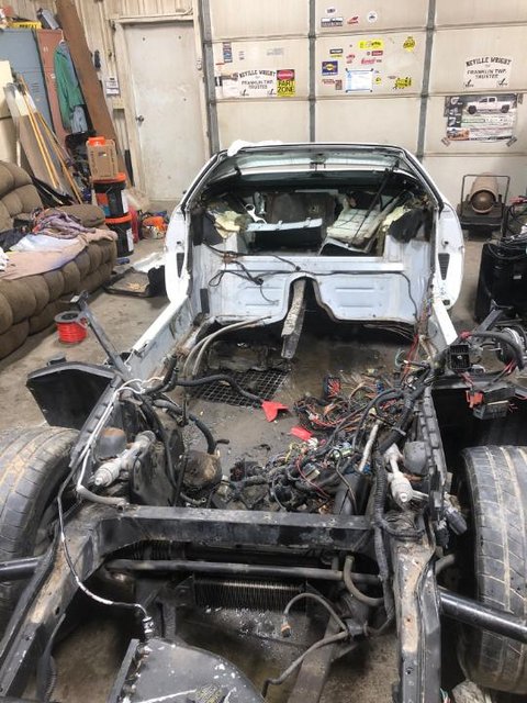

I picked up a running 94 corvette to harvest as much as I can out of it. Suspension, brakes, drive train, wiring, seats, pedals etc.
It has an LT1 383 stroker and ZF 6 Speed transmission with a dana 44 rear end.
Everything seems tight but I'll open it all up later to be sure. Also going to go with a set of 4.10 gears since the ratios are so tall on the ZF trans.

Pushed it next door to pull the motor and start deconstructing the chassis.
https://i.postimg.cc/jS7znVm8/AA7-E8...-D26-DD4-F.jpg
https://i.postimg.cc/yNC0FQz7/9598-F...-E92-D58-C.jpg

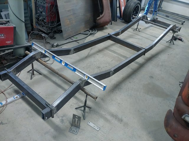

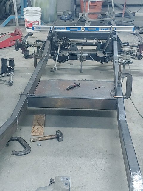

Cleared out some floor space in the shop and got started laying out the chassis.
https://i.postimg.cc/3NhK1Gx4/E98-D7...C745-E6324.jpg
Got the frame rails all bent into shape and buttoned up. Haven't decided exactly where the cross members need to go yet. I really like his technique for keeping those easy to adjust though.

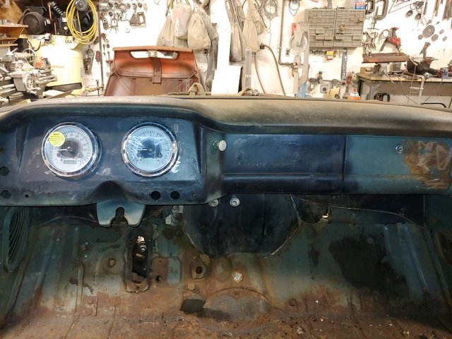

Also spent some time on the inside of the cab. Got started smoothing out the dash and figuring out what to do with the gauges. The truck had all of its factory gauges but I wanted to clean up the look. So I got a set of Dakota digital gauges for an AD Chevy and modified the dash to mount them.
https://i.postimg.cc/zGf7PPL5/44-CFD...-F97-DA313.jpg
Still need to relocate the switches. Planning to do 4 under the instrument cluster. 2 on either side of the column. I'm going to do a center console under the dash to mount the ac vents and controls. Really trying to get a minimal and clean look to the interior.

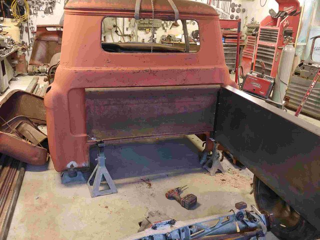

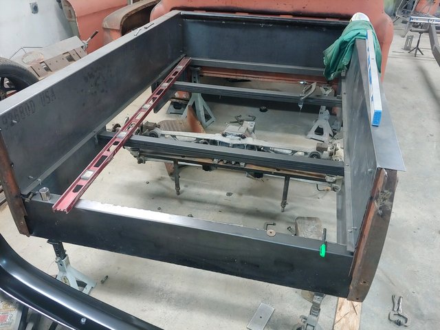

Moving forward on the bed fab.
https://i.postimg.cc/26WBKnFC/AB6877...-AD90-D657.jpg
Set the height for the raised floor to accommodate the new rear suspension. Decided to do a shorty tailgate instead of having a step up to the bed.

Some progress on the suspension as well.
Set the frame rails 32" apart and the wheelbase at 113"
Got the corvette K member installed in the new frame rails. Mounted the steering rack and started to reassemble the front suspension components.
https://i.postimg.cc/nzBFq2pf/8-D25-...A7-EE7-D90.jpg

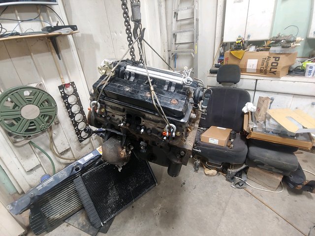

After a lot of measurements and some debate, we decided on a placement for the motor. The idea is to get it as low and as far back as possible. We were planning to cut up the firewall anyways so we ended up using the motor mounts on the corvette K member to place the engine.
https://i.postimg.cc/XN9q5jYB/BE5-AC...393-BF7-C6.jpg
https://i.postimg.cc/MKDGs9RW/22130-...-D7806-E43.jpg

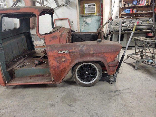

BlueChipCal 09-12-2020 08:23 PM
Re: 57 GMC / C4 Build
Originally Posted by Jason 56 (Post 8807012)
Wow, you’re making great progress. I’d check the wheel/tire placement in the front fender. They seem to lay back as stock. A lot of guys set the front tire farther forward than stock. I set mine at 115”... could of even went 116”
Good callout Jason.
We dropped the cab onto the frame to check placement and ride height. Because of the shape of the fender cutout, as you lower the ride height the wheel needs to move forward to look centered. You can see what I"m referring to in this photo.
https://i.postimg.cc/zXmvqrDg/IMG-2185.jpg
But, because we are making a custom bed I think we can move the cab back a touch to center the wheel. Then we can place the rear fenders where we want them on the bedsides and just shorten the steps as needed.
So, for anyone reading along, Jason56 is correct. 113" wheel base will be short if you are planing to use stock bed sides.

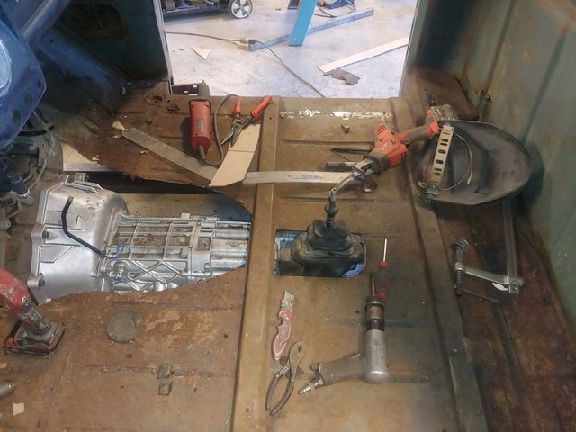

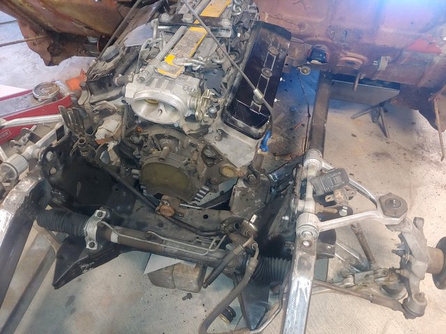

The engine is mounted really far back and we had to do some trimming. to get it to fit.
https://i.postimg.cc/vmS8kRSD/IMG-2188.jpg
I knew this was going to be the case, but it was still a bit nerve racking cutting out so much. Going to have to do some more clearancing as well if I don't want to have to lift the cab every time a valve cover needs to come off.
Sacrificed some sheet metal inside too.
https://i.postimg.cc/t4k4dn33/IMG-2192.jpg
The shifter position is not Ideal. I could probably live with it if I had to, but I think I can make up a linkage to move it forward to a more comfortable spot. I know they make kits to move the shifter internally in the housing of a T56, but I haven't found anything yet for the ZF.
Still waiting on my steering column to show up, I ordered it 3 months ago. Once I get it we can mock up the pedals and reshape the footwell around the back of the block.

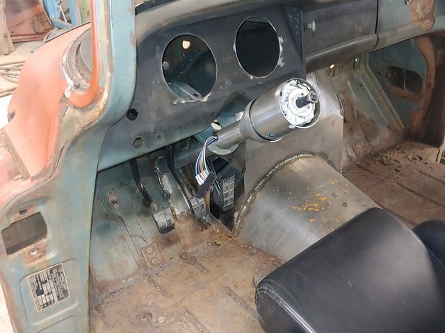

Steering column finally showed up... :metal:

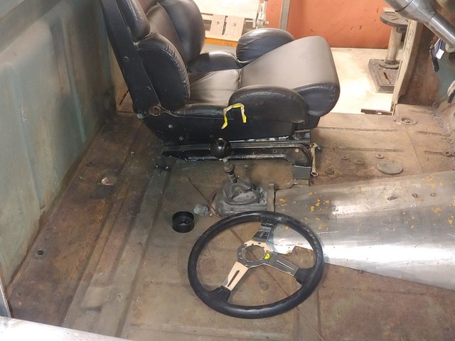

Got it installed and all hooked up. Had to play with the angle and adjust where it goes through the firewall to get the pedals to fit. Pedals are mounted and centered on the column, its tight but everything feels right.
https://i.postimg.cc/brNpthv4/F527-C...1-C6-C4242.jpg

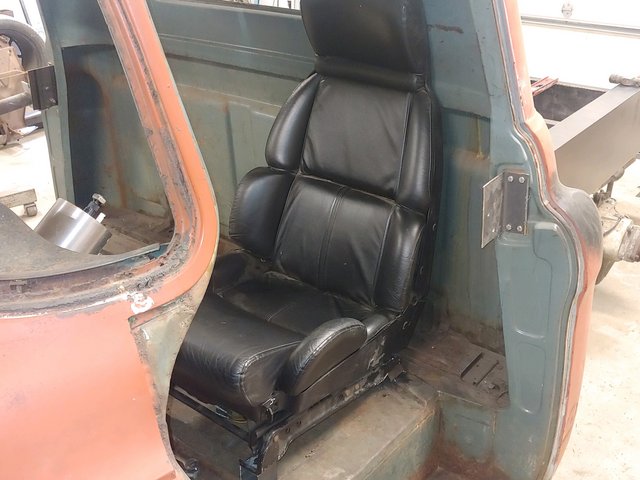

Bolted in the drivers seat from the C4. The thin back makes it so I can actually lift my leg enough to work the clutch pedal. But man is it ugly. :lol:
https://i.postimg.cc/Kz5mjzmn/DDFBA4...992-E7-FDC.jpg
https://i.postimg.cc/j5TsRNYx/C4-B1-...0-DEC28-EC.jpg
I scored a set of seats out of a cts-v thinking they would look more at home. With the added bonus of an integrated shoulder belt. They were way to thick though. I could barely squeeze behind the steering wheel let alone work the petals. These cabs are deceptively small inside. I removed the headrest and shaved a couple of inches of foam off the back of the seat to get a bit more space. Still going to need some work to be functional though.

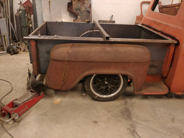

Some Progress on the bed.

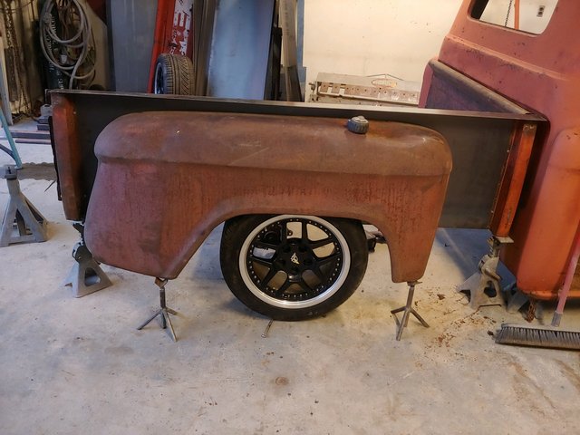

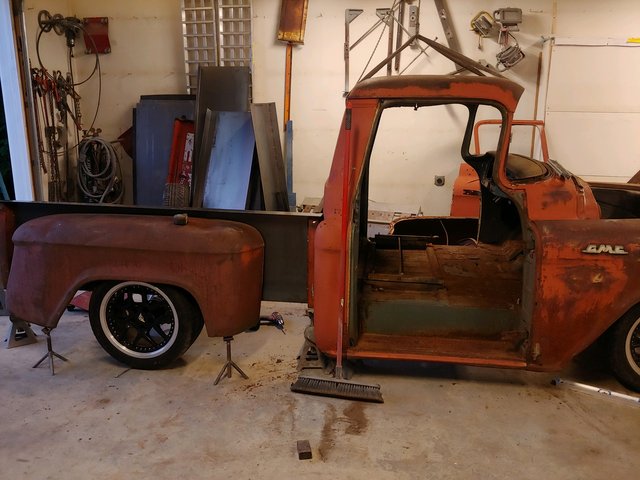

Placed the fenders on the new bed sides. Because of the short wheelbase I'm running, were going to have to take a couple of inches out of the steps to get everything to line up.
https://i.postimg.cc/L6pjGQbw/98-C4-...-B84-CA074.jpg
With these proportions, the fender looks a bit too long to me. I think I'm going to section a few inches out of the area behind the wheel well and shorten it up.
https://i.postimg.cc/jS8NwxSY/7-D1-B...69681-EDE7.jpg

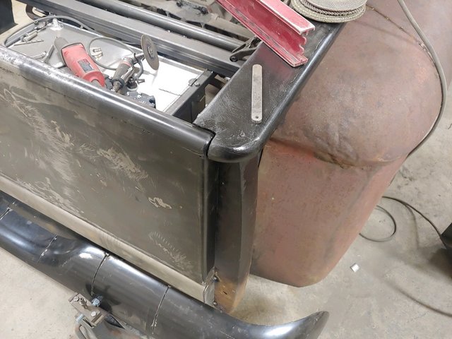

BlueChipCal 10-09-2020 10:39 PM
Made some more progress on the bed.

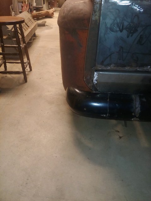

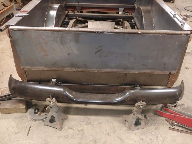

Rolled some custom mini-tubs and got those installed. 4" was enough to give me 1" of clearance on the back side of the wheel. I didn't end up narrowing the corvette rear end so I am running the stock offset wheels. I haven't picked out the final wheels for this build. Hopefully I didn't limit myself too much with this offset.

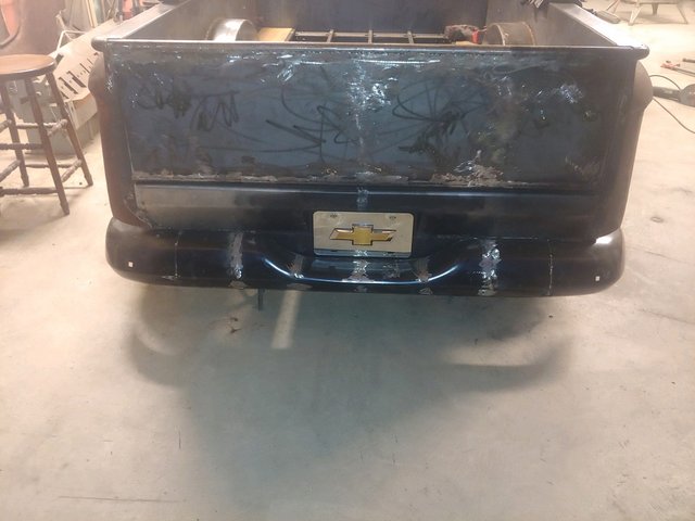

Got my new tailgate built and placed where I like it. Also mocked up the bumper I bought. It is going to need some work to get it to look good on there. I was a bit surprised to see that was curved like the front bumper. Looks like they were from the same stamp except for the license plate notch. Not sure if I bought the wrong part or if this is how they are. The truck didn't have a rear bumper on it when I bought it. I guess I'm going to have to cut it up and straighten it out. Luckily I didn't spring for the chromed bumper because I figured it would need some work to get it to fit right.
https://i.postimg.cc/cCMtsZbj/88-E93...-C65-F4-ED.jpg
Got the steps tacked back together as well.
https://i.postimg.cc/J0WBVtPZ/170-B8...C06496-CDF.jpg
Something about that detail that just ties the whole truck together and makes things feel more connected.

BlueChipCal 10-28-2020 07:39 PM

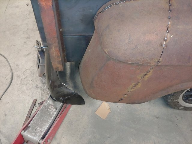

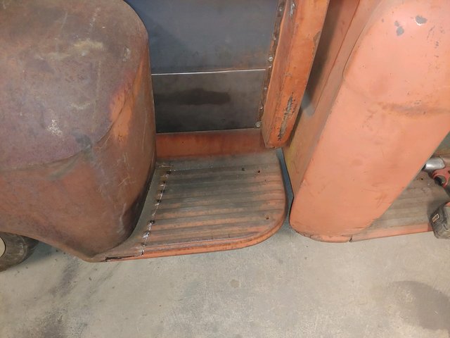

Thanks Jason. Every time I think I am making progress I take a step back and realize how much work still needs to be done. It's like eating an elephant one bite at a time.
I did get some more work done on the bed. So I'm pretty happy how that is coming along.
I ended up sectioning 4" out of the fenders. It was a little tricky with the taper but after a few tries I got it figured out.
https://i.postimg.cc/tCpVBZ1H/6-EE24...2-F4-EF568.jpg
By shortening the fender I created a gap between the bumper and the back of the fender. Not sure how I want to deal with that yet. I was considering extending the bumper to meet the fender as it did before. But, now I am thinking of doing a panel similar to the step to fill in that area.
https://i.postimg.cc/66RdjxYC/1-AE14...B7-FA43-CA.jpg
I cut some reliefs in the rear bumper and straightened it out. I'll shorten it up once I decide how it should meet the fenders.
https://i.postimg.cc/Jhnn9j89/71-C65...C3-E4-A783.jpg
Also made a roll pan to fill the space under the shorty tailgate and frame a license plate.
https://i.postimg.cc/wTX7J6Fb/83-B25...97-A447341.jpg
Rounded out the bed rail corners and notched them for the tailgate.

Quick update on the rear end. Got the bumper all chopped down. I think it is going to look pretty good with everything in place.
https://i.postimg.cc/5yG86BzN/16-B6-...-A018-D520.jpg
Rounded out the bottom of the stake pocket too.

Started Building the frame for my tilting bed floor as well. I'll post some more info on that next week when it is further along.
