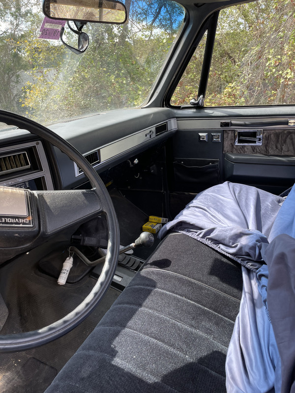

Finishing up with the restoration on my 1987 shortbed Stepside 4X4. I’ve ordered the new bed wood in pine and was wondering what color stain (if any) and what kind of UV resistant sealer to use? Trying to keep it original as possible without painting it black.

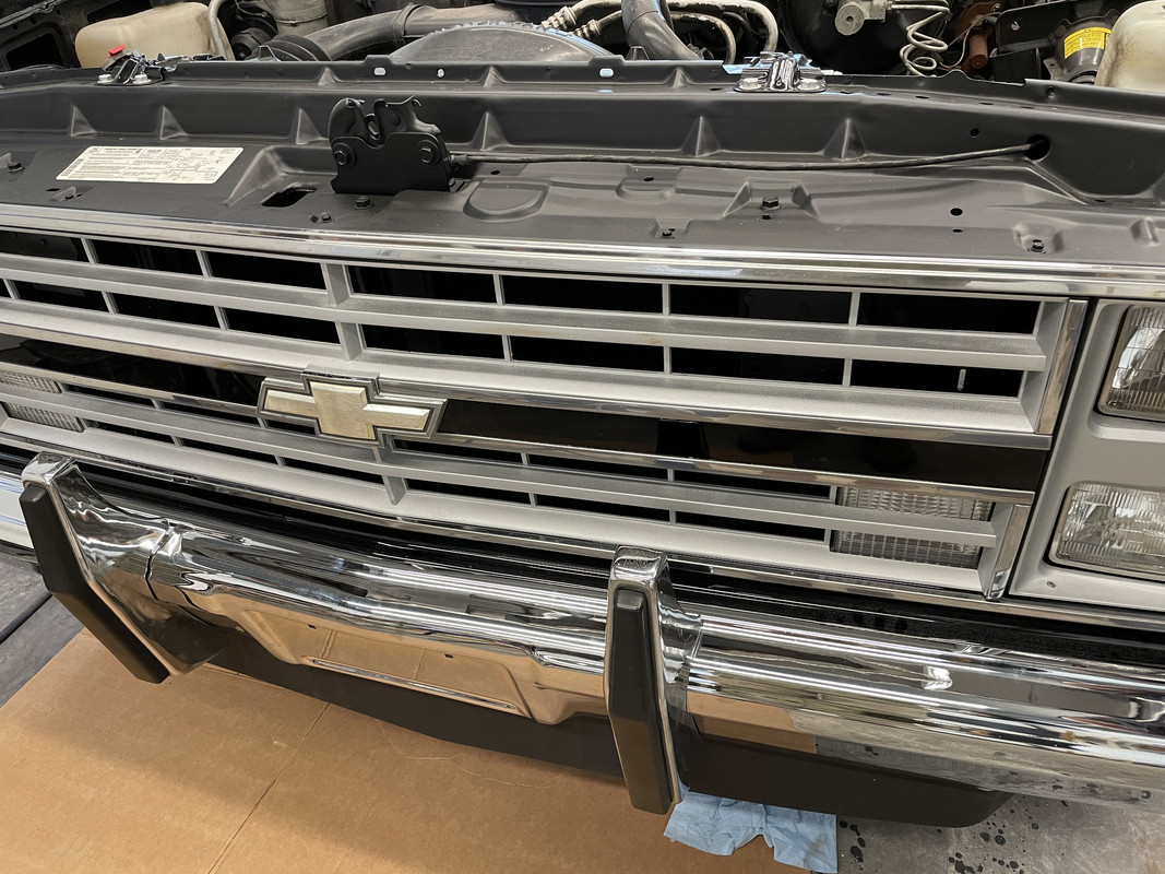

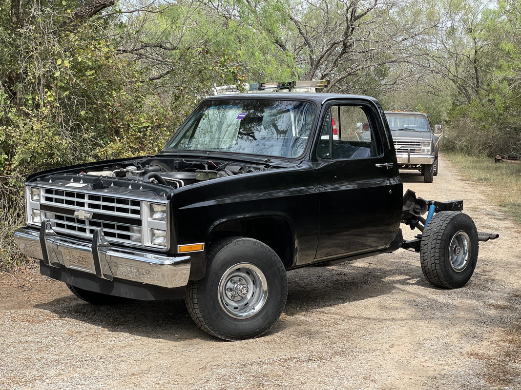

https://i.postimg.cc/sXyQP5zv/AC9-B8...C13-E62133.jpg
https://i.postimg.cc/SR1np5MM/F86339...1770-F2311.jpg

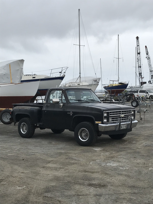

Thanks, truck was zero rust, all original body panels. We used a polyurethane single stage paint, very similar to Imron.
Prior to resto….
https://i.postimg.cc/HsNLFJJx/ED5-A9...BD3-BBC541.jpg
