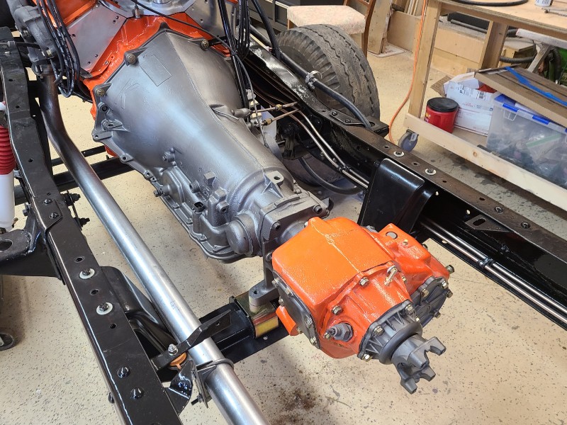

I ran my own transmission lines from Trans along frame, thru radiator support to a cooler mounted on front of radiator, bypassing radiator (as directed by my transmission guy)
My concern us there is nowhere where these lines can flex. Unlike fuel lines that have rubber hoses from frame to engine. I am concerned they will crack over time. Im Thinking of switching them to the inline tube kit that uses the steel braided flexible lines, or am I thinking too much ??

Properly routed so that your lines don't rub on anything and have holes worn in them, you should be fine. If you live in a cold enough climate, I'd personally recommend using the radiator intercooler as a heater in cold weather. As for cracking, steel doesn't work harden like copper does. There are probably multiple millions of vehicles on the road with steel trans cooler lines.

Your transmission guy is none too clever. Transmissions need to come up to temp ASAP to provide peak efficiency and minimize wear. Perhaps your trans guy can explain why OEMs use temp switches? You should have gone through the radiator and then to the external oil to air cooler. Oh well, never too late, right?
Stainless braid lines are just rubber hoses with a metal mesh sleeve. These are NOT better than steel or CuNi lines. The good news is that you appear to be using Copper Nickel Alloy, which means making lines is easy as pie! Plus they don't corrode. I'll never use annealed steel again.....
About that need for a flex joint.... Well, did you ever look at how OEMs did it? You'll notice that the lines snake around the starter (provides some axial flex) and then shoot up to the radiator at a 90 degree (provides vertical and horizontal flex). You can smash the truck into a tree and the lines will not break or leak. You will need to put a few clamps (OE work fine) to link the tubes before the 90. You don't want these lines vibrating and fatigue cracking over time.

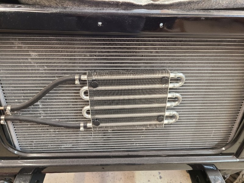

No towing with this. This is what I'm running.
No good ?

That should be fine, with little to no towing.

I would think you would want to go through the oil cooler first, then the radiator to ensure the oil stays up to proper temperature. So, in winter the cooler may over cool the oil, the radiator will bring it back up to 180+ degrees before going back into trans.
In the summer, the oil cooler will shed some heat before going into the radiator which will give the radiator a fitting chance to cool it down further.

this right here will keep trans temps in optimal range for efficient trans operation..
the factory coolant over trans fluid cooler stabilizes the operating temperature where the air over trans is going to have a wide range of effect depending on ambient air temp and air flow..
the objective isn't simply to cool the trans down to lowest temp possible - the objective is to prevent over heating above normal operating temp..
the aux cooler in front reduces the heat rejection effort of the factory cooler..
also consider an external spin on filter on the hot side in the frame.. oil filters better hot with less flow restriction and contamination is a trans killer..
