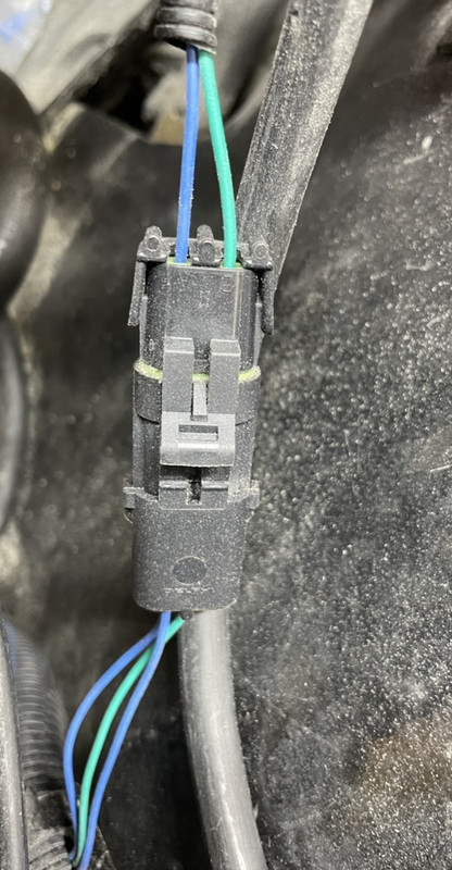

On my swap, I had a custom built 3 relay harness made to go with my radiator and electric fan conversion. After reading the replies I went out to the shop and saw the harness guy made it easy for me…there is a small harness that has the green and blue PCM trigger wires that run with the main relay harness.
https://i.postimg.cc/R0Vnhxkr/155807...09-AFFCAF2.jpg
The 2 wires at the top of picture run to the PCM, bottom 3 wires towards relays for reference.
I’m thinking I can pull apart the Weather pack connector and bring the trinary wire into the end with the 2 blue wires, combine the 3 blue wires, recrimp and plug back in.
Does that look like it will work?
