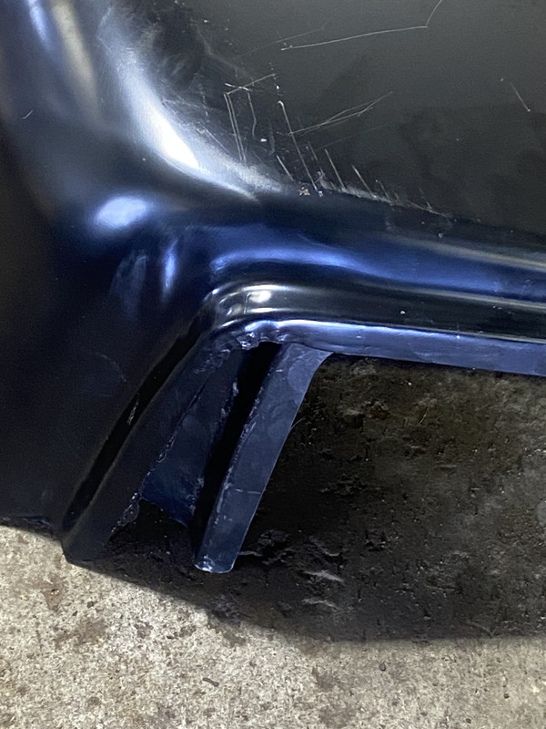

this is one of the things that is giving me the fits: both cab corners have this and its no-where near the contour it has to be.
https://i.postimg.cc/GhCHyZH0/IMG-0336.jpg
Usually the rust doesn't go that high on the cab corner and that part gets cut off.
Try to only use as much of the patch panel as you need to replace the rust.
I got a drivers side floor panel and only used about a 3x5 inch piece of it.

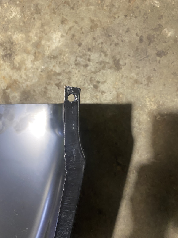

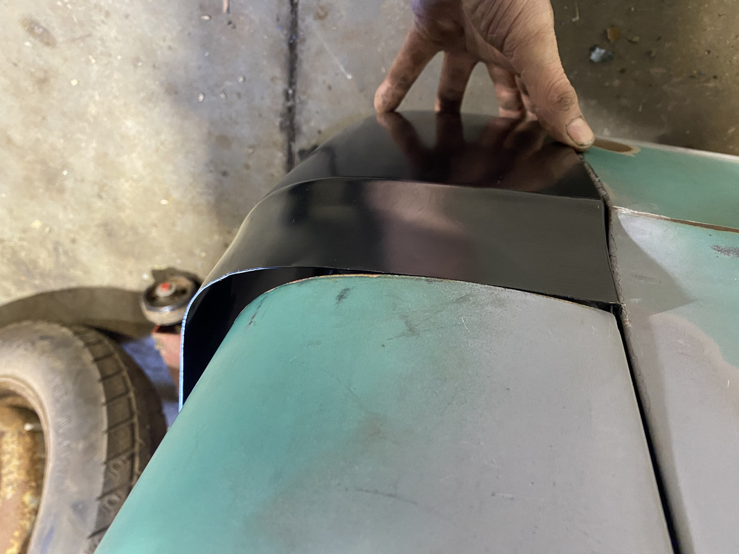

Well, as mentioned no cab corners are perfect, but at this point i wouldn't even call most suppliers acceptable. Since they are cheap i got 4 different kinds of cab corners just to experiment with and i am now resorting to buying a used piece for the fit I like for the body line 1/4 way up from the bottom of the door/corner and using after-market metal for the very bottom. Because they are cheap i suppose quality suffers too. The best advice is to limit the amount you remove. Im restoring a 69 Firebird with my brother as well and parts quality is much better.
example of one of many issues:
https://i.postimg.cc/3J9zfJ0Q/IMG-0378.jpg
