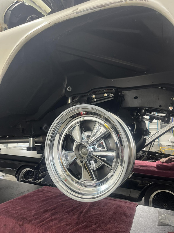

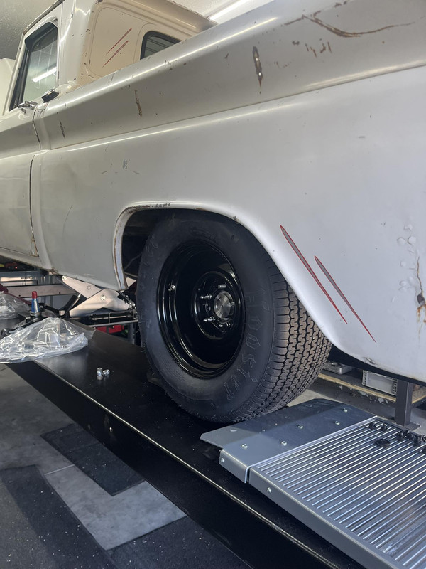

sackracing 03-23-2025 08:59 AM
Re: 1966 Gasser Build
Truck had CPP dropped spindles and 2 inch dropped springs.
Went with stock height spindles and Moog 6454 springs. I don't want to commit to a straight axle yet. And if I do a drag and drive week I'd rather do the 1000 mile drive with stock style front suspension.
Swapped to the CPP 5 lug front rotors and rear axles
https://i.postimg.cc/LsHHTmgg/482030...17035789-n.jpg
https://i.postimg.cc/4xvfVYyT/484223...94899909-n.jpg

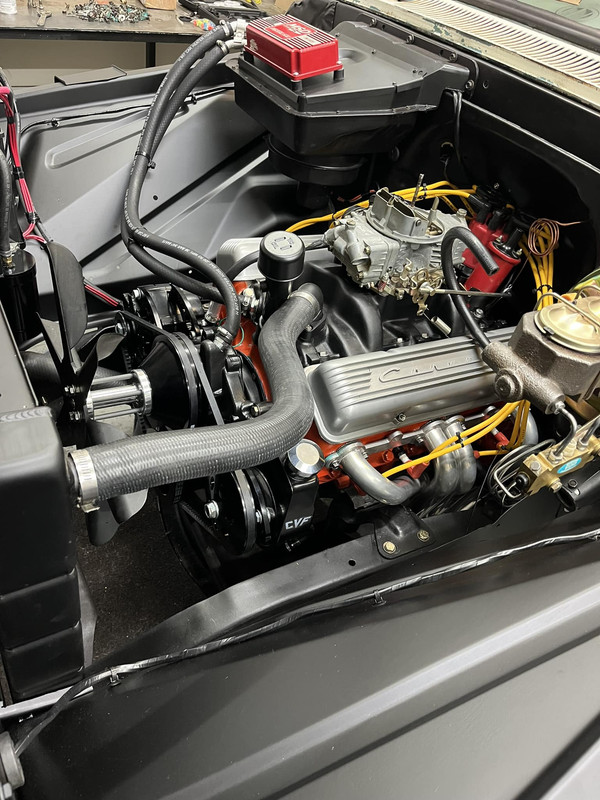

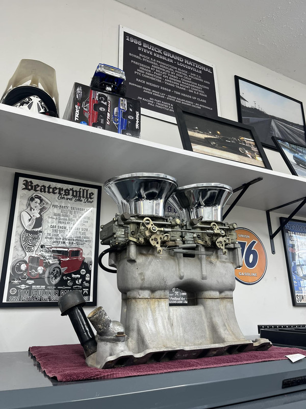

sackracing 03-23-2025 10:35 AM
1964 L79 327, Holley 750. It has a pretty nasty roller cam with comp valvetrain. Heads have been ported. MSD billet distributor and ignition box.
Currently has a saginaw 4 speed, but I'll be installing a TH400 this summer with a PTC converter.
I picked up a era correct Edelbrock tunnel ram with two 390s that had been sitting on a shelf for 50ish years.
https://i.postimg.cc/QxpX2f53/415939...60084679-n.jpg
https://i.postimg.cc/9F3mg6Db/468806...58356915-n.jpg

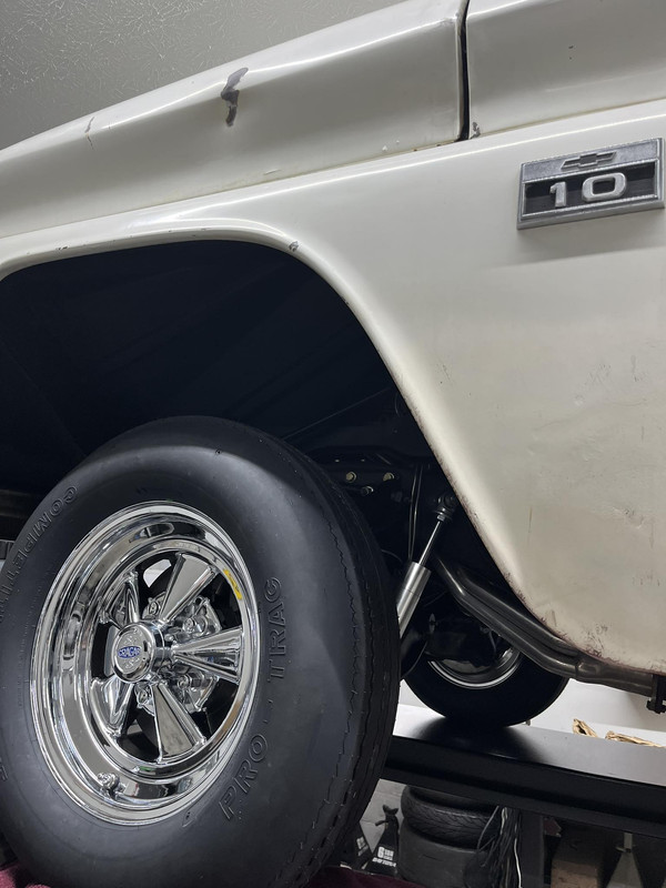

rbruno68 03-24-2025 09:18 AM
Looks like a good build. What rear tire size did you go with? They look like they fit the wheel well just right.
rbruno68 03-25-2025 10:46 AM
What brackets did you use to sling your alt on the passenger side? I have early double hump heads without the bolt holes. I think I will keep mine on the driver side, but need to mount it low like yours.

motofly196 03-30-2025 11:17 PM
Alan Grove will have exactly what you need. I'm using his Driver's side Alternator bracket, and Driver's side Power Steering pump bracket. They fit perfectly out of the box.

sackracing 04-09-2025 07:13 AM
275/60 Hoosiers
sackracing 04-09-2025 07:14 AM
It's a CVF kit, they had the setup for no accessory holes

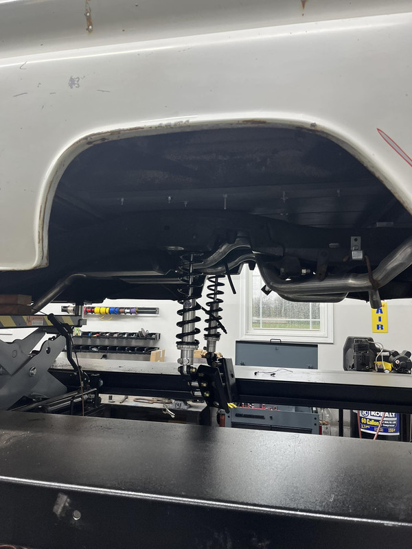

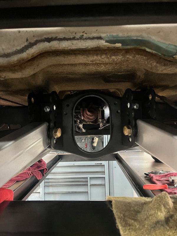

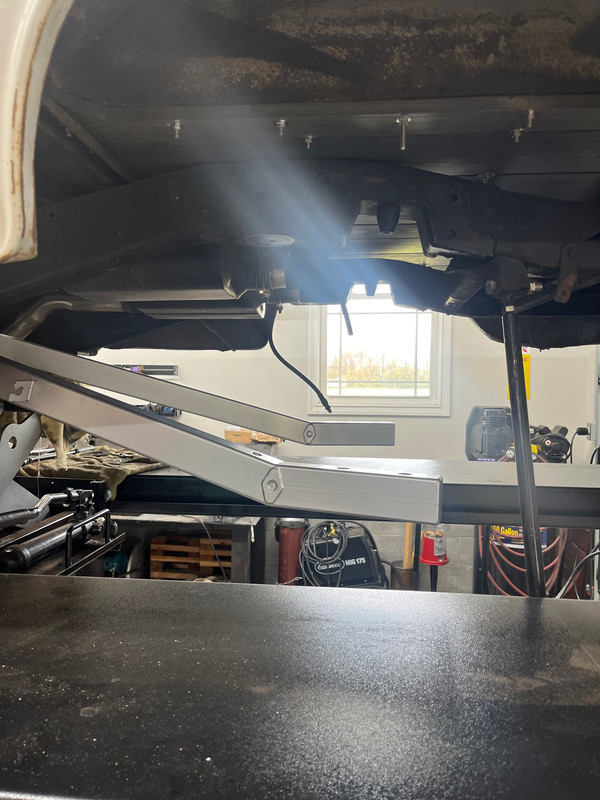

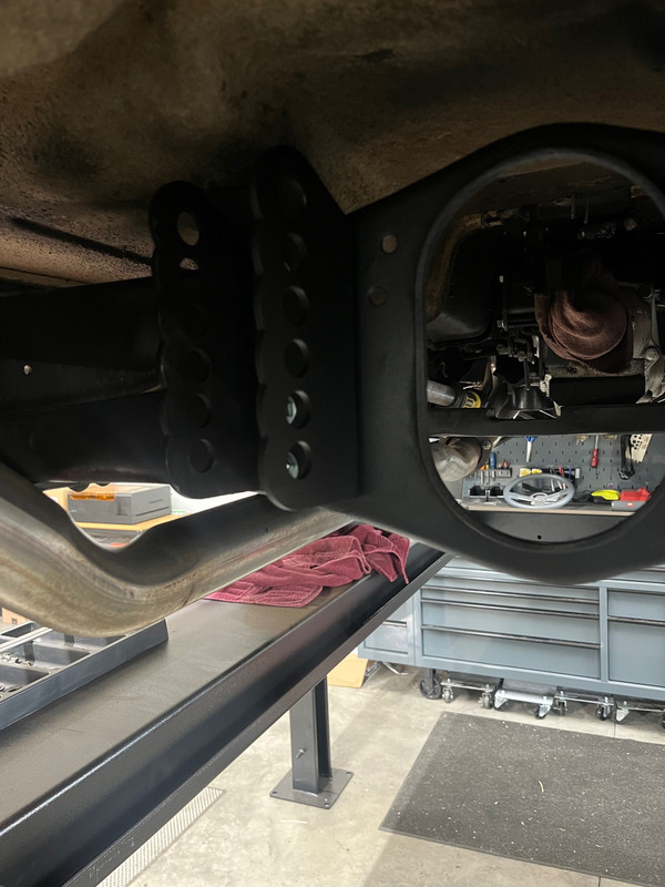

sackracing 04-09-2025 07:20 AM
Pulled the 12 bolt and sold it, and removed the factory trailing arms.
Ordered a Quick Performance 9 inch with the pads already on it for a C10.
Also ordered Moser box tube trailing arms and multi position brackets for the stock xmember.
Installed CPP coilover kit with double adjustable Viking shocks
I'm getting pretty good at getting rivets out...
https://i.postimg.cc/zXD7cxWZ/488886...11819565-n.jpg

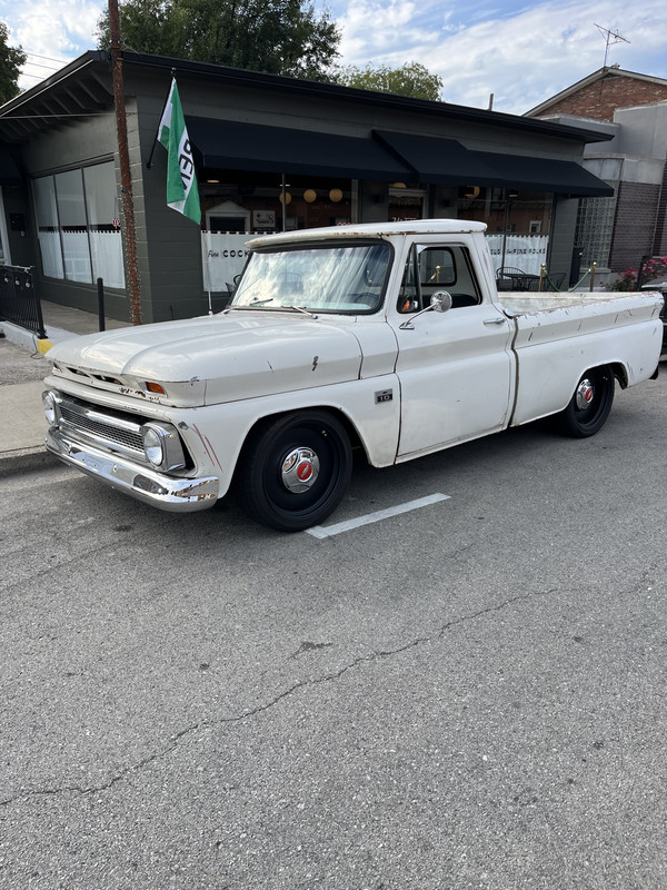

sackracing 04-13-2025 03:42 PM
https://i.postimg.cc/Kjzcfjy3/IMG-3748.jpg
https://i.postimg.cc/h4ytjL9L/IMG-3750.jpg
https://i.postimg.cc/brByBPzC/IMG-3749.jpg
