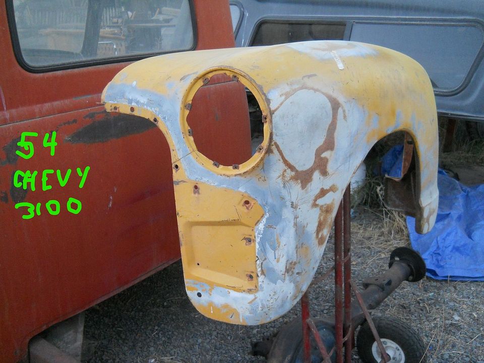

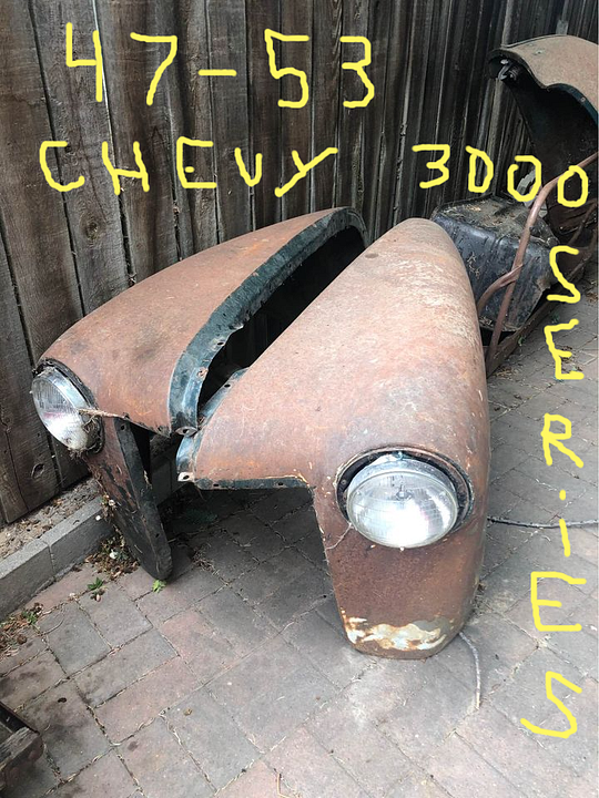

First photo being 47-53 3000 series
https://hosting.photobucket.com/c5e8...720&fit=bounds
This being a 54 fender with the rounded corner for the grill and the indent for the park light.
URL=https://hosting.photobucket.com/c5e80f58-8b3a-4ad3-b9a8-69c8e75f6874/a3024dd7-efe5-47c4-9b99-9609fa6ea182.jpg?width=960&height=720&fit=bounds]https://hosting.photobucket.com/c5e8...720&fit=bounds[/URL]
If you are out looking at fenders off the truck these two photos are how to tell a 3000 series fender from a 4000 (big truck) and larger out in the wild.
Note the difference on big truck fenders.

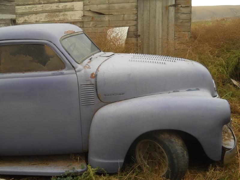

A few years ago some guy on FB bought a big truck nose for his 3100 a couple hundred miles from home that someone swore was a 3100 front end and didn't figure it out until he got home.
This is my 48 with a 4000 series hood sitting on it to show the difference
Here with it's own hood.
