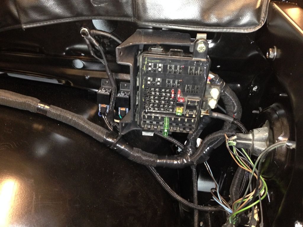

Here are just a few shots I snagged over the weekend. My Dad got pretty much all of the nose put back together.
as well as another buddy and I got the wiring wrapped up. Should be ready to try and fire it up on Wednesday evening. I just need to open up HP Tuners and flash out the Vats as well as change the fueling strategy over from PWM to constant supply.

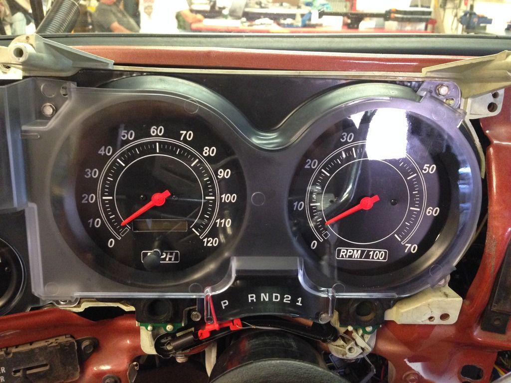

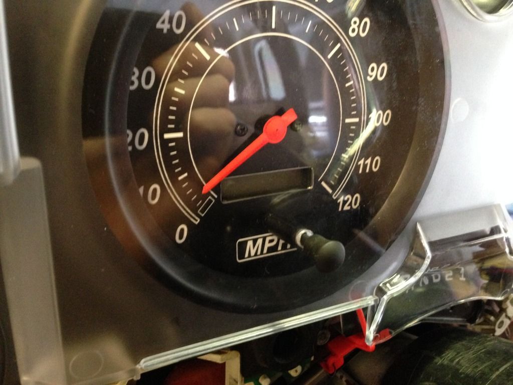

I was able to finish up the gauges yesterday. I know many were wondering what they'd actually look like. And just to circle back. We needed a digital speedo for our VSS signal, as well as our stock tach didn't work. Rather than buy replacements for the stock style we decided to upgrade. These new gauges also allow us to have a trip which is nice.

Those look great. The volt, oil, fuel, and temp look original except for the needles on the bottom two. Who makes the cluster? Are the "small" gauges original or part of the new cluster?

The cluster is stock GM. I basically sliced and diced it up and made new faces for the Speedo and Tach. Then I took the movements out of those aftermarket gauges and put them behind the new faces that I made. I could have used the Auto Meter 5" faces but I really just didn't want it to look like aftermarket gauges. I wanted it to look factory, or maybe a version of factory. These don't immediately jump out at you as an upgrade.
The fuel and temp gauges are Auto Meter movements put behind the stock guage faces (And these are really simple to do. The screws even line up with the stock holes for the faces so it's so easy a cave man could do it... You can see some pics on Page 2 I believe. I had to use a 33-240 ohm gauge to line up with my GM sending unit. Then the Coolant temp came about because I was having way too much trouble finding a sending unit that would work with the stock gauge, and also be able to install in to the LS engine. After way too much research I said "F" it and just ran an auto meter movement and sending unit. To get the needle back on I waited till the engine was 205 (read through the ECU) and then stuck the needle on straight up. I've got a 195 stat so it should hover around this temp most of the time in Phoenix.

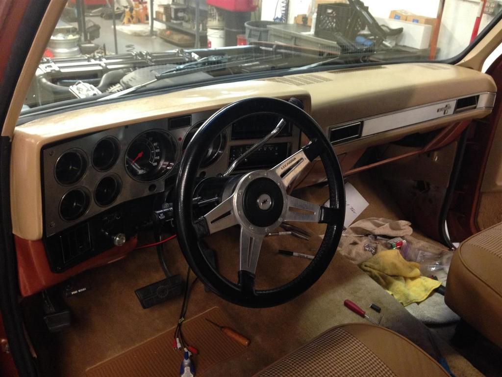

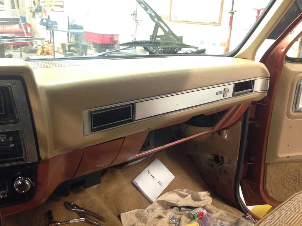

Well my Dad and I got the dash pad and cluster trim put in yesterday along with our Retrosound Model 2 radio. Radio wasn't too hard but we did have to grind a little here and sand a little there to get it all to fit correctly. Not a big deal but was hoping it would just "fit" for the price. Next up is 1 or two final wiring bits and then take it to get an alignment.

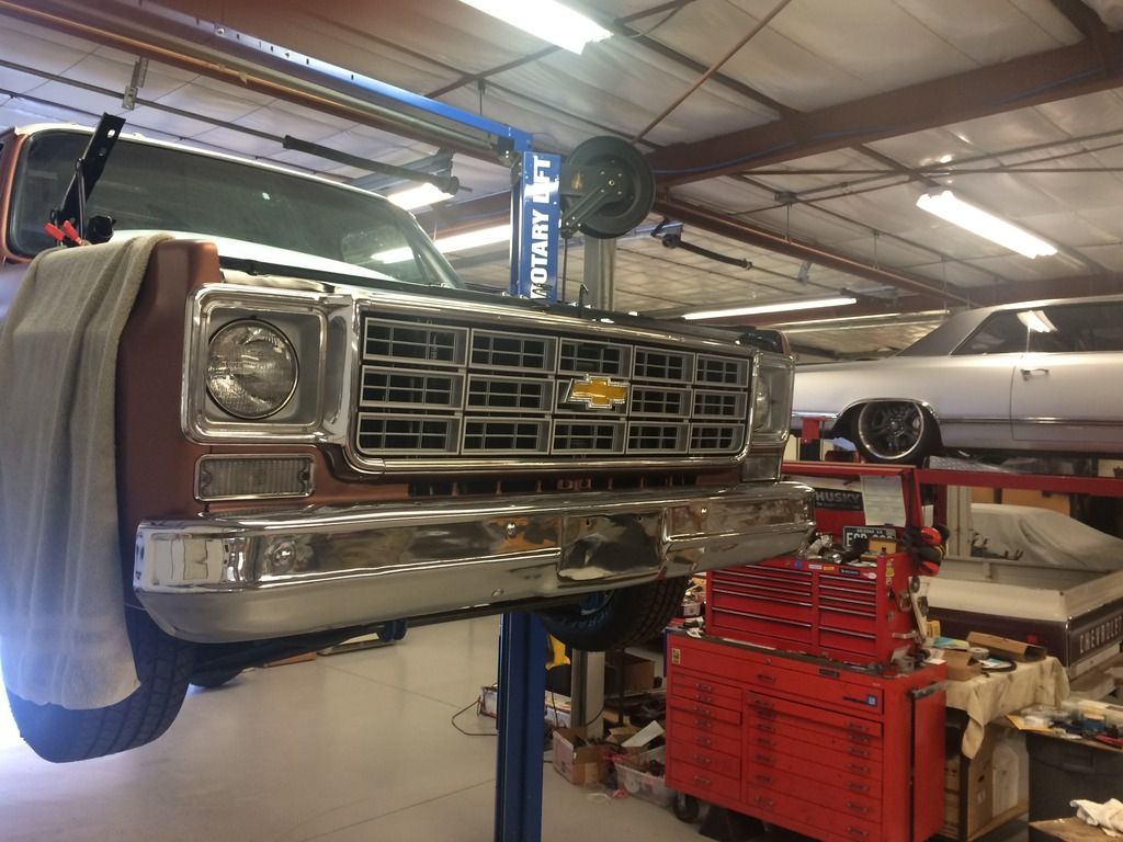

Took the truck out for a drive last night around the block. We still haven't got it aligned and other stuff like that. Nor have we emission'd it yet. However, the woefully low oil pressure presented it's self even more. At 1 point I saw 9psi on the ECU which takes it's reading from the top of the engine. I was seeing 15psi at the bottom. So I think this project is on hold until we can pull the engine apart and see which bearings have decided to go on vacation and not come back. Really bummed but what are you going to do. Live and learn. I trusted the seller and saw the vehicle running but didn't put a gauge on it and check it. Won't do that again.
Either way, after doing the driving I wanted to do the Fast Learn on the transmission and the first step it asks you to apply the brakes. We'll I did and it never received that signal so I guess I need to look into my wiring on that signal and see whats up.

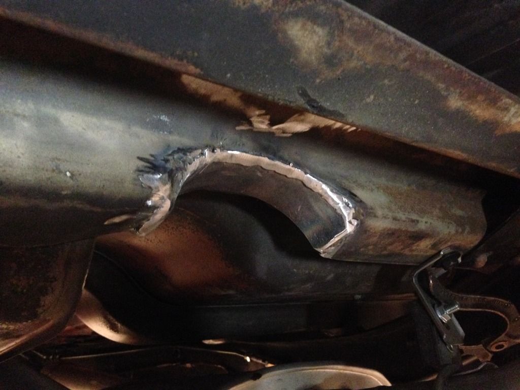

Also, after getting back and putting the truck on the lift I saw a mark on the drive shaft. It was just kissing the frame near the back. So, I quickly cut out the offending piece and put a small notch in it's place. Then I cleaned it up and painted it black after this.

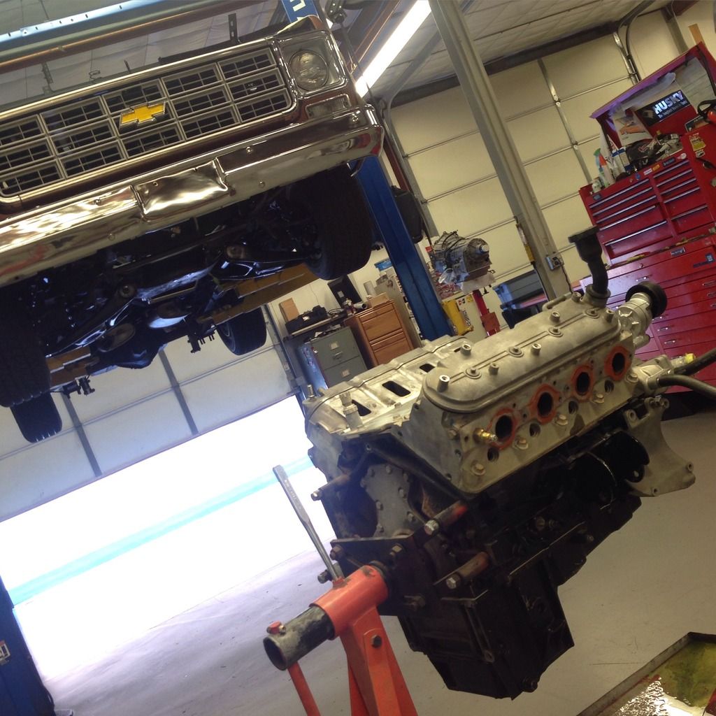

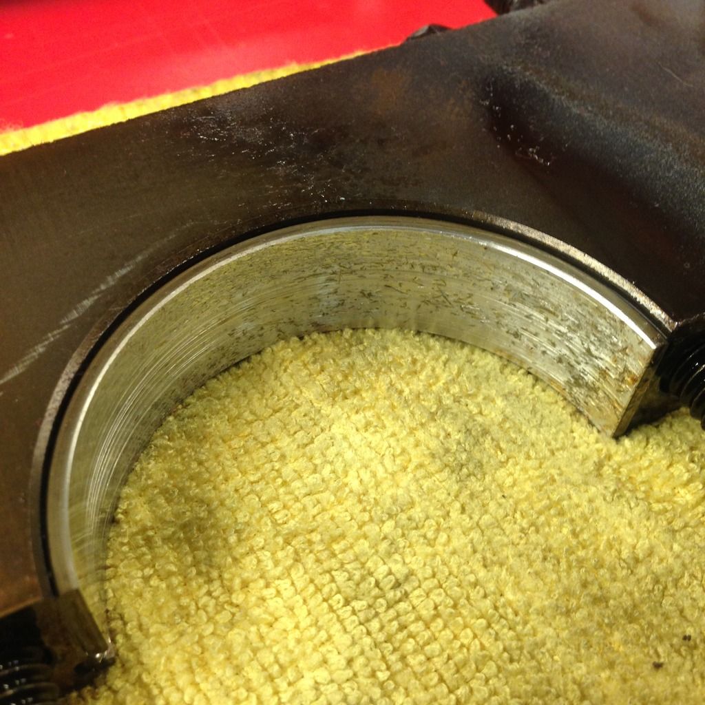

Well with the oil pressure as low as it is, we decided to get the 6.0 pulled out. The PO told me it had about 80k miles on it. Well, I think he must have forgot to carry the 1 a time or two. There isn't even bearing material left, it's just the backing material. What I didn't get pictures of was the rings and how caked they are. We couldn't even rotate the oil ring and the 1st and 2nd ring are so bad we slipped the piston right back into the hole with minimal work.
