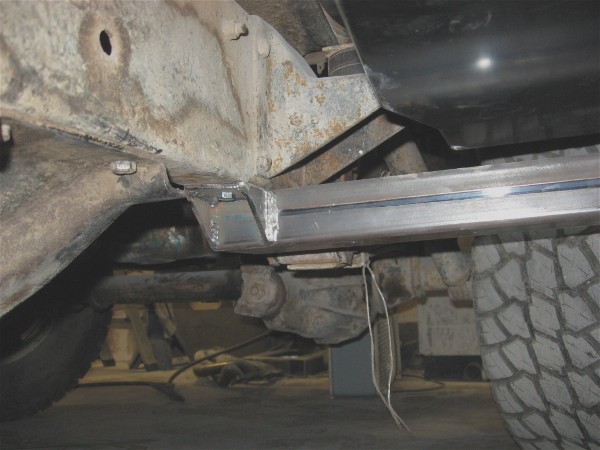

Great progress report!
Will the cage be tied into the frame or bolted to the tub for the final install?
How'd you build/mount the rock sliders? Any better pics of em?
vtblazer is offline   Reply With Quote
When I had the cage in my orange blazer it was just bolted with 6"x6" plates on the bottom. After a summer of hard wheeling in the rocks with no top, my rear body body brace/u channel (below the tailgate) was bent downwards outside the framerails. Presumably from climbing rocks and putting downward pressure on the rear cage legs. When I put the top back on it would not seal towards the back of the bedsides. There was about 3/8" of daylight between the top and the bedsides! I'm not going to "wheel" it like did the other one, but plan to attach it to the frame. I will post pics of what I came up with.
I will also post some good pics of the sliders and how they are mounted as well.

Here are some pics of my "rocker savers".
I mounted it to the frame at the body mount locations thinking that would be the strongest point. The outer rear tab will mount to the outer most rocker end cap bolt. A very strong location as well. For the front tab I will weld a piece of flat stock with a nut welded to it inside of the rocker box.
Hopefully these will work for that ocassional rock or log that that I drive over against my better judgement.LOL!

Finally making progress on the Blazer again. I am currently getting everything mocked up, as far as the chassis goes. I installed my springs,axles,shocks,etc. Got my 73 up gas tank and skid plate installed.
I've got the exhaust almost finished. I haven't decided where the tailpipes will exit yet.

Finally making some progress again. Right now I am trying to get everything to do with the chassis mocked up.
I got the axles,springs,etc. installed. I have most of the exhaust figured out. I'm not sure yet where the tailpipes will exit.
