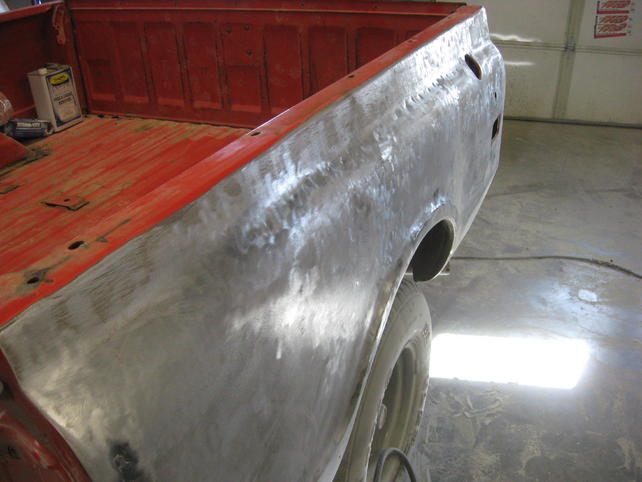

Bedside has lots of damage, and previous repair work. Front of bedside is pushed inward. When the cowl was jacked ahead, they went a little too far.
Bexside is a lot worse than the pic shows. That is my sons dog, Buddy. He was inspecting the blazer. I'm pretty sure he's thinking "quit screwing around, you got lots of work to do!"

My oldest son wants to learn, so I let him do some paint and mud removal.
He understands that we all have to start at the bottom, where there isn't much glory! LOL!
