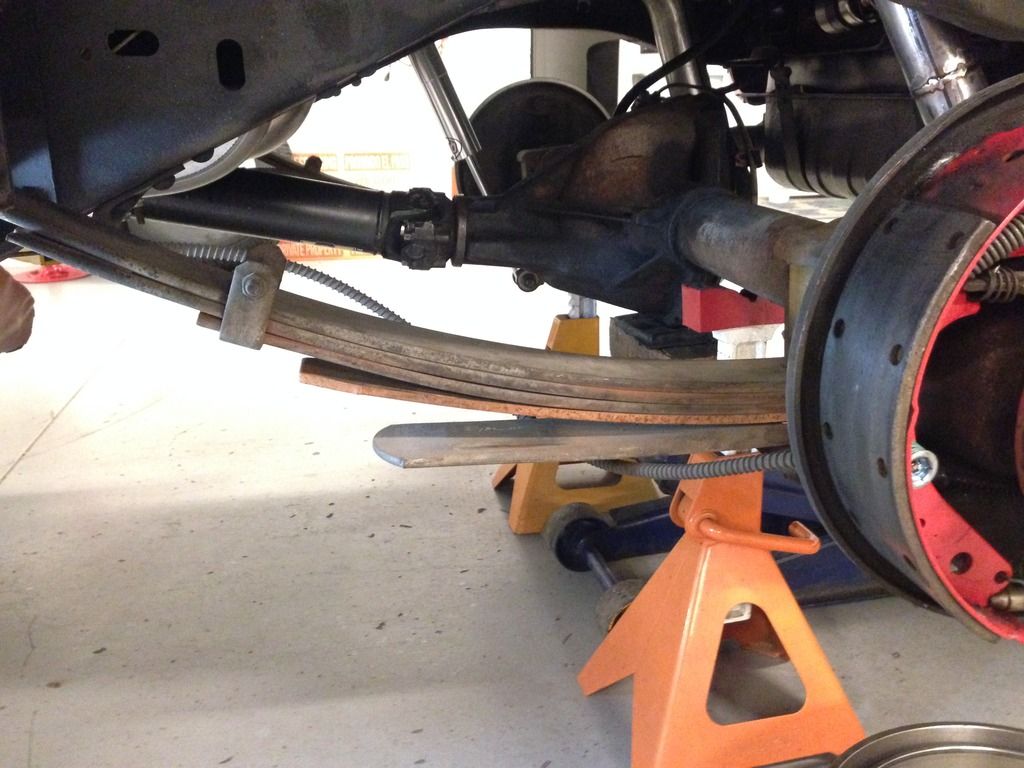

Just a small update. I ran over to my buddies house and picked up an extra pair of leaf springs he had in his shed. Well, they are much longer than the one that I've got! Like 4" longer! So, I decided to just pull one leaf out of his pack and add to mine in an effort to raise the truck a couple inches.. I'm not sure if 1 leaf will do it so I'll just have to trial and error it I think. I was only got one side done last night but this weekend I will get the other side done as well. before I left I sprayed the other side with PB blaster so it should all come apart easily. Side note, someone installed the front spring eye bolts before they put the body on the frame so the bolts were going the wrong direction. Nothing surprises me any more...

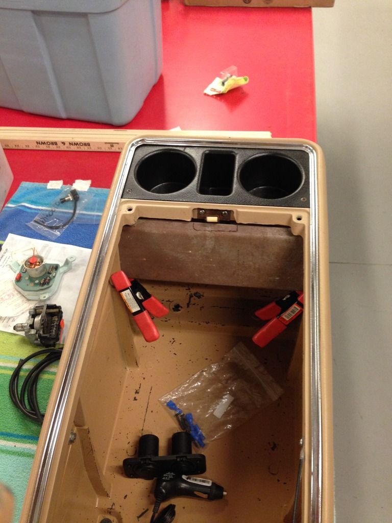

Another project I'm working on is adding a small panel in the console to hold a couple cigarette chargers and a USB charger. I also have an XM roady head unit that I'd like to mount on here. Once it's all don'e I'll sand blast it and paint it the same color as the console.

There were two different length leaf springs. 52" and 56".
Blazers had the 52" version.
And that bolt you're talking about was done that way at the factory.
I alway push them out a little and cut the head off, and remove it the easy way.
Cost the price of a new bolt, but saves a lot of time and agony.
Keith
Convert to disc brakes.
Old 07-28-2016, 10:14 PM   #95
phillipm
Location: Scottsdale, AZ
Posts: 465
Wow that's crazy to me! I've got it in the other way now so good to go I guess. Thx for the reply.

If my memory is correct the bolt was done that way as a safety precaution so that if the nut came off the bolt couldn't back all the way out.

That's crazy. Guess we'll never really know. I've owned dozens of Camaros and other gm leaf sprung cars. Never run across that ever. Thanks for the reply.

Just another quick update. I got the leafs all finished. Just as a recap I added one leaf between my bottom and helper. It seems to have raised the truck about 3/4" but has also raised the spring rate so it doesn't sink down so far with fuel in it! Over all with the new front springs and the new rear leafs finished it drive and rides awesome. I drove in to work today and didn't bottom out or hit my control arms even once. Also my tires don't hit when I turn anymore either. So that's a double bonus.
