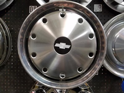

Re: My new truck/project '88 Cheyenne 3500.
Probably not the look your looking for but I remember most of the early C2500's that I saw tended to have full hubcaps like these. At one of my jobs in the late 80's we had a 88 C2500 fleet truck that didn't have A/C or a radio.
Look like these....
