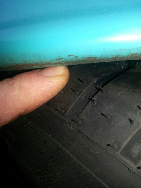

So loving my new transport wheels!!!!!
So I finally got em.... and made em fit like I want!
Just finished making it possible to fit these GM Transport wheels on my 64.
Tires: 285-40-22 (all 4)
Static drop:
Front: 2.5" drop spindles / 2" drop springs
Rear: 5" drop springs / 2" drop blocks
Front mounting:
Disc brake conversion up front: Has the correct size hub dia. for these wheels
(Orig front drum "centric hub" on the drum is too large for these wheels and either a spacer is needed or opening up the bore on the wheel is needed)
Rear mounting:
I was given some 1-1/2" spacers for the rear. SO I used them of course.
(I would suggest a 1" or even a 1-1/4" at the most ****STEP SIDE BED*****)
Now all of that said... I love the look of filled out wheel wells. (width wise as well as diameter wise)
Its because of this and the fact that my spacers were given to me, that I ran the 1-1/2" spacers in the rear. I have roughly 5/8" between the inside of my tire (285-40-22) and the bed side (STEP SIDE BED).
I had to make adjustable fender struts to push the fenders off of the outer edge of the tire. I needed roughly a 1/4" to get off the tire, but adjusted it out about a half inch total, leaving a very tight 1/4" gap.
The front tires with the mentioned static drop will turn lock to lock with no clearance issues. The closest item to touching is the manual steering gear box. I also have a CPP sway bar and it clears that just fine as well.
Where I am closest and have rubbed (under full compression from large bump in the road) is to the floor board at nearly full lock at either side. The other place it is very close is at full lock in the center of the fender opening (fender lip). At full lock I can barely get my pinky finger between the tire and fender. This just causes me to enter driveways a lot slower, but hasn't been a major issue.
Here are a few pictures.
I have always had a "muscle truck vibe with my truck and wanted to keep it. Hence my tire choice. I feel I manged to keep the "tough" look I like.
Front fender clearance (wheels straight) Disc brakes..... so no spacers
This is all the room I have when turned to "full lock" under the fender lip
Closest spot to touch: Floor board at nearly full lock
This is the clearance to the bed side. Looking forward from rear of truck.
Adjustable fender struts (1 in front of the tire, and 1 behind the tire) This is the passenger side looking from the back of the truck.
