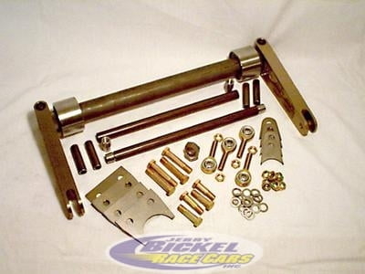

Getting it ready to install. Went with a quartermax 2” splined kit.
