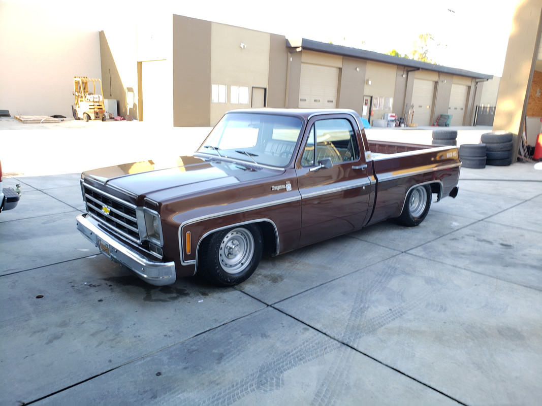

my daily
btw no bags

Good looking truck!
It will be asked: How was the drop done? What are your parts specs/tech info?

front:
3" spindles
1 coil cut off stock springs
2" sectioned crossmember with 3 degrees of caster added
no limit rack and pinion (do not use bad bump-steer)
inner fenders raised
rear:
stock long leafs
flip kit
4" shackles/hangers
small c notch
I drive this truck every day and ride quality is pretty good.
