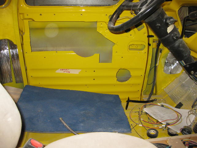

i'd definitely seal off the drain hole, you'll want to keep the cowl dry, since your not using the kick vents
allows you to recess the kick speakers, i cut out the whole area around the vent with a plasma cutter
if you do that hang on to everything and pass it on to a restorer, a lot of that stuff isn't in the catalogs
i gave away the doors, grills and cables, but scrapped the sheet metal i cut out, it isn't available anywhere
if you still have the kick vents, remove the grill and door, reach your hand in above the rain baffle
mine was full of pine needles, leaves and dirt. probably half a 5 gal bucket from both sides
that gunk is what rusts out the door hinge pockets and leaks from above rust out the floors
the cowl vent is probably the most destructive thing on our trucks
not the best pics, but you can see how much vent i cut out

I removed the trap doors and checked for crap when I remade the lower side drain pocket. The lower pocket was blocked and rusted but up by the vent it was clean as.
I sprayed up into the pocket and down from the cowl before remaking the lower drain area .... so it's all painted now in there.
I then refitted the trap door and sealed it to the kick panel. Hope that makes sense.
