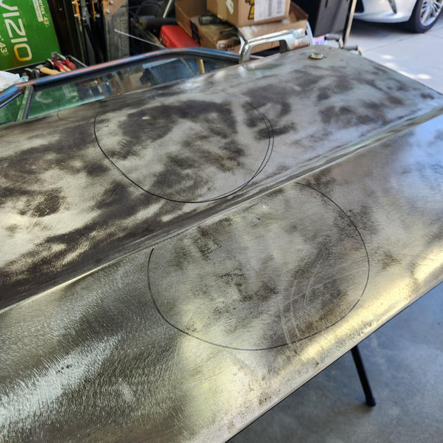

Saturday morning I decided to get the last of the glaze coat on the filler on the back of the cab. Put a few more skim coats of filler in the interior and the two small screw holes I welded up on the roof next to the cab lights. Moved onto the lower Captain's side door rubber trim that I formed a few days ago. Got it all fitted and welded in without any issues. Then gave the Drinker's side upper rocker the last skim coat of the body 3M body glaze.

Been working on getting all the areas with filler sealed off and scratches from sandpaper filled. Little by little the old Devil Cowboy is starting to come around. Was able to get the corner of the cab by the gas tank looking good and both rocker areas. Had one area on the other corner that showed up after a light coat of primer.

Here are a few pictures of the driver's door exterior side being finished off with filler and some primer to find a few low spots. Luckily the filler work did not take up too much time to get it looking good and straight, very happy with how that turned out.
While I was working on the door I decided to get the front hubcaps that I have been removing rust from cut out to go over the locking hubs. Went with the 4.5-inch hole saw so that it will clear the Spicer hubs when they are changed out.
Pict 1 - Driver's door primer over filler to check for high or low spots

Flipped the door over and started to investigate what needed to be fixed besides dings and dents. Found a few items that will need some attention before I can move on to the filler work.
-lower door rust that is fixable in three locations
-someone welded the area around the upper hinge and left the welds unfinished
-both areas where the upper door frame is attached to the door have also been welded and left rough weld
-four or five areas need to have the stud gun work to pull up some low areas
To get moving in the direction of repairs I need to gut the inside of the door so I don't damage any glass, and besides the window regulator was toast. I had the door up on a folding autobody stand and did not want to lift the heavy door to the ground so I could remove items. I slid over the six-foot plastic folding table next to the stand and slid the door onto the table. removed all the screws in the door so the guts can come out. then began removing the internal items, locks, door handle, window regulator, and wind wing vent. Then it was easy to slide the door back onto the autobody stand.
Here are a few pictures of the areas to be repaired.
