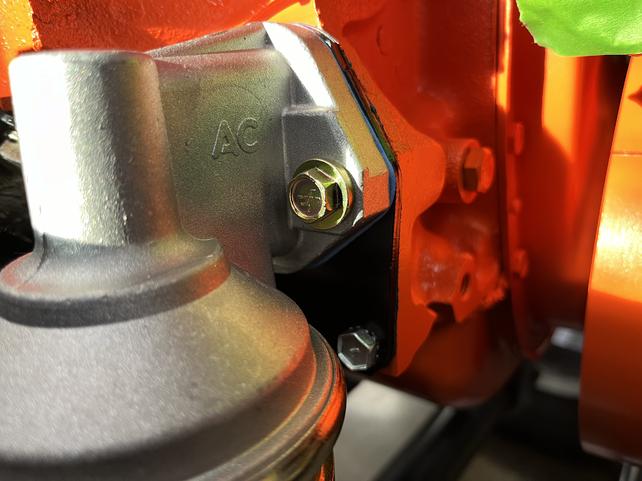

One final pic tonight. This is not an NOS or rebuilt fuel pump, but a new reproduction. I do like seeing that AC on there. But also the original refinished hardware. The "f" bolts and "L" bolts. Love it.

Nice progress sir. The bolt affixing the fuel pump looks to have a real nice finish. Those bolts are neat.
