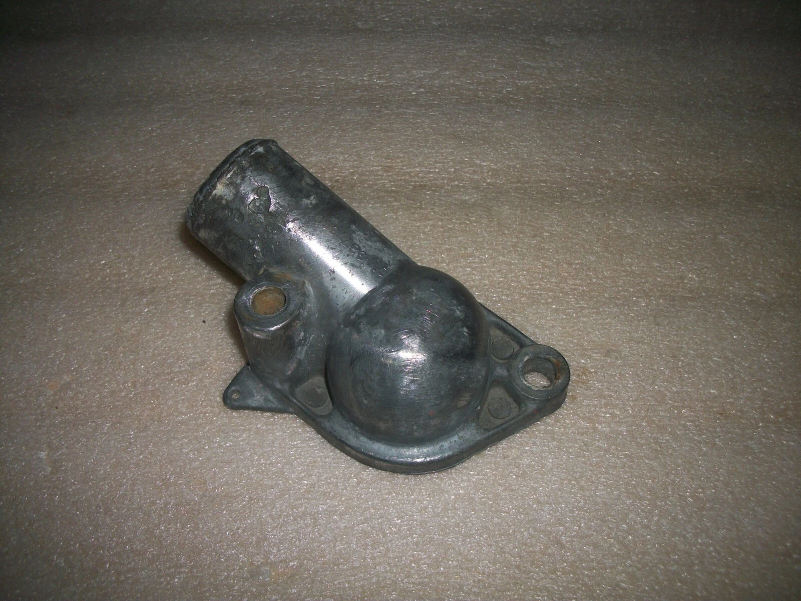

The original housing on my 1970 Blazer part number 3877660 is casted with that provision.
File pic not mine:
