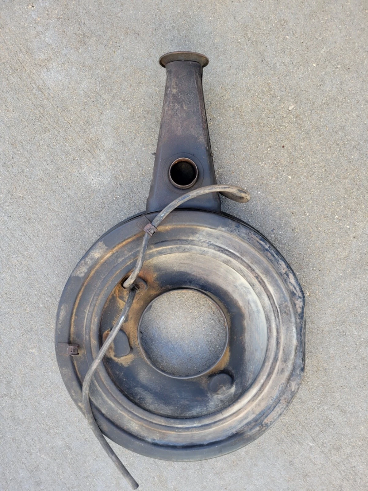

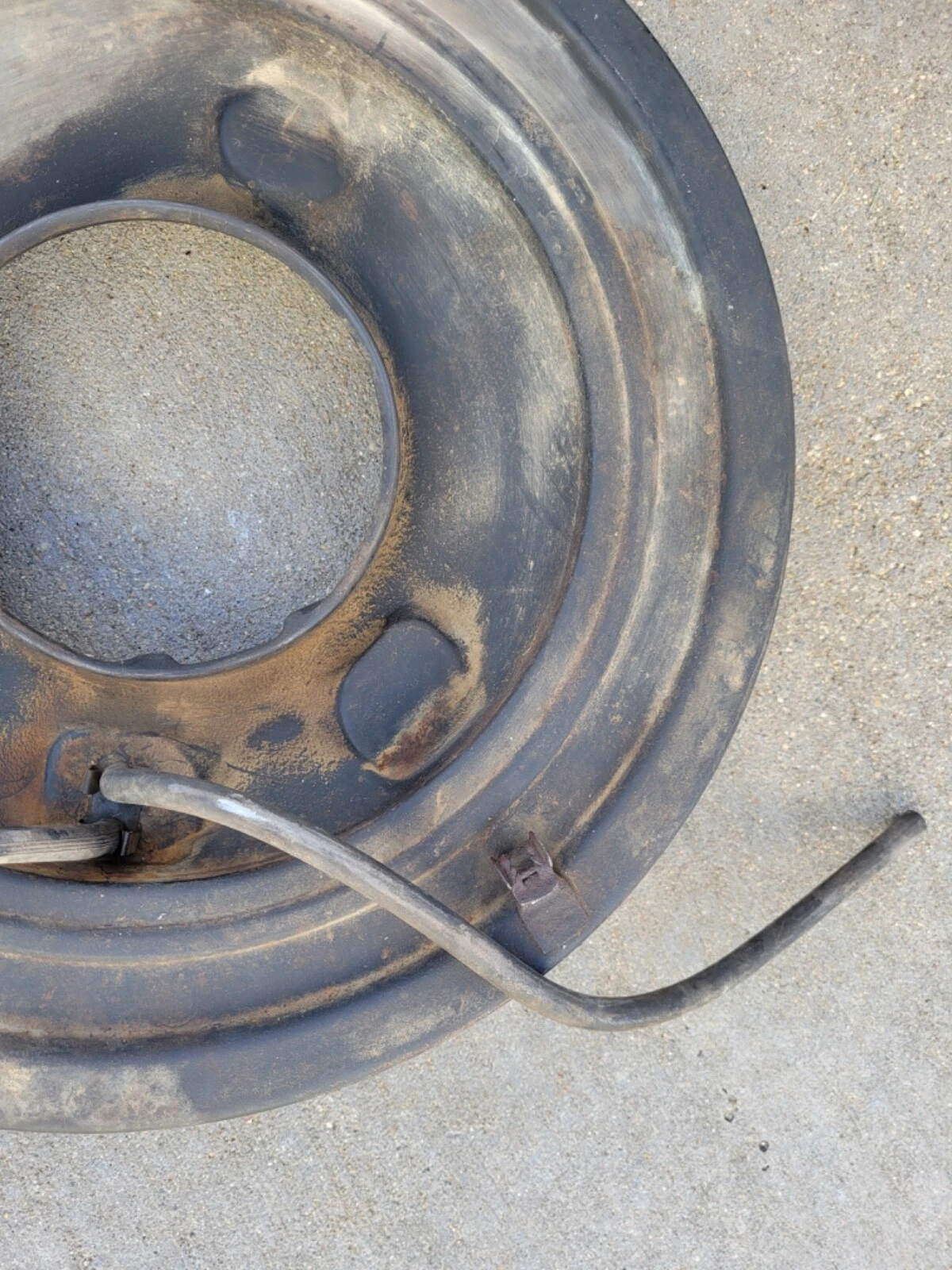

Original air cleaner has a hose connector on top on the diaphragm at the front of the air cleaner which the stove pipe that comes up from the driver exhaust manifold connects to. Under the air cleaner are two ports and a hose holder. Nothing connected, but what is supposed to be here and where does it route and connect? Here are some pics. What hoses should be in place, how should they rout, where should they connect.

Here is an original air cleaner.
Perfect! Where exactly does the hose connect to manifold vacuum? Reason I ask is there is a port on the side of my carburetor that is capped and currently unused.

Note the white stripe vacuum hose going to the carb. The port that hose connects to is on the passengers side of the carb in the middle of the choke linkage.
Like this

Looks correct.
