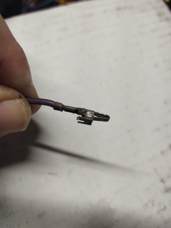

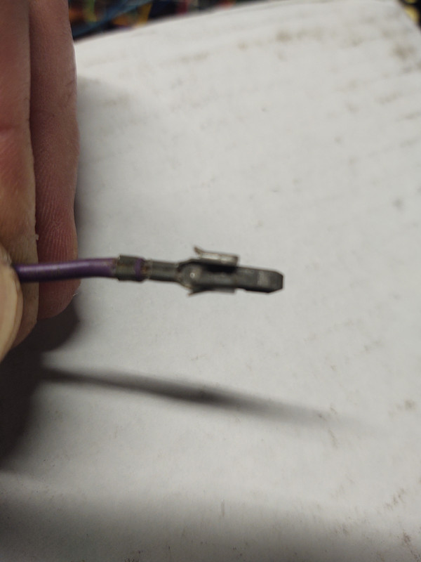

I'm working on a non-tilt auto column and have a new switch that has the half round connector. Was really just trying to figure out how to depin the connector(if necessary) and had this saved for refence but sadly the 'lots of pictures' are gone.
On each side of the metal connector you’ll see a little ear that flares out. You need to push them in and then you can pull the connector out by the wire. The best I could do with the pictures but it should give you an idea.

Thanks for the pictures, I just walked in from looking at it again. I actually figured out how to get the cups off the column so I could get the plug in without de-pinning.
