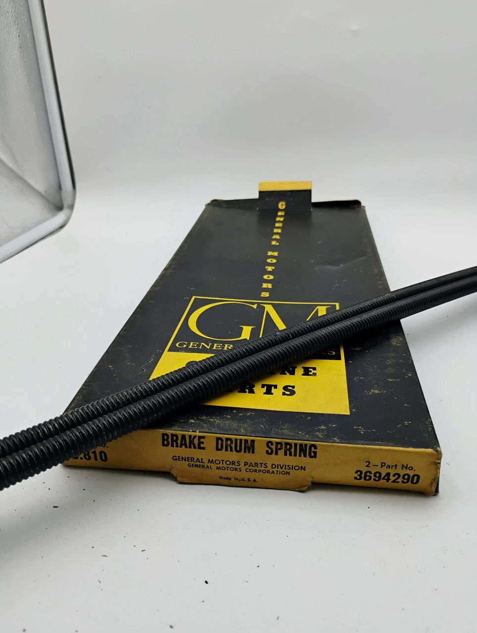

There is an anti-chatter spring on the outer circumference that was originally installed on them to reduce noise.
Spring is GM 3694290
32 3/4" free length
