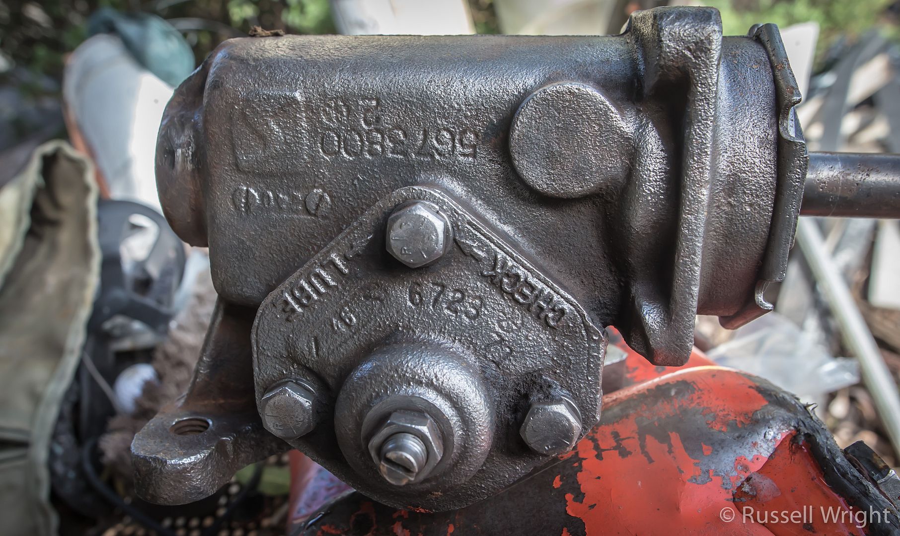

G'day all. I have a manual steering box from my factory '67 right-hand drive C10, and am trying to find out what else it came on. Google doesn't seem to give me much.
I'd like to eventually upgrade to power steering, but need to know what other vehicles this box came on, so I know where to look for a proper fitting power steering option.
Part # is 5673800

G'day all!
OK, so after a bit more searching; and almost zero discovery, I've come to the conclusion that there is no power steering box replacement.
I've looked at a few South African brochures for the C10, as well as an Australian brochure - and it appears these RHD export trucks were only available with manual steering. There wasn't a power steering option at all, so it's a good guess that GM/Saginaw never actually made a power steering box for these trucks during this era.
I have however given my manual box a clean and discovered a bunch of numbers I didn't even know were there (that's how thick the rust and gunk build up was).
Can anyone shed some light on these numbers? Would love to know what they mean.
Cheers,
Russ
You can click on the first image to get a higher-res if desired.

Are those A-Arms in the picture of the front end?
Sorry I can't help with numbers.
I would hazard a guess at part numbers?
Cheers
Nim

Would still like to know what the numbers on the box's plate mean. I'm assuming they're on date codes etc, but still has me curious.
