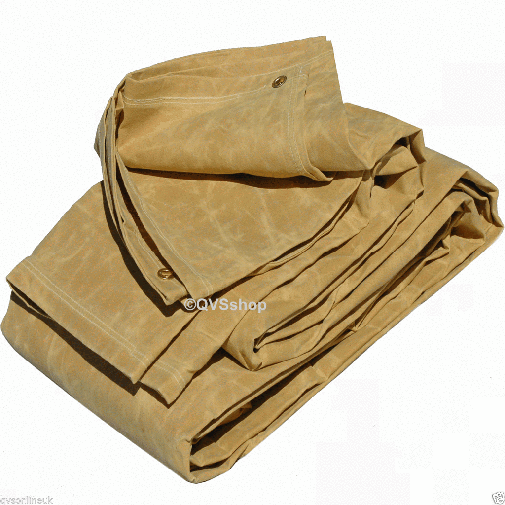

Just ordered my military canvas for the rear bed.
Should be fun fitting and cutting it

Mike,
Have you thought of how to attach the canvas?
Mine had some sash window rope sewn into one end and that then slid into a slotted, fixed C shaped groove.
You can buy DIY brass tent/groundsheet eyelets from Camping International or online to create a row of eyes to thread some rope through and then fix to hooks around the edge, unless you are able to create some kind of framework.
I like this sort of modding as its off the normal pace.

Hi Grizz,
Well one of two ways - Im either going to put one bungy along each length of the canvas (I will add a few eyelets in to help secure/tension it) and the use simple riveted hooks on the body work or use a bungy ball on each eyelet - and again with the hooks
Once I get it I will have a look and see what is A) Most practical B) What is in keeping with the patina look C) What isnt going to be a huge job that never gets finished before the winter.
