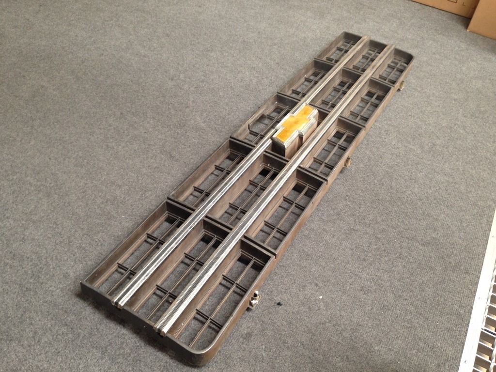

That grille looks GREAT. I am still looking without any luck for a 75/76 grille in condition like that. Forum members are simply the best resource.
I bought a 75/76 that was in this condition and the seller shipped it wrapped in paper and tape! Arrived in more than 1 piece. Very disappointing. I got my money back but it was sad to see a nice piece just destroyed by improper planning and execution.

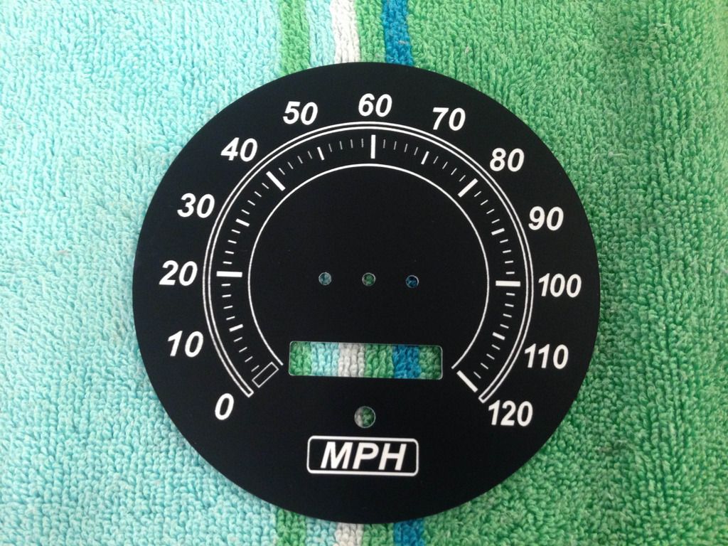

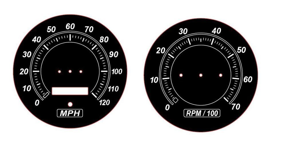

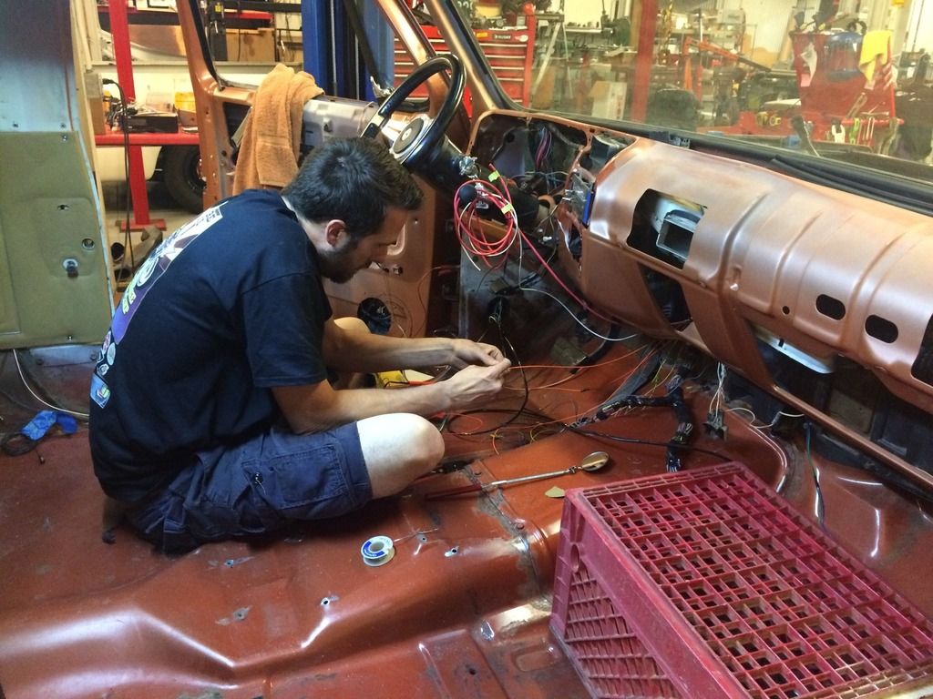

I believe I mentioned that with the E38 ECM I needed an electronic speedo. That's not a big deal and then I tested my Tach and that didn't work either. So, rather than try and find originals that work, or plop down for reproductions, I decided to stick with my method of burying Autometer gauges inside the stock housing. The fuel wasn't too bad as the scale stayed the same, however both the tach and the speedo scale are completely different on the new gauges. So, I used Adobe Illustrator to design these new faces after scanning in the old ones.
They should fit in the 4" bezel and also work with the smaller needle of he 3 5/8 gauge. I think using the smaller needle will keep it looking closer to original. Plus the smaller gauges were considerably cheaper than the big boys.
After that I laser cut them out on my Universal Laser X2 660 CO2 cutter. Turned out really nice. Product I'm using is Rowmark Lasermax microsufaced plastic.
Next step is to get the original gauge face cut to accept the new digital display and the trip reset button. Then bolt it all together!

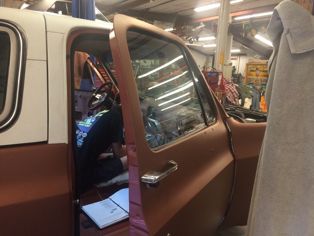

We also got the fuse/relay panel installed last night up front. I threw a couple fuses in for the power windows as well as the power door locks so we could test them. All seems well so now we can finally get the windows put back into the truck. A few items I've still got to button up are the Trinary switch wiring as well as making some new battery cable and grounding the core support. Definitely starting to make some real progress on the wiring now.

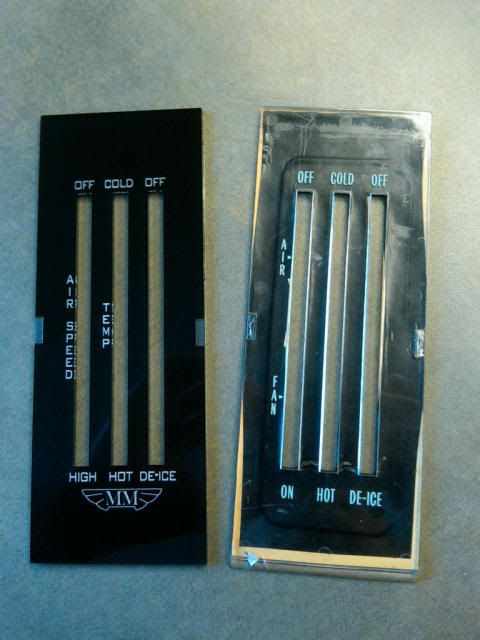

Here is a set that I did for my 69 Camaro. I was just wanting something custom so I put my business logo on them.

I've also made other pieces like this. This is the HVAC Controls off my Camaro. I was going for more of an aeronautics looks. Plus the original was looks haggard.

Got the windows installed yesterday. Need to still final adjust them as the drivers side is kind of going up outside the channel in the rear.

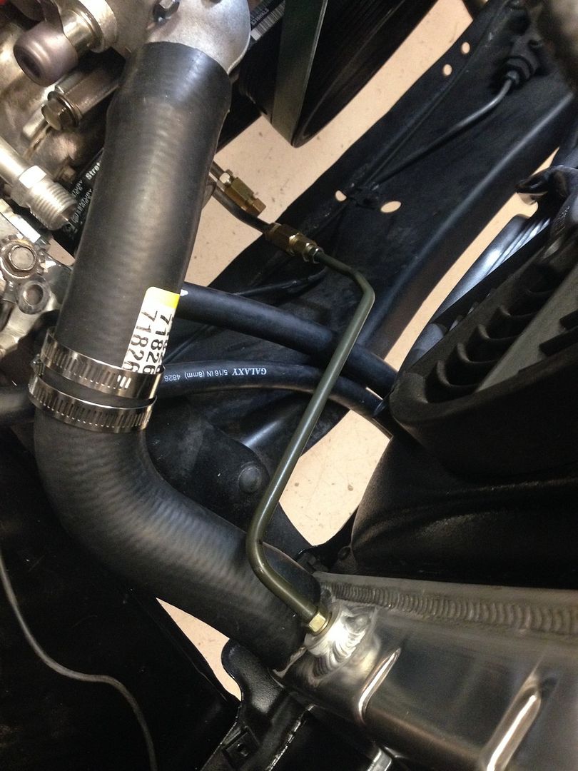

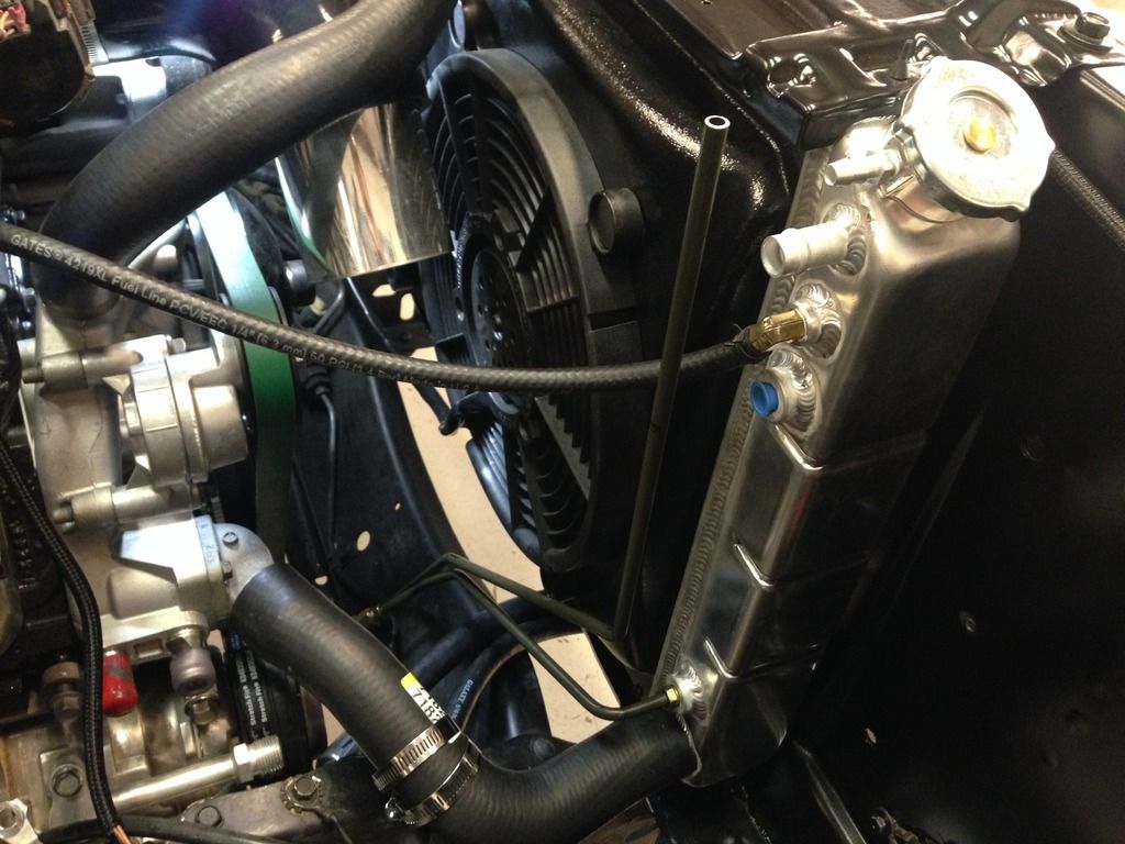

Finally got around to doing the tranny cooler lines. The stock lines are 3/8 and the radiator is 5/16" so I decided to step it down in the middles so I don't have adapters showing right out of the radiator. I've got the lines completely finished now but forgot to take a final pic.
I also picked up this grille. I thought I would like the darker color with the trim but honestly, now that I have both I'm kind of leaning back towards the silver color grille for this application.
