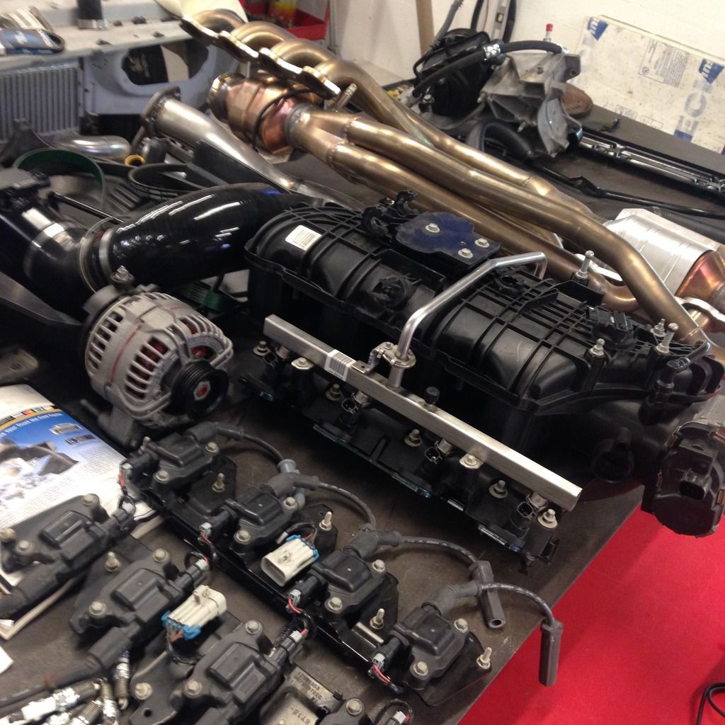

Here are just a few shots I snagged over the weekend. My Dad got pretty much all of the nose put back together.
as well as another buddy and I got the wiring wrapped up. Should be ready to try and fire it up on Wednesday evening. I just need to open up HP Tuners and flash out the Vats as well as change the fueling strategy over from PWM to constant supply.

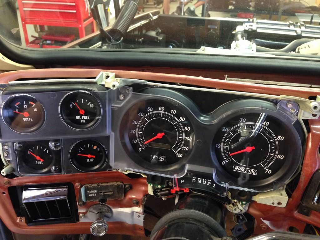

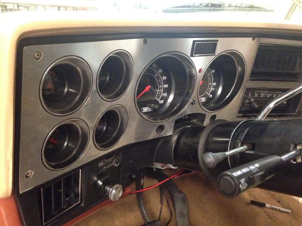

I was able to finish up the gauges yesterday. I know many were wondering what they'd actually look like. And just to circle back. We needed a digital speedo for our VSS signal, as well as our stock tach didn't work. Rather than buy replacements for the stock style we decided to upgrade. These new gauges also allow us to have a trip which is nice.

Those look great. The volt, oil, fuel, and temp look original except for the needles on the bottom two. Who makes the cluster? Are the "small" gauges original or part of the new cluster?

The cluster is stock GM. I basically sliced and diced it up and made new faces for the Speedo and Tach. Then I took the movements out of those aftermarket gauges and put them behind the new faces that I made. I could have used the Auto Meter 5" faces but I really just didn't want it to look like aftermarket gauges. I wanted it to look factory, or maybe a version of factory. These don't immediately jump out at you as an upgrade.
The fuel and temp gauges are Auto Meter movements put behind the stock guage faces (And these are really simple to do. The screws even line up with the stock holes for the faces so it's so easy a cave man could do it... You can see some pics on Page 2 I believe. I had to use a 33-240 ohm gauge to line up with my GM sending unit. Then the Coolant temp came about because I was having way too much trouble finding a sending unit that would work with the stock gauge, and also be able to install in to the LS engine. After way too much research I said "F" it and just ran an auto meter movement and sending unit. To get the needle back on I waited till the engine was 205 (read through the ECU) and then stuck the needle on straight up. I've got a 195 stat so it should hover around this temp most of the time in Phoenix.
