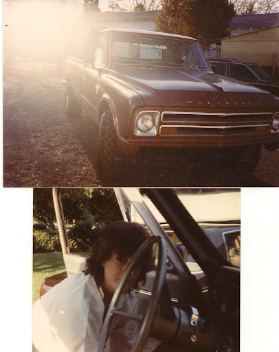

See my old 67 which was all original and was schemed just like your describing....I have an old pic that shows that the door all but the outside skin (as you mentioned) was painted the interior color......My color scheme was: Vermillion Poly Exterior with a white roof and that silver/tan looking color (from the above pic) for the interior....Not sure above the cab side of the door Jamb....int. or ext. color...can't remember?
Any other insight on this subject would be appreciated!
Here is the only two pics I have of my old truck...I was thinking of maybe doing this color scheme on the 70 ??

Hmmm....my old 67 pictured above was a CST....and the buddy buckets upholstery matched the interior color ??
