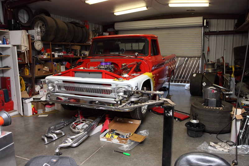

Fortunately things have been busy at work, so about all I've managed to accomplish is getting the headers coated and back here to put on..
They came out really nice. 1-7/8" primaries 38" long, 52" to the back of the slip collector puts the 4" to 3" reducer right at the back of the trans cross member. Plenty of room for the mufflers and turn outs
New plumbing is almost done, changed gear in the centersection to a 4.71 so to not beat up on this motor too much. With a 33" tire it ought to trap 6650 if everything works as 'expected' and was dead on the HP peak on the dyno.
One thing I have managed to accomplish,, I've made a hell of a mess out of the shop!
With Firebird not finished with track repairs there's no race this weekend,, wife is gone to SoCal for a visit, MAYBE I'll make some progress.
If nothing else just clean up this mess!

Your garage is awesome Marv. So much cool stuff all around there. The headers came out great man.

Yep Marv, the headers turned out nice!

that is what I call long tubes

Great truck, I was rootin' for you on PINKS. I have a few questions, your headers are amazing, did you custom build them, if not what is the supplier and $$$ if you don't mind?

65 the headers started life as the Headman Hustler 1-7/8" weld-up kit with the Stal adapter flange,, made it through 2 tubes and I turned it over to a shop that builds custom headers. More time and patients than I was willing to invest. By the time they were coated and bolted on,,,, I bet I have a grand into them including kit, extra tube / j-bends to fix 'my' design, reducer cones, O2 bungs, fab work and coating.
you want the total bottom to top on 'that' motor...... I think it's detailed in one of Supers Engine Analyzer posts, but here goes
436 cu. in, 666HP on a reputable SuperFlo dyno. Not conservative, not exaggerated,, but repeatable.
It began life as a bare GM '509' 400 casting that was missing main caps, but sonic checked with good wall thickness. Had it decked to 9.000, Torque plate bored & honed for a 4.165" bore, clearanced for a 4" stroke, added splayed main caps, and 'hard block' filled to the bottom of the waterpump holes. Spent a STUPID amount of $'s on what is still nothing but a stock casting with a bunch of band-aides wrapped around it. In hindsight,, I should have just started with a Motown or Dart block. but hindsight is always so crystal clear ain't it!
Rotating assembly is a Eagle 4" stroke crank (not by choice, it was just what I had at the time) Lunati 6" ProMod I-beam rods, JE 13cc pistons and JE mo;y ring packs. ATI neutral balance damper and flexplate on each end. As a BTW,, took 3 slugs of mallory to get the assembly in balance.
Heads are just a set of old design box-stock AFR 220 castings. Flat milled them to 68cc is the only thing done to em. Added Crower .40/.10 shaft rockers. Not a lot of tricks,, just titanium retainers Isky springs and the shaft rocker system that would be anything other than 'normal' . AFR may advertise the 220s and 227s "will accept standard rocker systems" but 'accept' and having correct rocker geometry are apparently two different inturpretations of the word 'accept'. IMO the 220s demand a offset rocker and shaft is the only way to go there IMPO.
Cam is a Crower roller E-42834
264° / 276° @ 0.050, .679 .677 lift 108° LSA I put it in on a 104CL again nothing real trick or out of line for a race sbc. In fact this is probably a little small for the big inch sbc.
Intake is a Holley ProDominator tunnel ram with a handfull of epoxy inside to smooth out the transition from upper plenium to runners. Done by a friend of mine I bought the intake from. I'm told it will make it a little more 'throttle responsive' to throttle stop opening. I really wanted to set a matched pair of ]ProSystem 4150s on it,,, but dyno day and time / $'s thing got in the way. A pair of Proform 750 is what I ended up with on dybno day and we spend over 2 hours getting the thing tuned right (friggin PIG pfhat out of the box)
That's it, no real tricks Made 666HP @ 6400 and 588 lb ft of torque @ 4900 usinf VPs C-12 fuel
First trip to the track it wemt 11.0 with a easy launch, rolling into the throttle and 'thought' I was easing into a 11.50 pass. Next pass tried a transbrake launch and exploded an axle. Have all that fixed and finished up and am adding a QuickData data logger and hope to be back on the track first ADRA race that is coming here January 8th.

Wow very nice, 666hp that's a devils small block. Thanks for the insight, sounds like you've been drag racing awhile. I'm hoping to get out for the first time this year, been waiting half a life time to play. The $$$ sure flies out the window, still got the family to think about. But we'll get there.
Post up some times in the New Year sounds like your headed for the low 10's, maybe 9's??? knock on wood. Thanks for the great reply, and those were the covers I asked about, they look great. Mike

Mike that motor took my 2700 pound Nova to high 9's (it was the backup motor for the Nova and has been sitting on the stand for 2 years) At 3450 and an efficient setup it would easily make mid 10s in the truck. BUT,, the truck roll bar cage wasn't built with NHRA rule book in mind and isn't legal for anyting under 11.50. So it's a throttle stop baby and will be dialed to 11.75 and no firesuit, no neck collar no 2layer gloves or any of the other BS the Nova and low 9s require... it's my 'summer' time racer for here in hell.. errr umm Arizona. :-) When all the heavy suit is comfortable, (winter) I'll play with the quicker toys.

Hey Marv, I've been trying to find 1 3/4" tubes for my truck, no luck. Before you built those beautiful headers, what did you run on the truck??? Hope you can help I don't want to build my own yet. Thanks Mike

I had a set of off the shelf 1-5/8" supercomps for a 70's Nova. Had to relieve the top frame rail in a couple of places to make them clear. But the clearance issue is worse with a head like the AFR's that raise the exhaust port almost 3/8" They worked fine for the (considerably less than) 500HP 383 that was in there.
Anything larger than a 1- 3/4 primary is going to have to have the Stal adapters i believe. Wait I take that Back, we just put a set of 1-7/8" Headman Hustlers on my buddy's 74 Nova with Brodie heads and they were a standard pattern, not a Stal or Stal adapter like this kit is. I personally don't know of anything short of build you own that will work.
Trust me,, I learned QUICKLY that the build your own is an ART for those that have the knowledge and equipment. Even with the equipment it's a hell of a chore!

Thanks Marv, Slooter from Eastern Canada says he used 1 3/4" for a '68 Chevy PU, same frame??? Another guy recommended Schoenfeld Headers, I'll call them no email contact unfortunately. Thanks for the info, wish me luck.

And speaking of headers and this project,, will get back on it this weekend I hope.
Been having major issues with the back again and am just waiting for the insurance and surgeon to get it to gether for surgery #3, so things have moved slow the last few months.
Pulled things back apart a little to put the Innovate wideband O2 sensors in each collector, and to weld in a EGT bung in #1 and #2 primary right near the flange. And have a new Edelbrock QuickData logger mounted and "almost' wired up.... and all most ready to go back to the track to attempt to find the next weakest link! LOL
I've had to park the Nova till I can get past the NHRA physical and even if Doc passed me today,, I aint racing till I can do it without a a healthy dose of pain pills to get me through the day. So the racing and finishing this truck has been a less than front burner deal at best.
