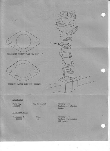

1963 Service Bulletins
The first page is in color of the original, I grayscaled the rest for us older guys to read.
