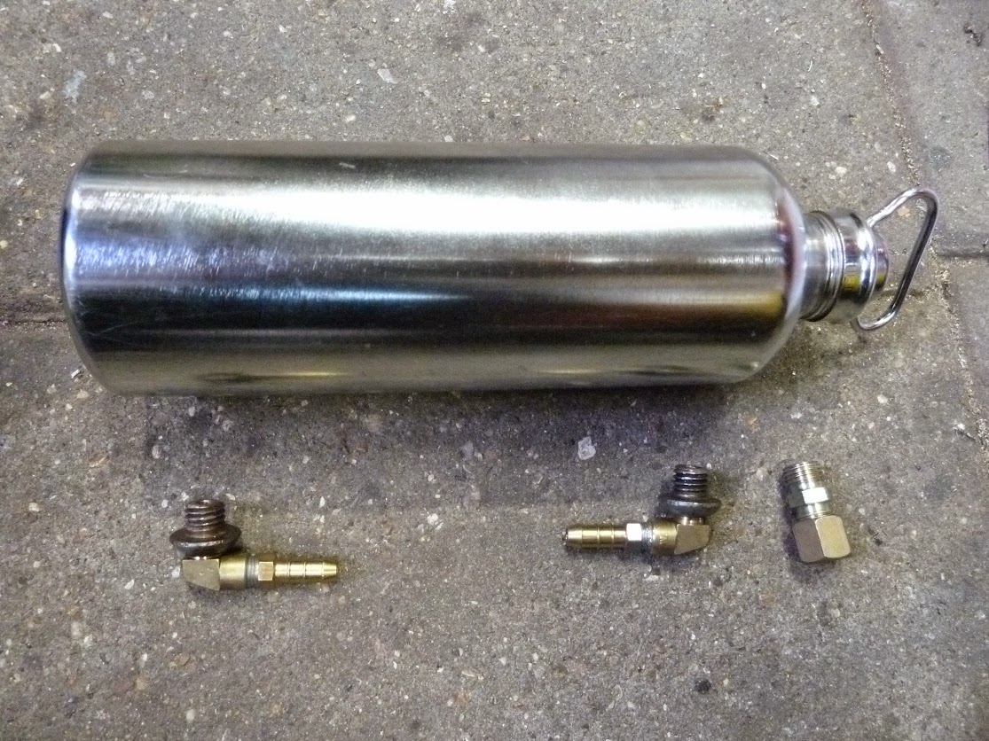

After a few days of nothing due to physical discomforts ( I have a sort of braindamage that get me into hard muscle pain after load of muscles), I tried to make a radiator overflow bottle out of a bottle normally used to warm babies
Drilled two holes for hose pilars so you can see the content. Welding didn't work because it's so thin, you burn a hole in it as soon the flame hits the surface. So I soldered it...
Have yet to make a pipe that goes to the bottom of the bottles that connects to the overflow of the radiator, but I didn't have the pipe....
I also made a little bracket for the prop valve that I will use when changing the axles and brakes, all in rough shape. I will make it all properly
Tomorrow I will try to go to the truck again, fix some small things before I will rewire it.
