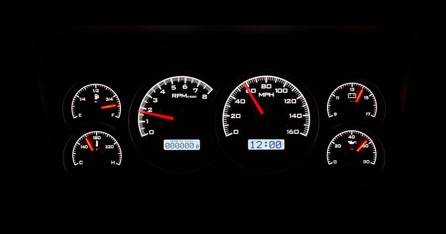

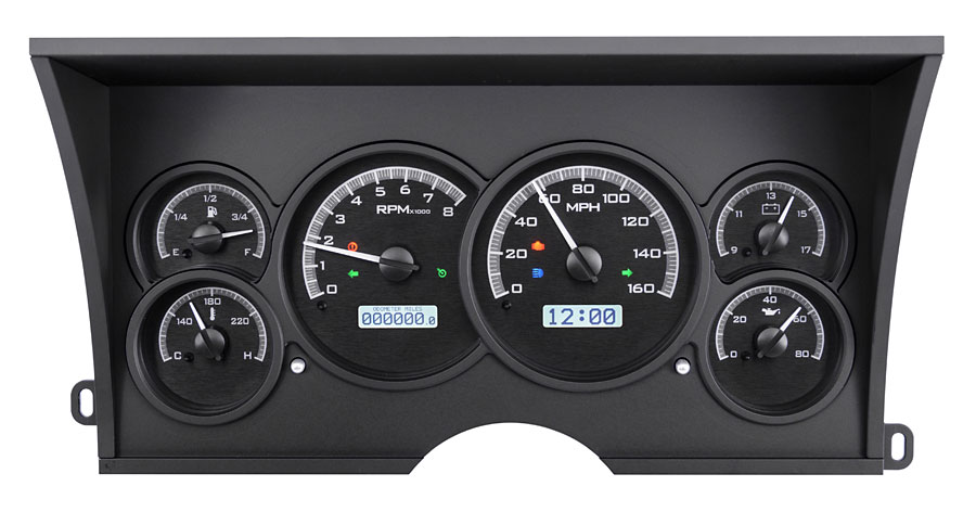

Some small updates. Got the front suspension torn off the truck, and getting ready to put all new control arms on. Also at this time, we will do the new Street Edge drop springs, BellTech sway bar and McGaughys shocks. While at it, we are going to replace all steering components, including the steering box. It had some play, and want the truck to drive extremely well. We will explore the R&P idea, but for now, this will get us on the road.
It was actually cheaper to buy brand new arms, than get bushings and ball joints and have them replaced. It was surprising to me this was the case. We cleaned up the frame a little. It will be a driver, so it is not perfect, but does look a little better. Did a sating black, but looks gloss since I took this picture when it was wet still. The new Dakota gauges also showed up, but have a while until we get to that install. ![]() ![]()
