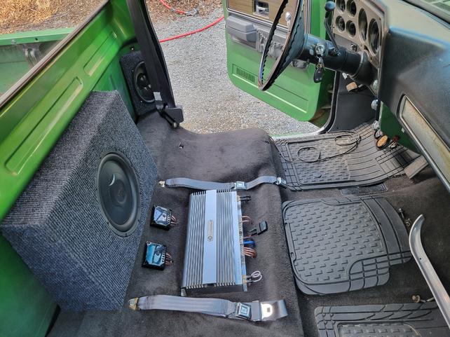

Almost finished the stereo install.

Where did you order your carpet kit from and were you pleased with fitment and overall quality? Your truck is looking good!

I ordered the carpet from RockAuto, was the best price I could find.
ACC. 19396162.
Fit was very good, little bit of trimming near the doors that's it. Nice thick backing on it.

Pulled up the carpet again to clean up my stereo wiring. Had a bad alternator whine that followed the rpm, removed a way to long RCA with a couple short pieces, and cleaned the ground. All good and quiet now.
